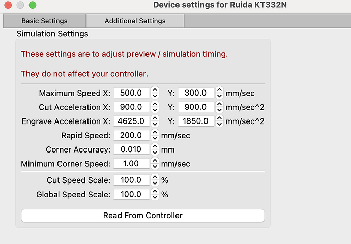

Hi,
I’m new on this forum and need help :grin:.
Eveything was under control but since I upgraded to the new version I have some isues with lightburn.
When I control the laser from lightburn there is a delay beetween the command and the movement. Like if computer was loading.
Otherwise I can’t changed the distance when I use “continuous jog”. I used to set on 10 cm but now laser head go thru all the bed.
My computer is very clean and memory is OK. All other apps still run very fast.
Any idea ?
Thanks
Any ideas ? :pray:
Hello Tahon
A couple of screenshots, please.
a) Edit > Device settings
b) Move panel
Hello.
Hope it will help :wink:
Everything seems correct
What speed does machine job if you use the Pad at the machine itself?
It’s very speed with the pad.
I only have slowness with lightburn. To preview the work or to transmit a command to the laser. It seems that other functions are OK.
Don´t know if this impact somehow
You´re decimal symbol is a point or a comma?
e.g. if I input 10,00 on mine it becomes 1000.
