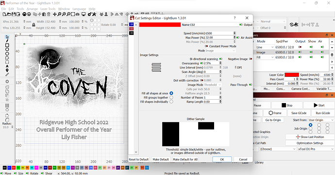

I have a xTool D1 Pro 20w and recently did a 10 x 10 canvas using the Norton white tile painted black method in imag-r. Lightburn estimated 1hour 37 minutes and it was just about spot on.

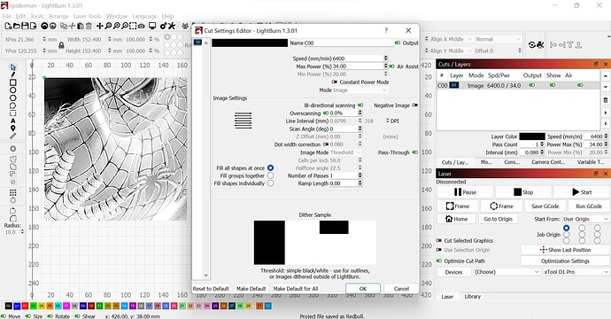

I am now doing 6 x 6 ceramic tiles using exact same settings in imag-r. Norton white tile painted black, 318dpi cropped to 6.1 in x 6.1 in. Depending on the image (5 different images) Lightburn estimates 40 - 65 minutes. However, the burn time took 4 - 6 HOURS each. The laser speed is nowhere near what I have set at 6400 - 6500 mm/min

The “Coven settings” is my 10x10 canvas settings. Lightburn said 1hr 37 minutes - took about 1hr 40 min
The “Spiderman settings” is one of the 6x6 tile settings. Lightburn said 45:21 and it took about 5 1/2 hours
