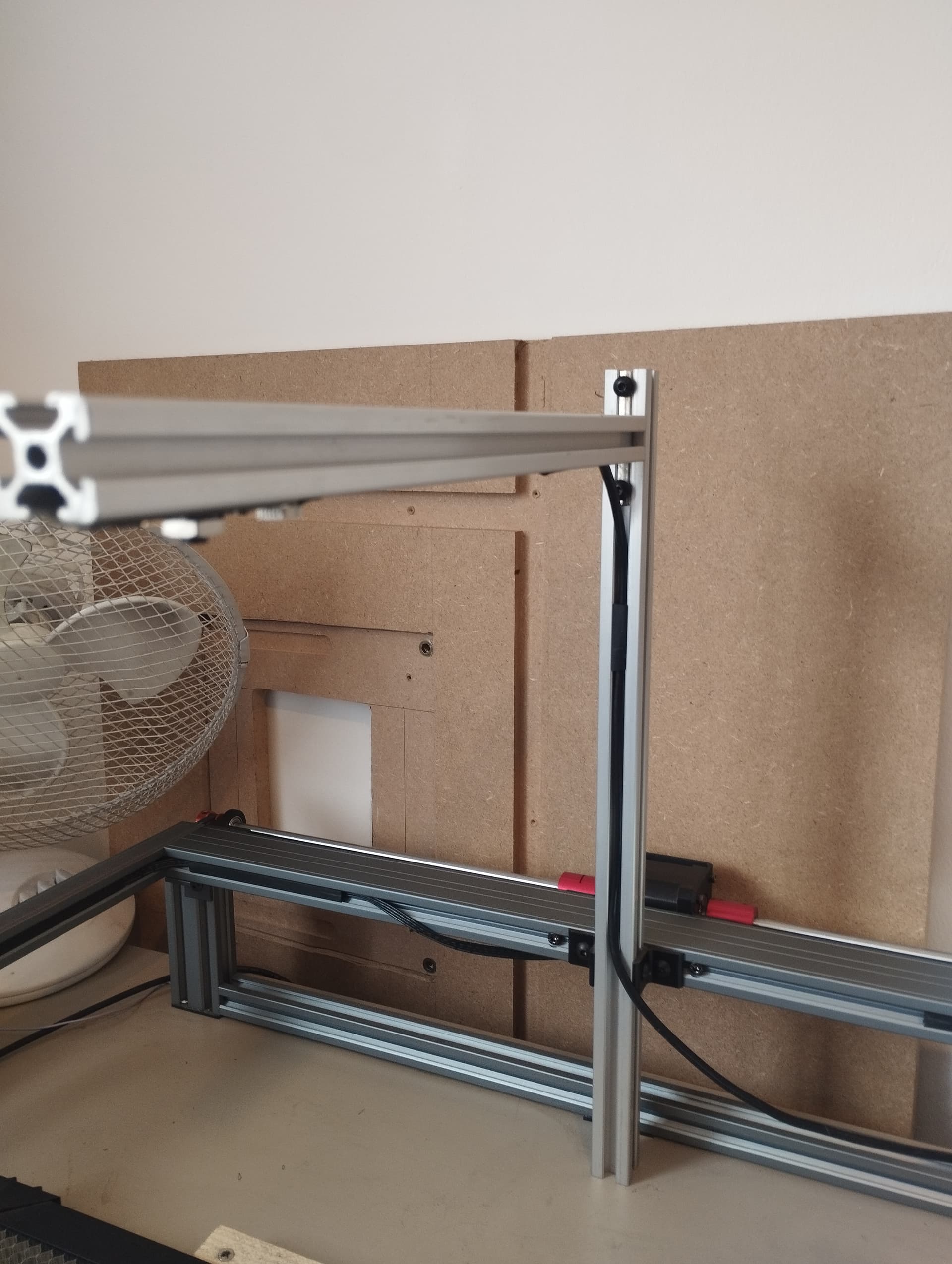

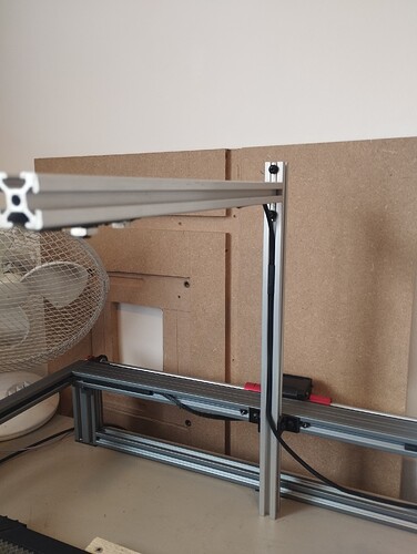

I am often asked how I assembled my camera, I dismantled my enclosure (manufacturing secret!).

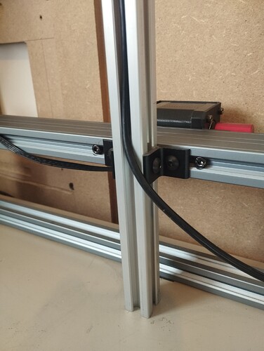

Connected with a 15x15 V slot profile, and 4 brackets for profile.
The whole thing cost me 20 euros including shipping

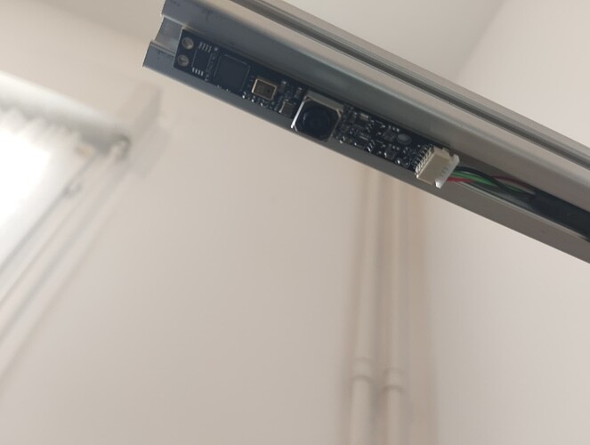

Chinese camera, 8MP FOV 120° autofocus at cheap but at the top!
