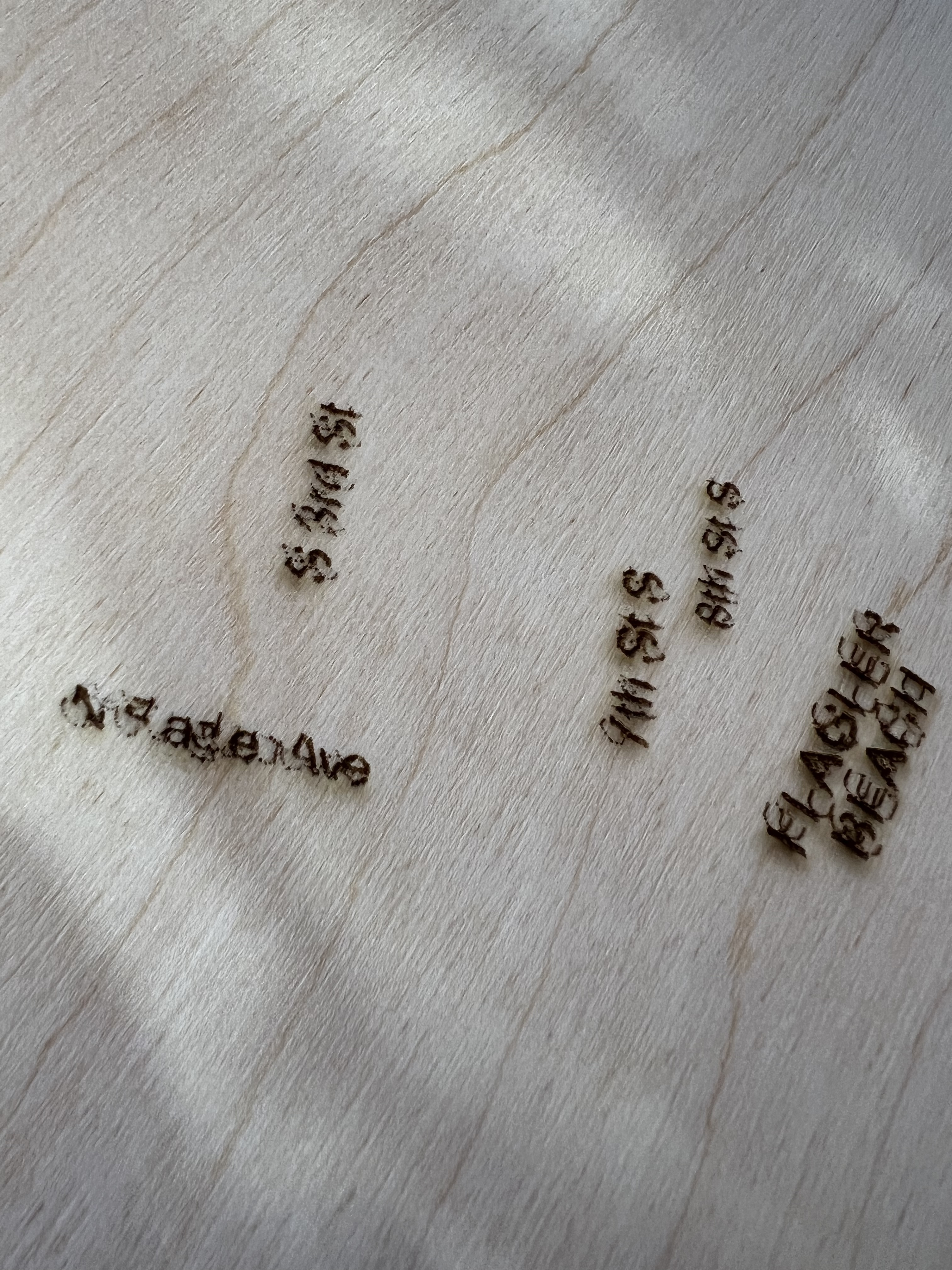

Hey all! Trying to do some small lettering and it’s not going well. Have tried line & fill and it doesn’t seem to matter. The smaller the lettering the worse it gets. The font isn’t the issue so I’m at a loss……thoughts?
Optlaser 15w w/air assist on BB
It looks like horrific mechanical backlash, so doing a comprehensive review of all the possibilities is in order. Although this isn’t specifically about your machine, you’ll recognize the bits & pieces, so start at this heading and read downward, checking as you go:
Pretty nearly everybody starts by accusing the software & settings, then solves the problem by meticulous attention to mechanical details. :grin:
