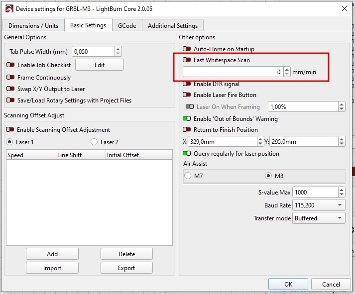

If with “I stop it immediately to prevent damage,” you mean you press the “Stop” button in the “Laser” window, then alarm 3 is normal. This always happens because the “Stop” button is interpreted as an emergency, stopping the machine immediately without guaranteeing its position.
In version 2.0.05 I believe it’s here.
In this seat I only have one controller board connected (without a machine) just for demonstrations like this.
GRBL has parameters for setting the maximum acceleration rate, but your maximum speed could be too high as well. Before changing ANYTHING, save a copy of the settings using the Machine Settings window.
So we can examine your settings, enter $$ in the Console window. Copy / paste everything after the $$ in a Reply.
