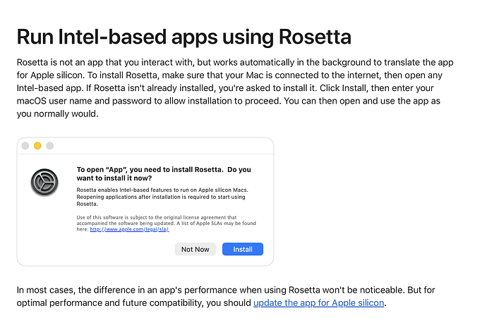

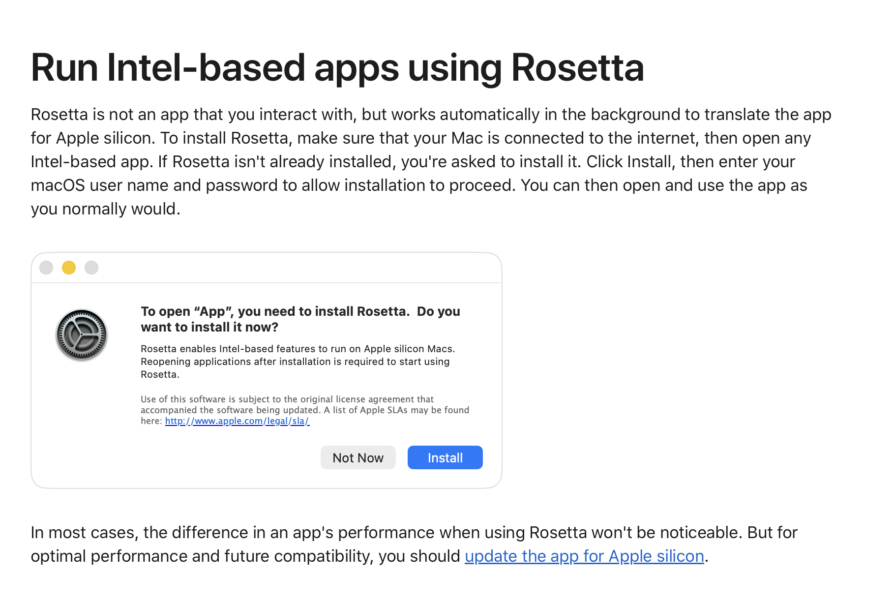

LightBurn will take up to a few minutes to do the initial launch when installing new versions as Rosetta performs the necessary file translations to run on Apple Silicon - read more here: macOS Compatibility Update – LightBurn Software
We have Apple Silicon-native versions of LightBurn currently in testing, and will be releasing those to the public once they have been proven. This will eliminate the first-start translation delay, as well as the message you see.
