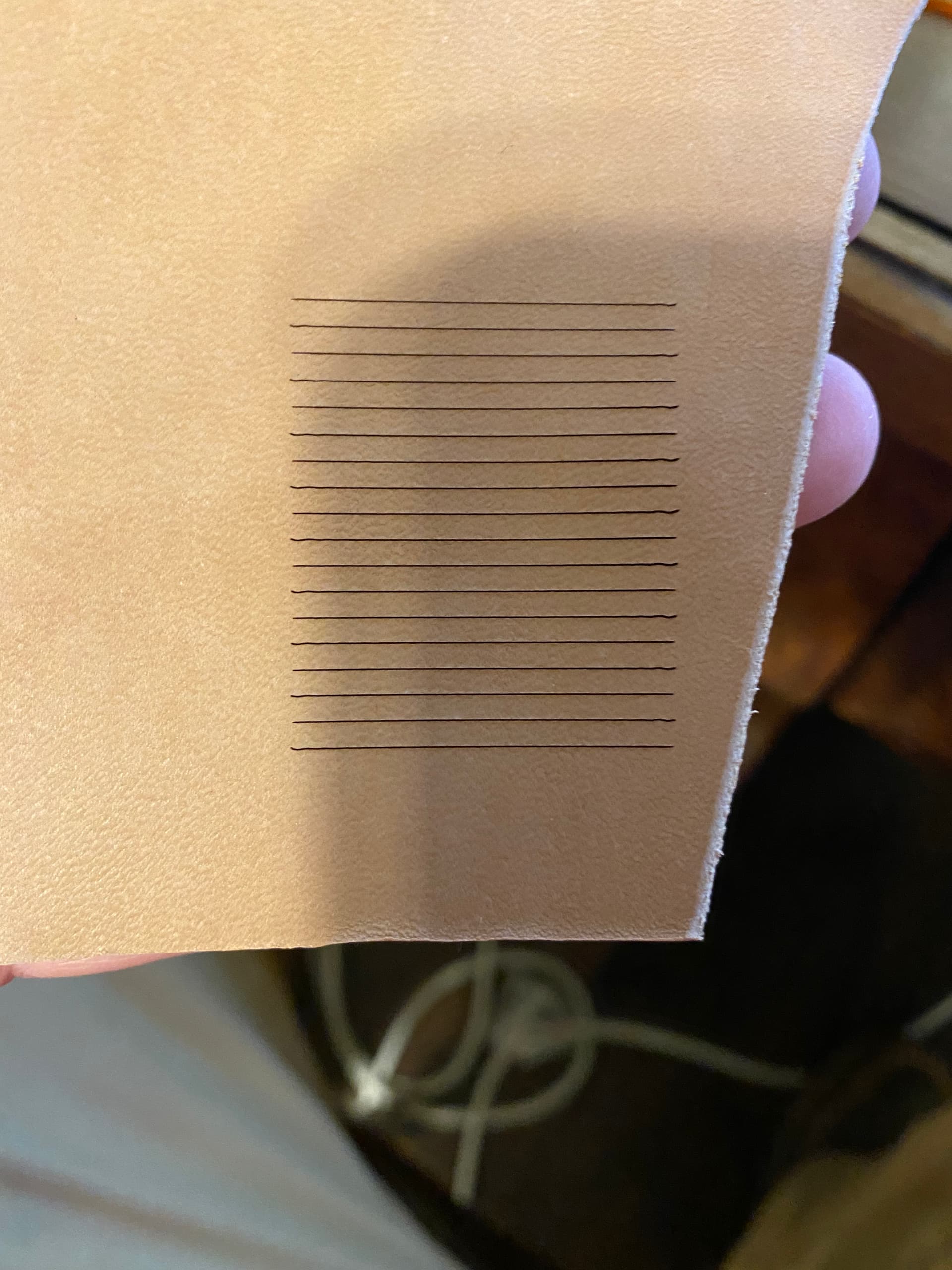

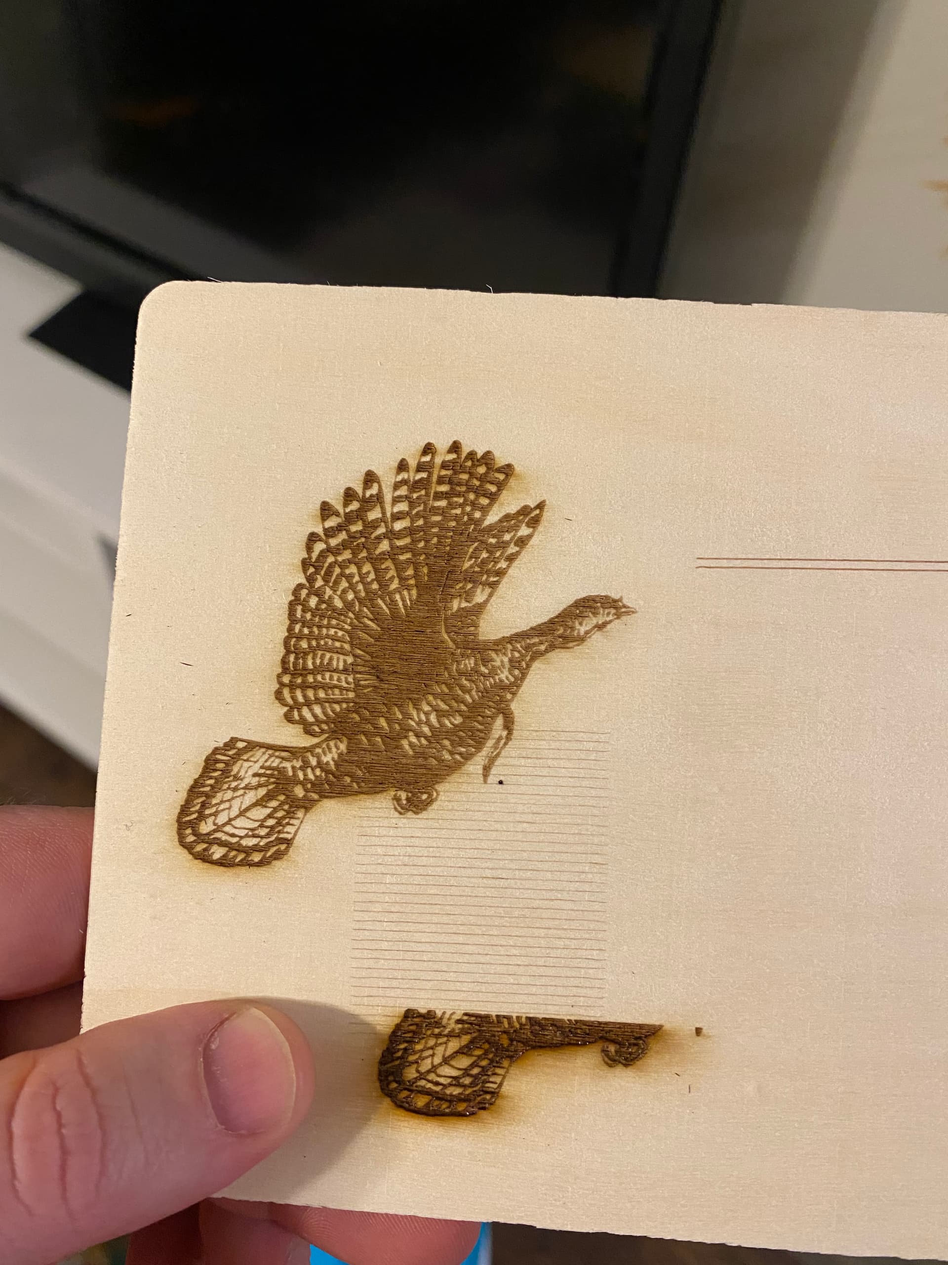

Software settings or laser?
By the way, just noticed that it looks like you ran the test on leather. No need to use an expensive material for the tests. Something like cardboard would be fine.
Tightening the belts and rollers helped drastically.
Still a little bit I assume is acceptable?
I had a pice laying around so I figured I’d use it because it’s what I’ll mostly be using.
I don’t want to over tighten. Would you think a little more may help?
I’d like to see it just a little better but much improved. This could also be remedied with slower speeds. Try snugging up just a bit more especially if there’s noticeable play. Back off later if you see other artifacts.
There’s just the slightest amount of offset if I’m looking at it correctly but fixing that will get you the rest of the way there.

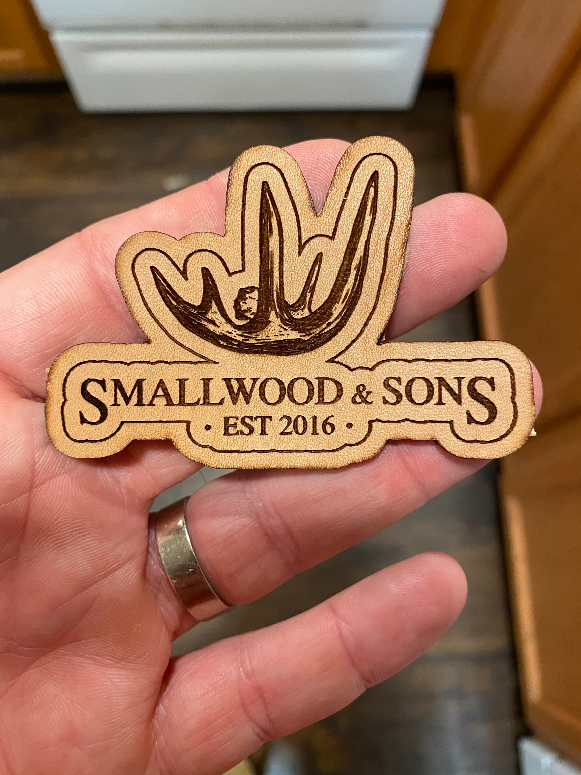

Y’all have been great! Machine is doing great. Much better!! Thank you all for helping me!
Nice! That is a dramatic improvement. I encourage to experiment with some of the other cut settings including cross-hatch. Will give you a different look.
