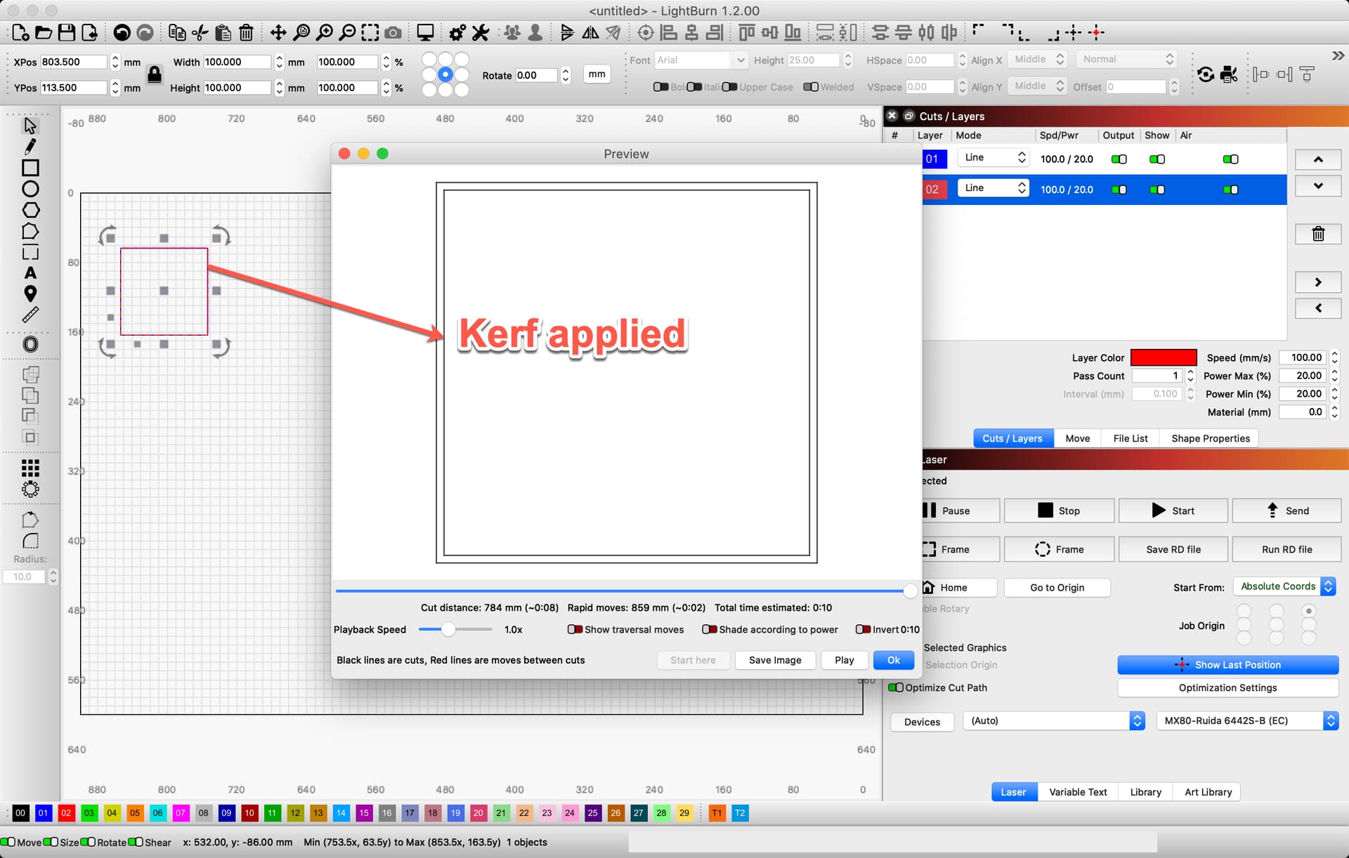

I show the ‘Two-square’ test below and the resulting ‘Preview’. Please show us a similar test and the results you are observing.
