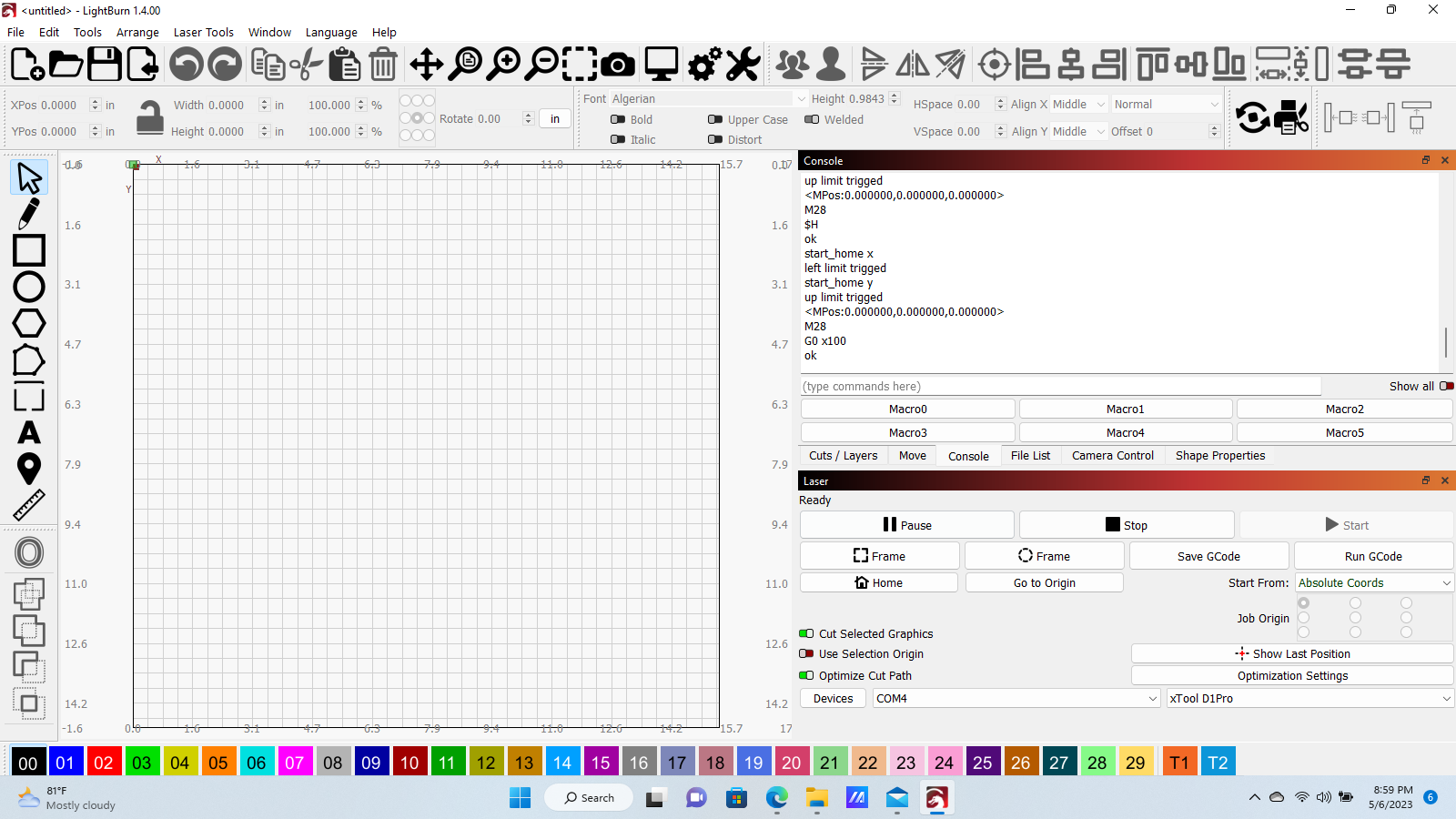

It will run a program fine, but won’t jog? That… kinda doesn’t make sense. In the console window, try typing $H (note the capital H), followed by G0 X100. Afterwards, try the jog buttons again.

Send the two lines separately. $H should make it home, then G0 X100 will jog to X100.

didnt move.

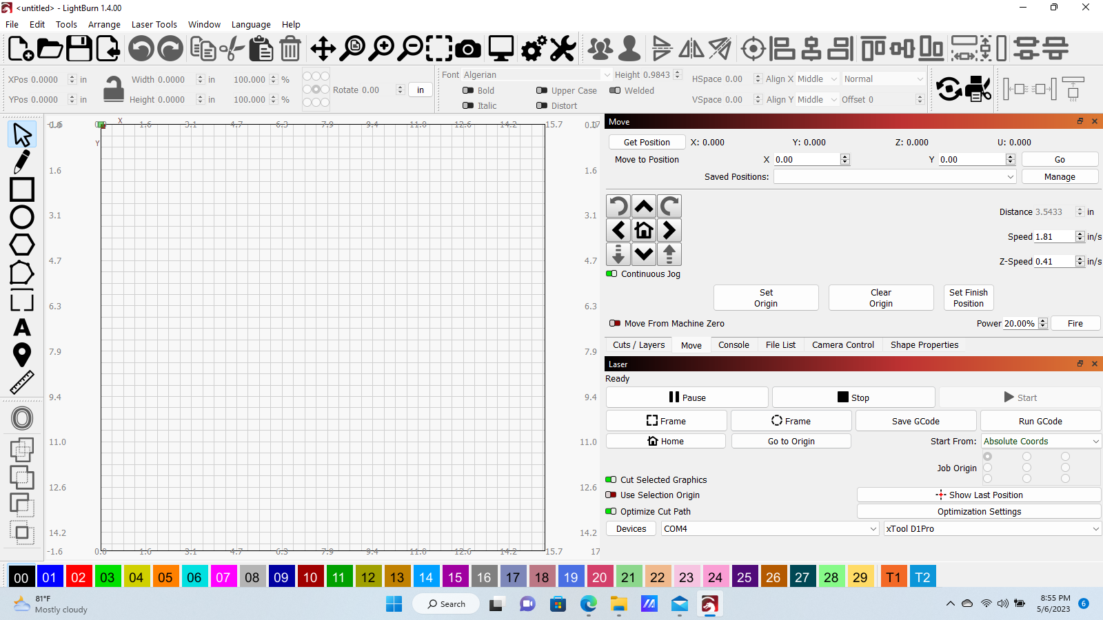

Check Move window settings.
What is your distance setting and speed setting? If they are unusually low then jogging may not appear to be working.
Can you take a screenshot?

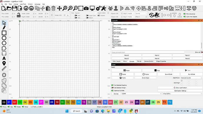

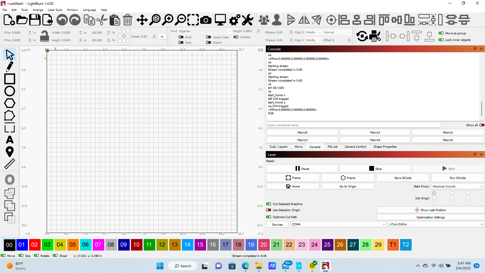

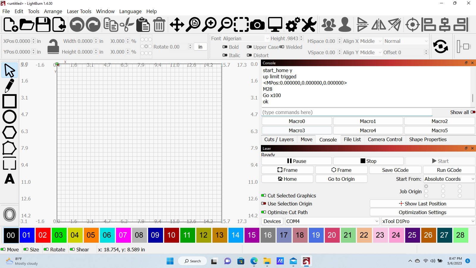

It looks like you issued a ‘Go’ instead of a ‘G0’. It should be letter-G and numeric-0.
same result
