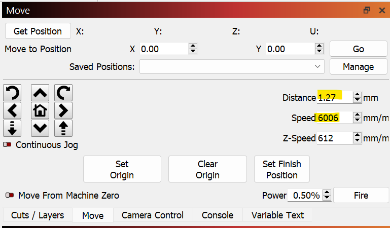

This is assuming you have the D1 Pro as listed in the screenshot above. I can assure you that Lightburn can fully control the XTool D1 Pro, as I happen to use it solely to control all of my lasers, including the D1. When you select the COM port for the XTool in Lightburn, it should read as ready above the control buttons. What output do you get in the Console tab when attempting to connect or jog?
The Laser Head should move or Jog when the xTool D1 is connected and the arrow keys are used. Both the Shift and the Ctrl Key change the amount of Jogging.
It’s also possible that xTool has early or different firmware that offers different Jog behavior. I saw some similarly strong posts from last year (and earlier) so I’m leaning toward that.
If you’d be so kind to capture the initial connection message between the xTool and your computer. It’ll be in the Console window in LightBurn. It’ll tell us what day the code was written and we can confirm that it’s current.
Which keys are you using for Jog or Move?
This may be worth review:
On the right hand side of the Console window in LightBurn there is a switch that says ‘Show all’. When that is selected, the full conversation between LightBurn and the xTool should be visible. It’s a little bit verbose, but we’re likely to see something.
If the distance in the Move window is unusually small, it may be hard to detect.
I like 10mm or 0.5 inch at a minimum.
The speed (and units of speed) in the Move window can be 2000 mm/min which is a little slow for a good machine but it’s easy to see and confirm.

Don’t overlook @johnjohn’s suggestion to review Move window jog settings. There’s a very strong chance that this is the reason why jogging doesn’t appear to be working.
Either distance or speed may be set unusually low.
