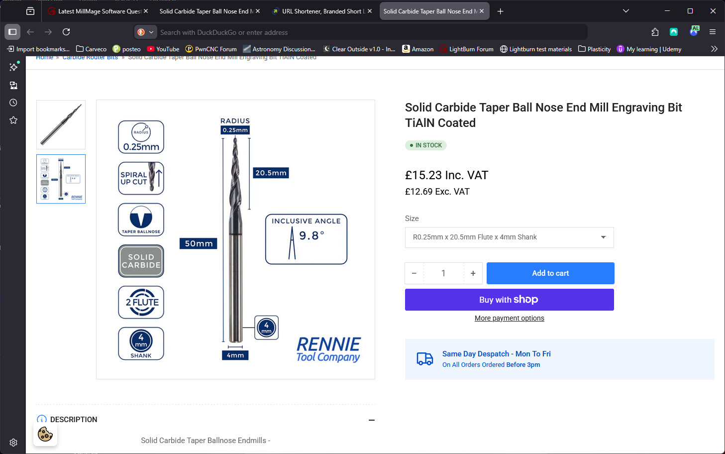

I see this type of question was asked previously but did not see the complete solution. Is it possible to enter such a taper ball nose bit and have the included angle accounted for in the software? I use several of these bits when cutting reliefs and wondered if this was possible in MillMage. This is only my third full day of the trial so please exuse me if this has been answered more fully elsewhere.

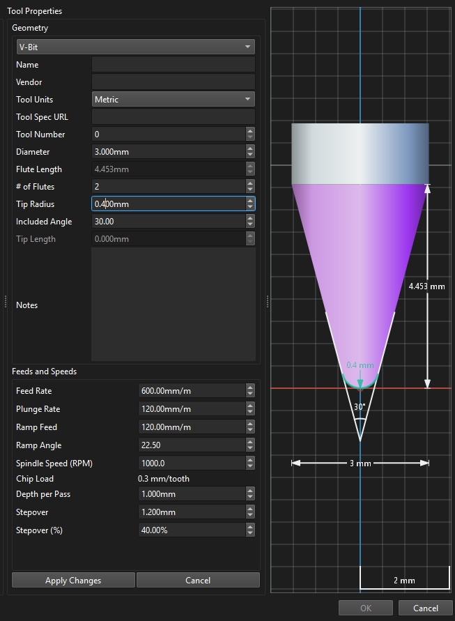

hi @jepho ,
I believe if you create a V-Bit you can then insert a tip radius on it to mimic the geometry you’d like to have:
