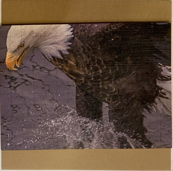

Yes a photo layer that is of commercial grade paper. The photo adds substantially to the amount of power needed to cut through. Best setting for my laser, 60W/50W Omtech, 2.5" lens, Speed 20mm/sec, Power Max and Min 35%, one pass, Air Assist boosted to 30psi, 10mA - 11mA. Photo down. I apply two applications of photo preservation rattle can and two applications of spray water based poly on the photo. I have no smoke on either side. No char falling from the edges, kerf is tight on the photo side but I don’t think it is too tight. Top bare side kerf .35mm - .40mm.
Photo is a portion of a puzzle cut with the above settings.

Actually set the focus 12.3mm above photo on 3mm birch plywood. Notice I now have photo on top. The burn was good with little to no residue on photo or underside. Kerf on photo side is .23mm. I had some funky spots on bottom that were easily sanded clean. Slowed speed to 12.5mm/sec with power at 35%.
Changed back to stainless steel mesh with weight applied where and when needed to keep ply flat. Best results so far.
Sprayed black heat resistant paint on my other mesh. If that doesn’t cause another problem I am thinking it may get rid of the small amount of flashback.
I have always done the perimeter cut last and the longest other cut first. Changed to perimeter first. Good results.
BTW: Kerf on the bottom is between.30mm and .40mm

Are you actually able to measure the kerf?
Digital micrometers
Finished puzzle. You can see how close the kerf is.
Looks like commercial quality… very nice…
Agree, looks awesome. Regarding warping/cost factor - even if you can find a similar density paper to the photo paper but of a cheaper variety to glue to the back it may help considerably with the warping.
