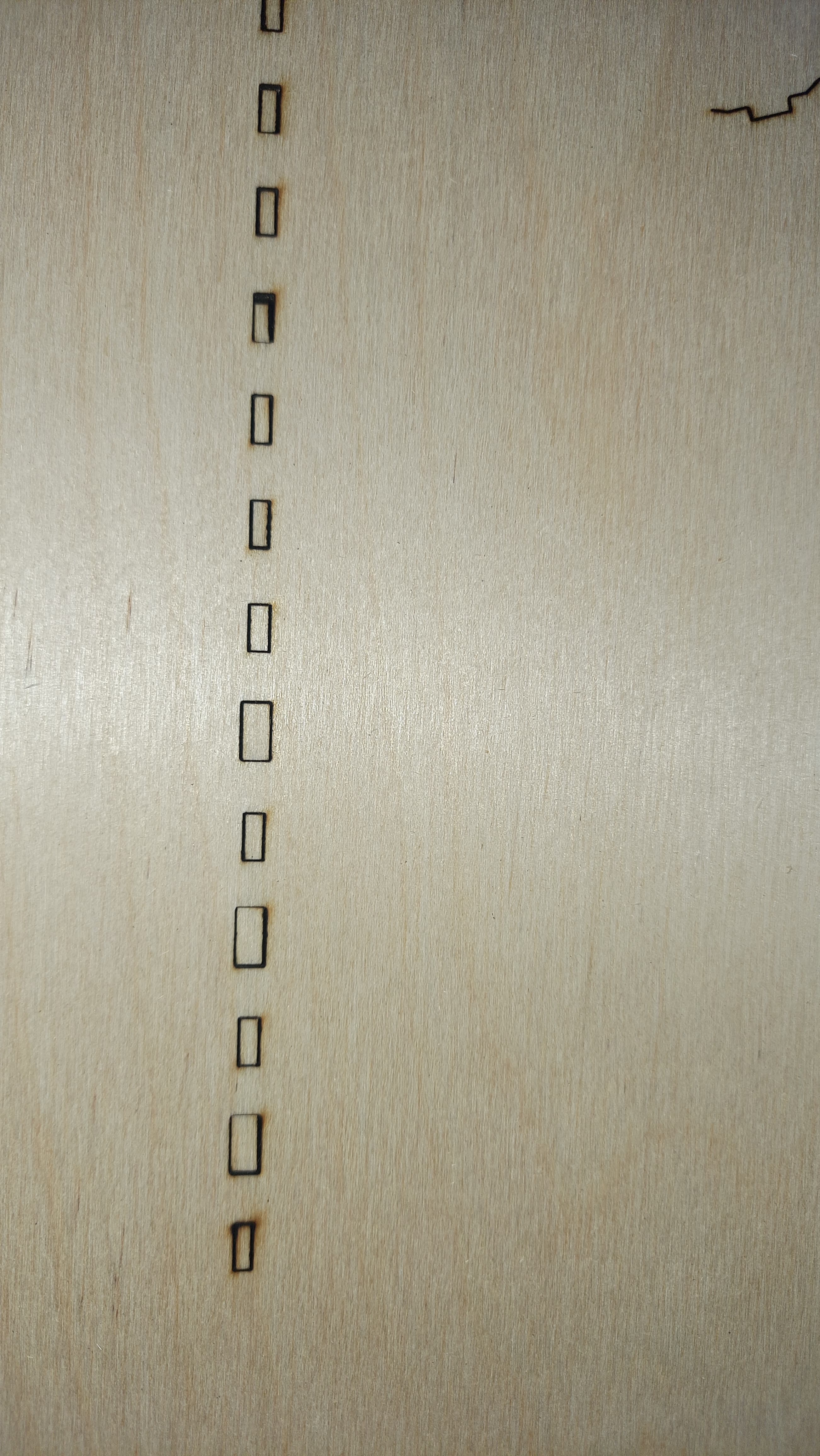

Hi everyone , I’m new, and have small problem useing lightburn. When im trying to cut small squares which are just coppied my laser cutter cuts them and every so often the come out slightly bigger or different sizes . Its like every 10, one or two are different size and then next few are proper size agian . Can any one give me any advise where to start lookin for the solution ?

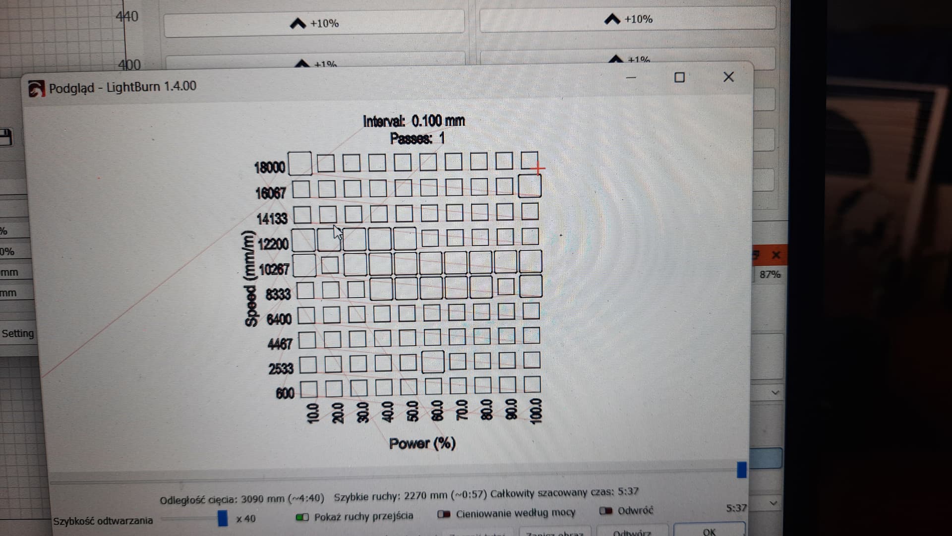

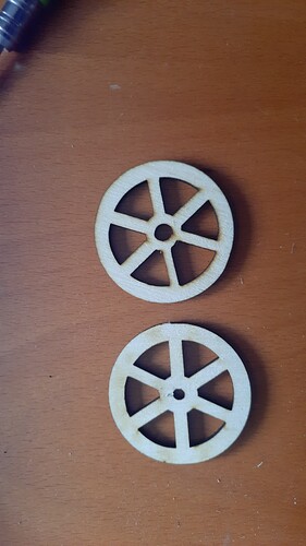

Well, im useing Neje max 4 . I will add some screenshots … same story with circles same wheel same size but when im cuting 40 of them after few they start to change sizes but when i select only one at the time its ok .

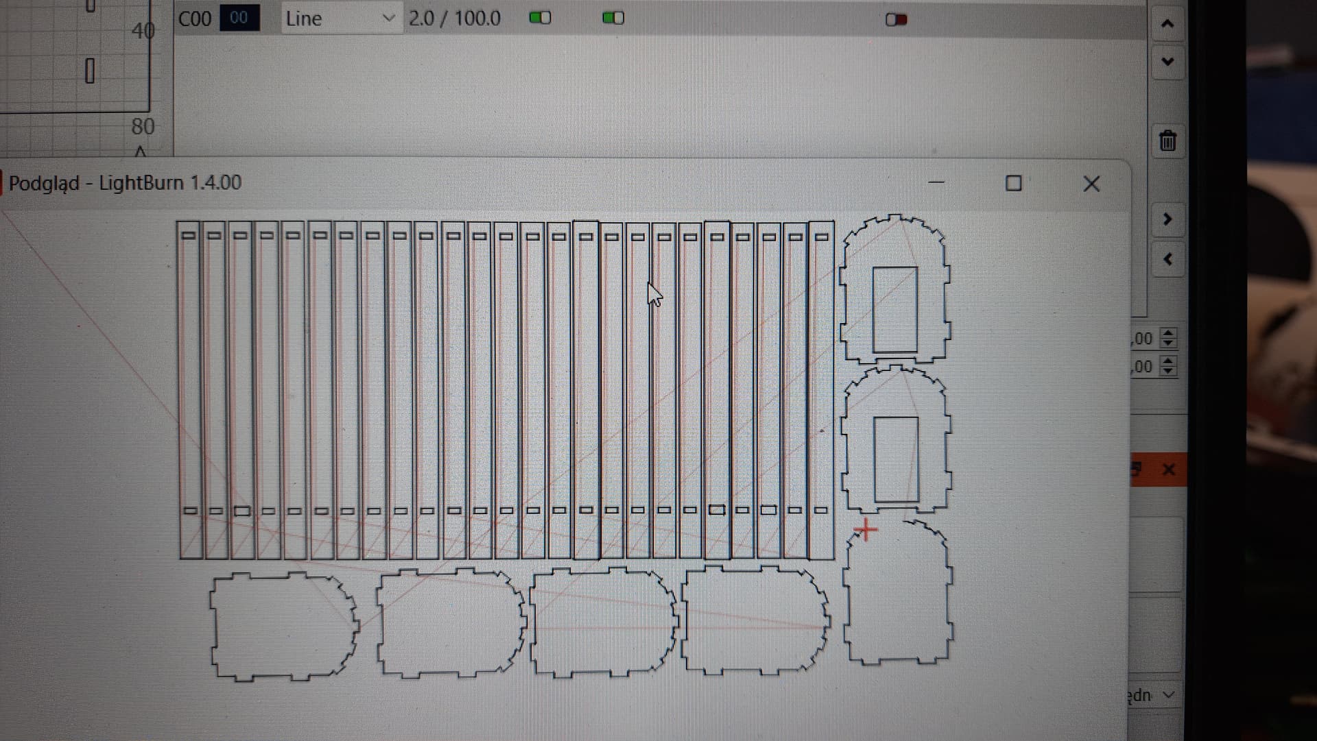

Ok so I’ve checked everything and couldn’t find anything wrong. I decide to see cuting preview (simulation) and guess what ? So it must be something wrong with setting or drivers im not sure …
Even on material test preview ,squares are different sizes…
That suggests some of the layers have Kerf Offset turned on, with what looks like a millimeter of offset.
Yes you were right, thanks for your help, took me a while to figure out where it was (like i said , I’m only new in it ) ,but I’ve got it and it’s perfect now.
