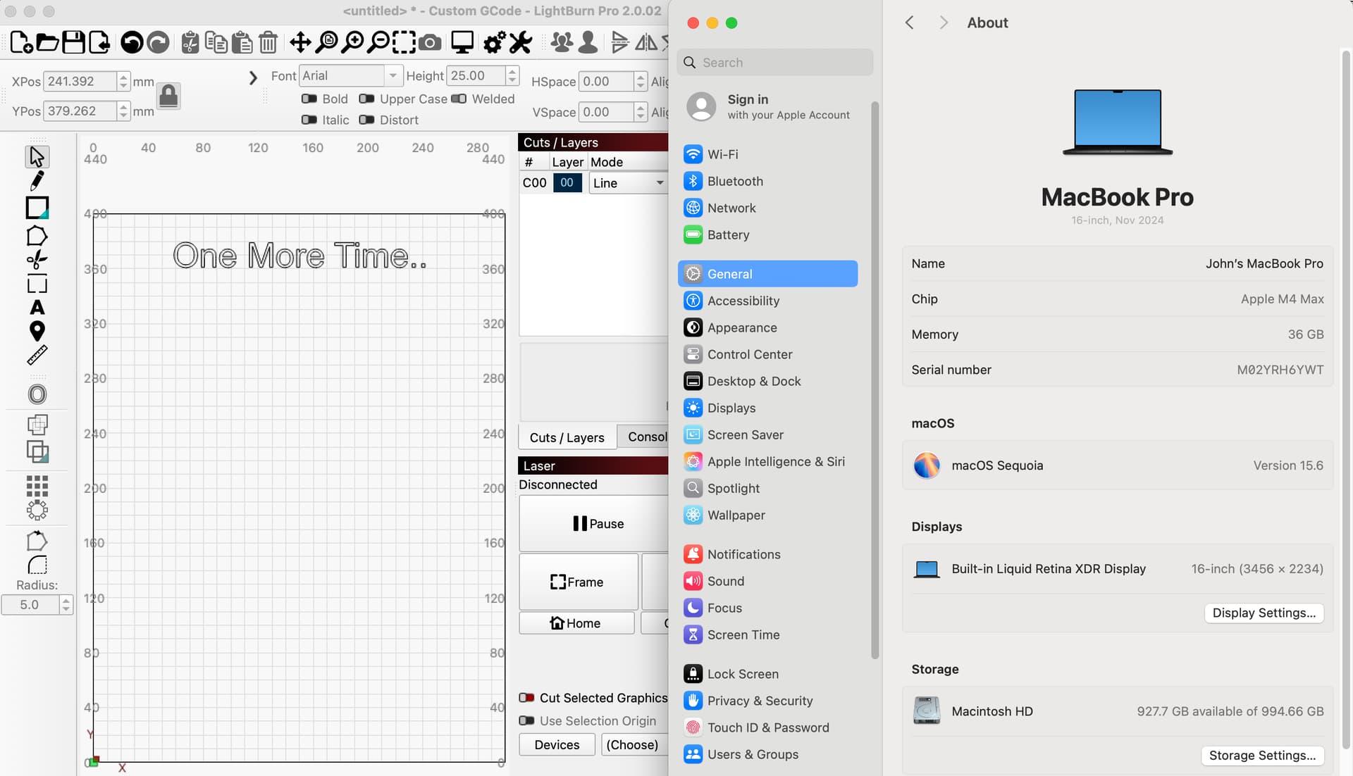

My space bar no longer works in 2.0.02 when inputing text. It worked in 2.0.01
You have checked for board chow under the spacebar, right? ![]()
No problem with 2.0.03 RC2 on Win 11, either local or through RDP, so more details on your system / keyboard / project will help narrow down the possibilities.
New Macbook Pro M4 Sequoia 15.8 Space bar inop when entering text. Works fine when I go to edit.

I have an American English keyboard on my Mac.
@JEH Can I assume that you have an American English keyboard as well?
I haven’t tested control keys that change the function of the Spacebar.
Do you have a serial keyboard, a mouse, or a dongle (for either) plugged into the Mac?
If so, please temporarily unplug these and retest the behavior of the spacebar.

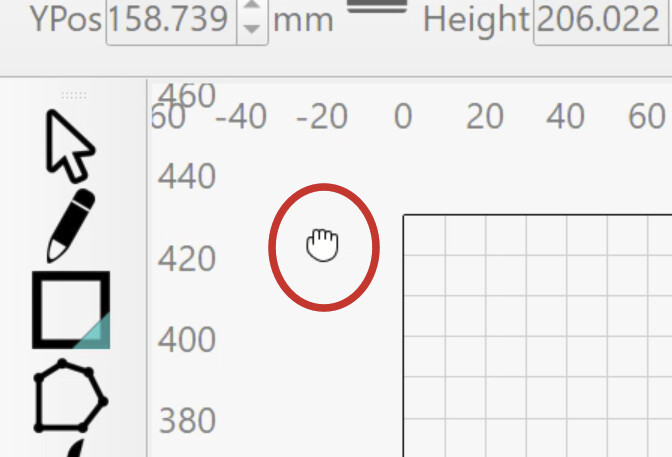

@JEH I have a theory. Please try the following:
- Press the Escape key to change to the Select tool.
- Press the space bar.
Does the cursor change to the hand symbol (used to pan the workspace)?
Which language are you using in LightBurn? Does switching to English solve the issue?
I am using English, escape highlights the text size and deletes the curser
I am using American English, no externals computer is a new 14" M4 Macbook Pro OS 15.6
Does the hand symbol to pan around appear when you hit escape and press the space bar?
No it does not

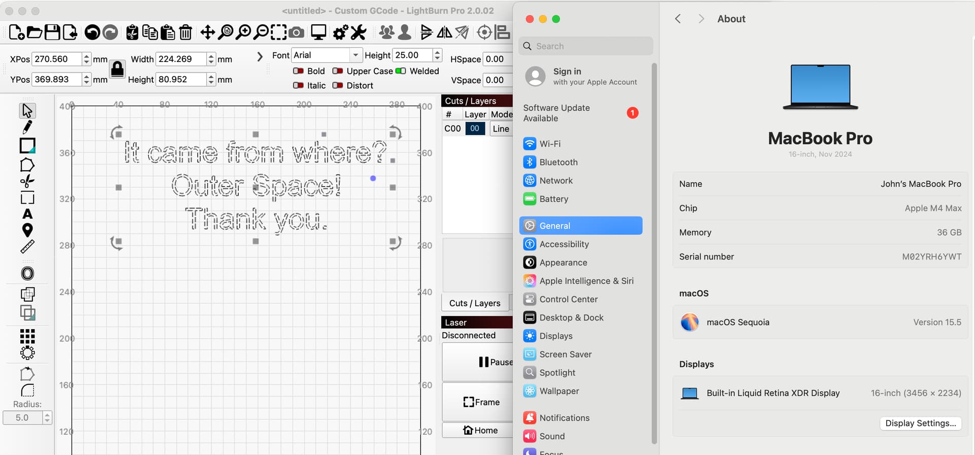

The only difference I see is you are running 15.5 I have 15.6
Updating now. Retesting shortly. ![]()
I didn’t replicate this right away. On the Mac M4, the Pan hand doesn’t show when spacebar is held. Spacebar and motion shows the Pan hand. I did invoke Pan by holding the spacebar and holding the left mouse button and moving to pan the workspace. On the Mac M4 the hand seems to disappear from view after a short time (while remaining in the Pan mode). It can stay visible for as long as two seconds after a pan move. Sometimes it disappears about 1/4 second after a pan move. While panning (moving) the hand remains visible.
Holding spacebar on my Win 10 machine immediately invokes the Pan hand. The hand remains visible while the spacebar is held. The hand moves and stops as expected. The hand remains in the same state whether panning or not panning.
@JEH
To test the Pan hand, press escape (once or twice) to exit whichever operation or function that LightBurn may be using. Hold spacebar to invoke the Pan-Hand. While holding spacebar, left click and move the mouse to pan the work area. On the Mac, I could do this on the touchpad, hold spacebar, hold left click, move along the touchpad with my third finger.
I’ll take the unanticipated Pan hand behavior to the UI Team for comment.
After updating, spacebar still works as expected when entering text.
