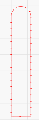

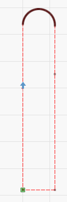

I create the “copy along path” from the arrow starting point but somehow there is not an even space between the starting and end point. I use a 4mm stitch space that I want to create. What am I doing wrong here?
The only thing I can think of is that if the length of the perimeter of your shape does not divide exactly by 4 (4mm) then the spacing of the final point will not be correct.
Thank you. I did try 4,5mm, 5mm, 6mm it gives me the same odd space. O gosh looks like I have to sit and type in a lot of different sizes then.
Perhaps another thing to try. Enter the number of copies you would want and let LB space them…might work
Thanks I will try that because I need a 4mm stitching space for this specific item.
Interesting when I entered the same number of copies (39) the spacing was even. Thanks David, much appreciated, problem solved.
