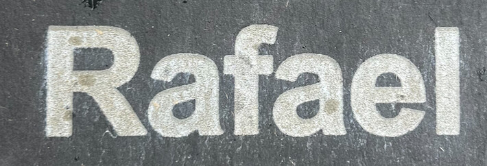

produce white engraving that contrasts well with the background. However, when I use these settings, I’m getting specks around most of the lettering that make it look messy. Here’s a picture right after engraving is done:

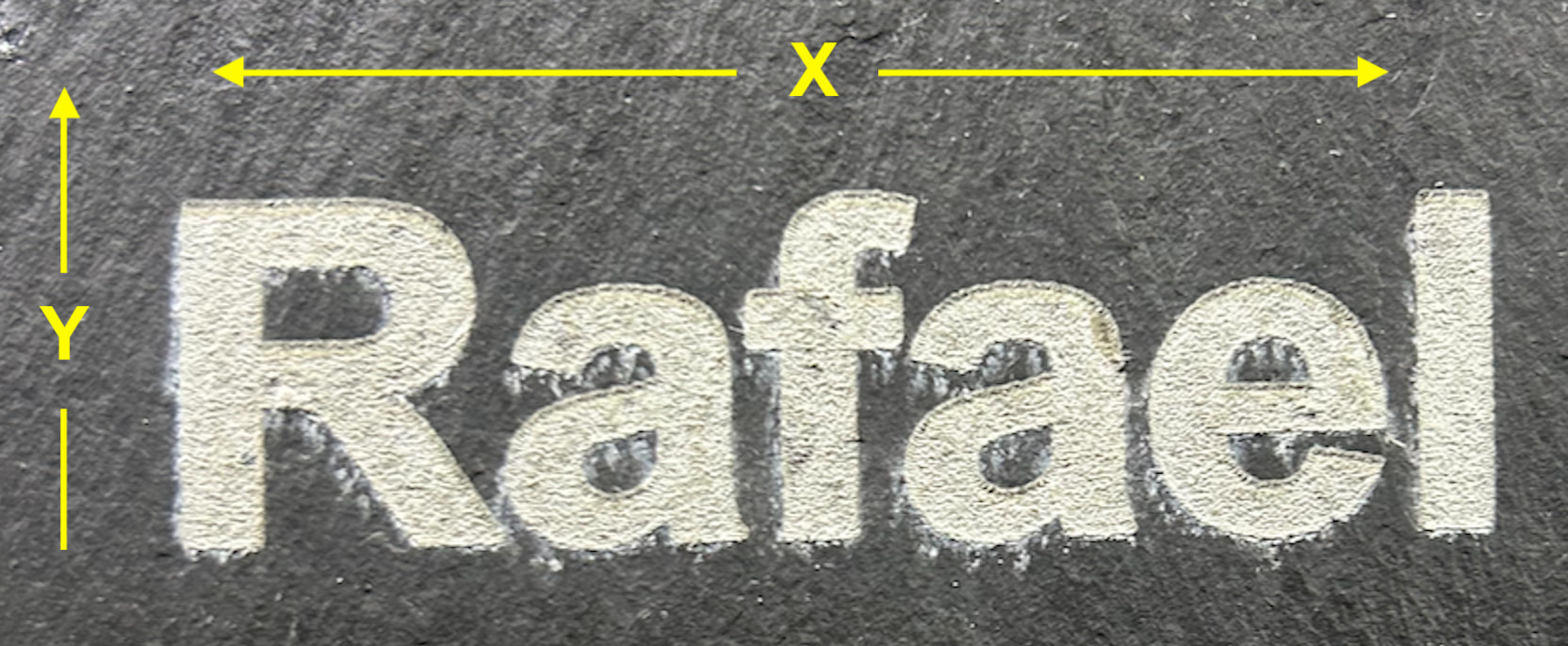

And here’s a picture after I run the slate under water and rub over the letters with my finger:
The engraving proceeds from bottom to top, and the specks seem to only occur on the underside of the lettering.
Oops, I hit send prematurely. I’m using a the shortest focal distance (2” lens) and air assist. When I use lower power or higher speed settings, I don’t get the same speckling, but the engraving is more gray than white resulting in poor contrast. Aside from rinsing with water, I’m not treating the slate with anything else after engraving because I’ve found that other oils just gray the lettering and reduce contrast.

It’s always helpful to designate the head direction. Some people post photos with the X and Y direction different from how it was orientated in the machine.

A couple things come to mind. One is don’t use oil. Another is to use higher power and de-focus a bit.. That would be a couple three mm with a 2" lens.
Have you tried a brush on it? Sometimes the debris really sticks to the material. If you melt a piece of slate, then the air assist moves it, then it solidifies back to the object.
How much air are you using on your air assist?
It would be nice to know the orientation. It should work better at a lower speed. I do this a bit on my co2 and don’t exceed about 150mm/s, rarely over 200mm/s. That’s my preference.

Thanks, Jack. I appreciate these tips. In response to your questions, X and Y axes are shown below, with the Y arrow pointing in the direction of job progression:

Have you tried scrubbing with a toothbrush? This may just be dust embedding into the slate. Maybe try without air assist.

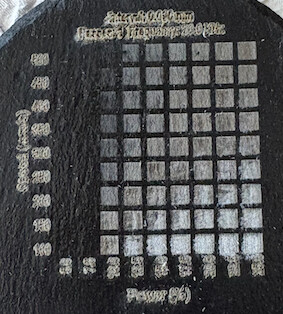

The lowest power that makes a mark is 10%. A material test matrix is below. The power settings go from 5% to 25% by 2.5% increments, and the speed goes from 100 to 500 mm/sec in 50 mm/sec increments.

The debris looks like it’s being blown in a downward direction.
Is it not lasing below 10% or lasing but not producing power? My original tube would only go below 10% when the tube was below 20C.
I really doubt you’re ever making 500mm/s that’s pretty fast, but possible. They have a pretty large overscan area at that speed.
How big are each of the squares?

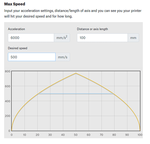

Using a common value for acceleration, I use one of the on-line calculators, with an acceleration of 6000mm/s, it takes over 20mm to reach that speed, along with another 20mm to slow down.
Have you watched it run? Does it look like it’s going 500mm/s?
Check your controllers acceleration value and know what it’s doing.

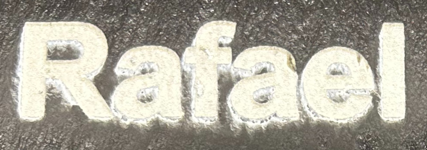

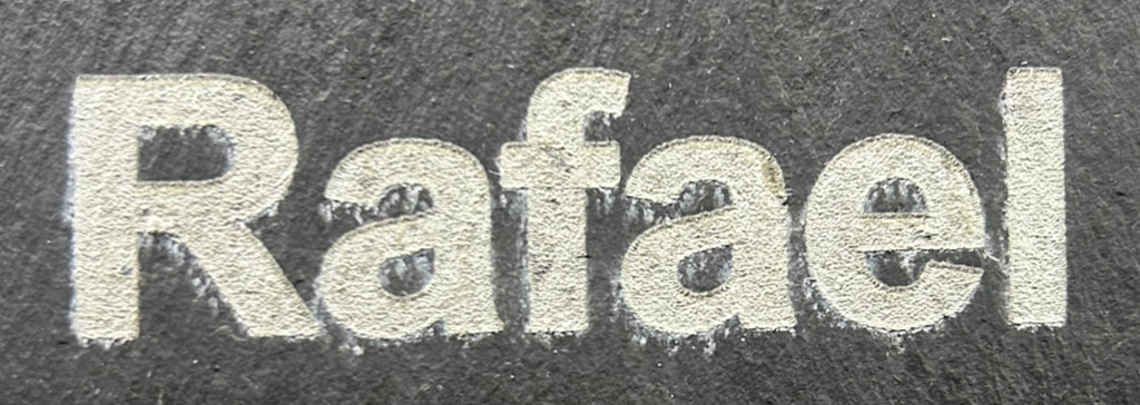

I have old eyes, so I can’t make out any kind of detail in the last photo you posted. :man_shrugging:

Scrubbing with a toothbrush did the trick! Thanks to everyone for your input.
