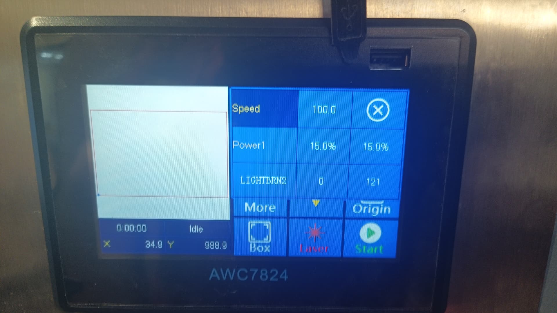

New Laser. Trocen AWC 7824 controller. Communication seems fine, however speed and power settings are not transferring, only the geometry is.
Speed is 100 and power is 15% consistently.

On my Ruida, it will show the console settings until I load a file. Could be be happening to you?
So if you move, it will do so at 100mm/s, if you pulse it, it will pulse at 15%.
Solution was understanding that parameter screen wasn’t for the file, but for the overall system.
The underlying problem was an alignment issue. Wasn’t expecting that since the machine was set up Friday by the dealer and this was my first run through with it.
So not really a solution. was a non-issue. as in lack of understanding of this controller’s particular quirks.
Not much to be learned other than dealers sometimes make mistakes too. And similar isn’t same.
