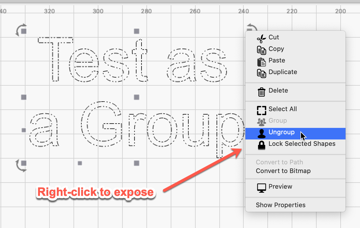

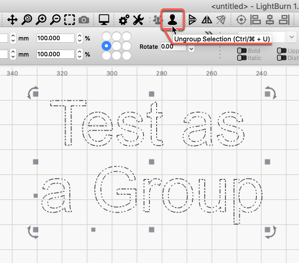

HELP how do i separate group text to be there own text
With the text selected, you should not the marquee being different (Dot, Dot, Dash). You should be able to ‘Ungroup’ from either the menu, the toolbar, or the Right-click menu.
