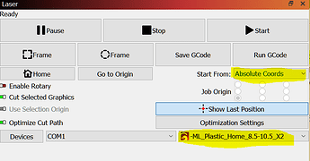

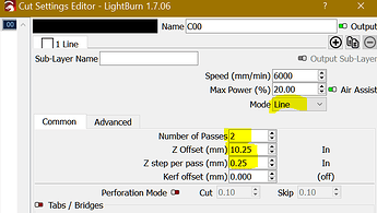

Try this:
Download then drag this device over the Lightburn workspace -ML_Plastic_Home_8.5-10.5_X2.lbdev (16.1 KB) to Auto-import it.
Select the above device in Laser window
Keep these settings and check if you need to change the circle-green ones.
For Line mode or line Fill mode use at least 2 passes.
We are not 100% sure that the distance from the workbed or material is the same to the tip of the tool, so keep the first pass as a “levelling-surface-pass” then do the second and / or third (in baby steps) to the required final depth.
Important:
  • 1 - Check if your machine Home cycle also homes Z and disable Auto-home in Basic settings, when you run a project it will Home then down to Z8.5 ( may not need this…).
  • 2 - The above device will move up the Z between each shape with the above Cut/Layers settings.
  • 3 - If you have different materials with different thickness just duplicate the device give different names and change the values accordingly.
