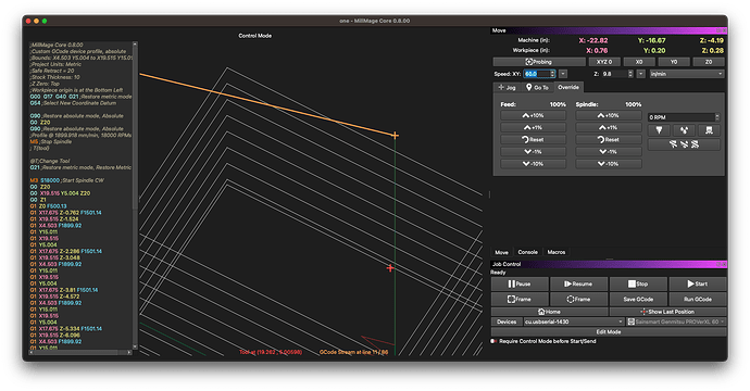

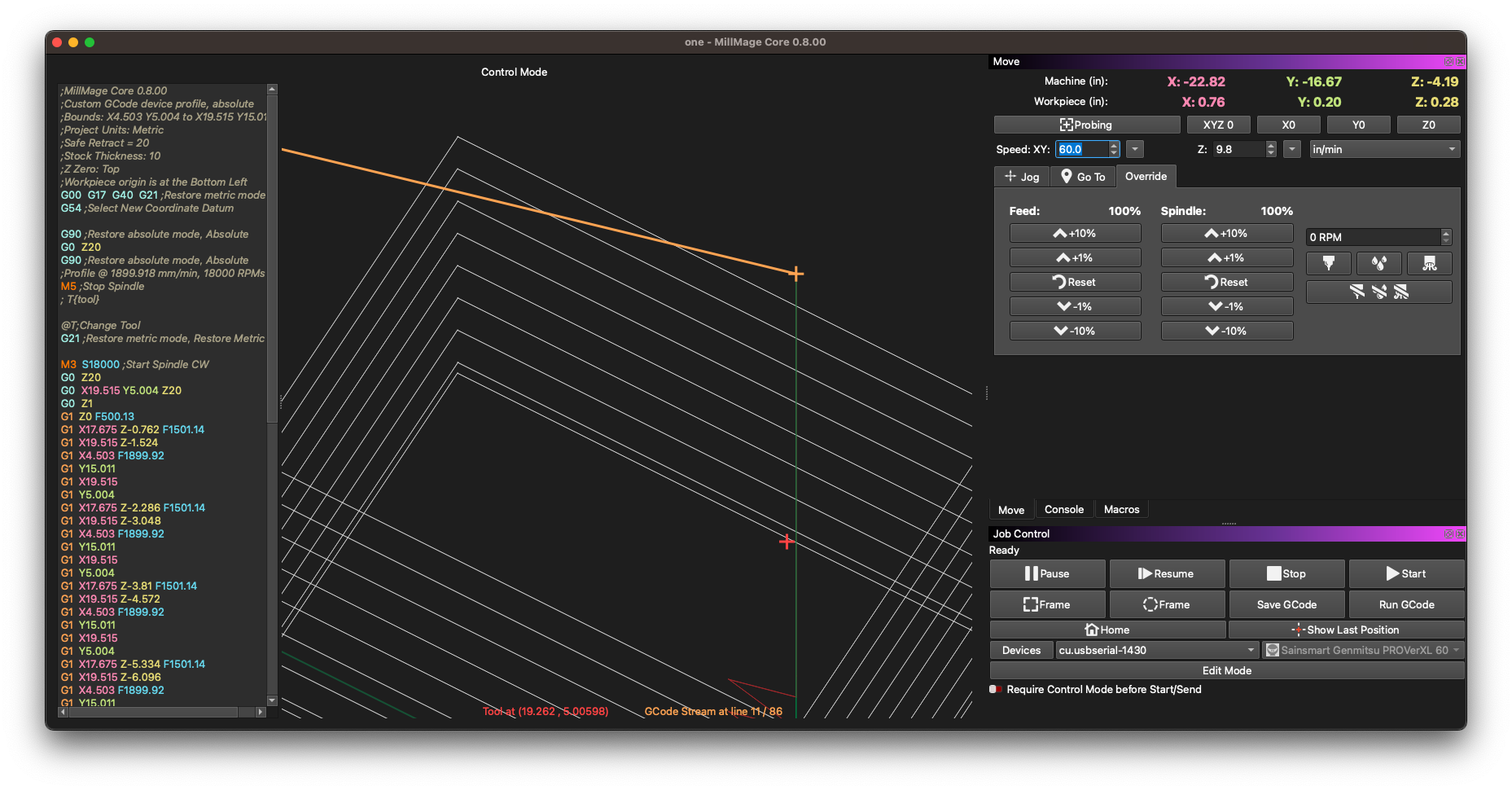

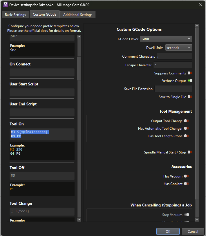

I think I’m continually disliking MM more and more. I typically use Gsender but thought I would try MM. I created a simple tool path. When starting it the spindle goes down. The spindle does not turn on but plunged the bit into my wood without turning

Your machine use a GRBL controller? If so, please enter $$ in the Console window and give us all the $xx parameters less than $100.

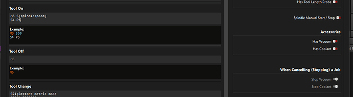

Did you set the RPM in the Tool setup? That is where stuff like chip load is set.
If you imported a Tool Library, you should check every tool for the parameters that work for your application. You can have identical tools with different settings, like for wood or acrylic, or even dense foam.
