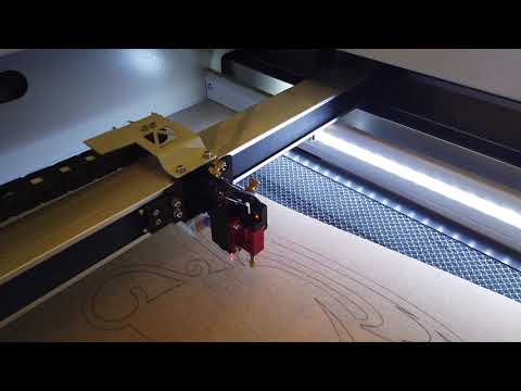

Which Print & Cut video did you watch? We’ve got a few. Your design has plenty of sharp angles to align to — I recommend creating a couple of new shapes set to a Tool layer, centering them over corner points (the farther apart the better), and using those with Print & Cut.
This video shows how to use Print & Cut with existing corners in your output:
And this video shows how to cut a design into multiple parts and use Print & Cut:
A combination of the two should work well here.
We’ve also got a general use video here:
