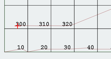

Just to make sure I understand about wrapping, I added 300, 310, and 320 to my CSV and did a preview, this is what I got:
Thatâs not the wrapping you meant, yes?

Yes, that is what is happening. When LB runs out of cells (squares), the next number in line (mine=10, yours=300) in the CSV goes into row2 cell1.

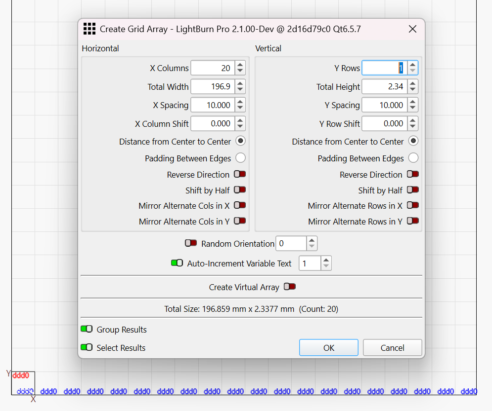

If I understand correctly, you want the X-coordinate displayed in the lower-right corner of the cell, and the Y coordinate displayed in the upper-left corner, correct?
By trying to do it all in a single pass youâre making it much harder than you need to.

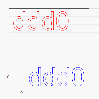

First, set up your âcellâ - Iâve create two text objects, the blue one for the X grid labels, and the red one for the Y grid labels. Set both to âserial numberâ with the initial offset set to 1. I used ddd0, but the text couldâve be dd0. I stuck a zero on the end because Iâm only incrementing the variable text by 1. If you wanted to just use ddd with no zero, change the variable increment to 10.
Set the blue one to âright alignedâ and the red one to âleft alignedâ, so theyâll align correctly as the numbers change.
Then grid-array them in 4 passes:

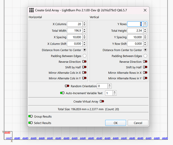

Duplicate the single blue X label horizontally, with âauto incrementâ enabled, and 10mm center-to-center spacing in X:

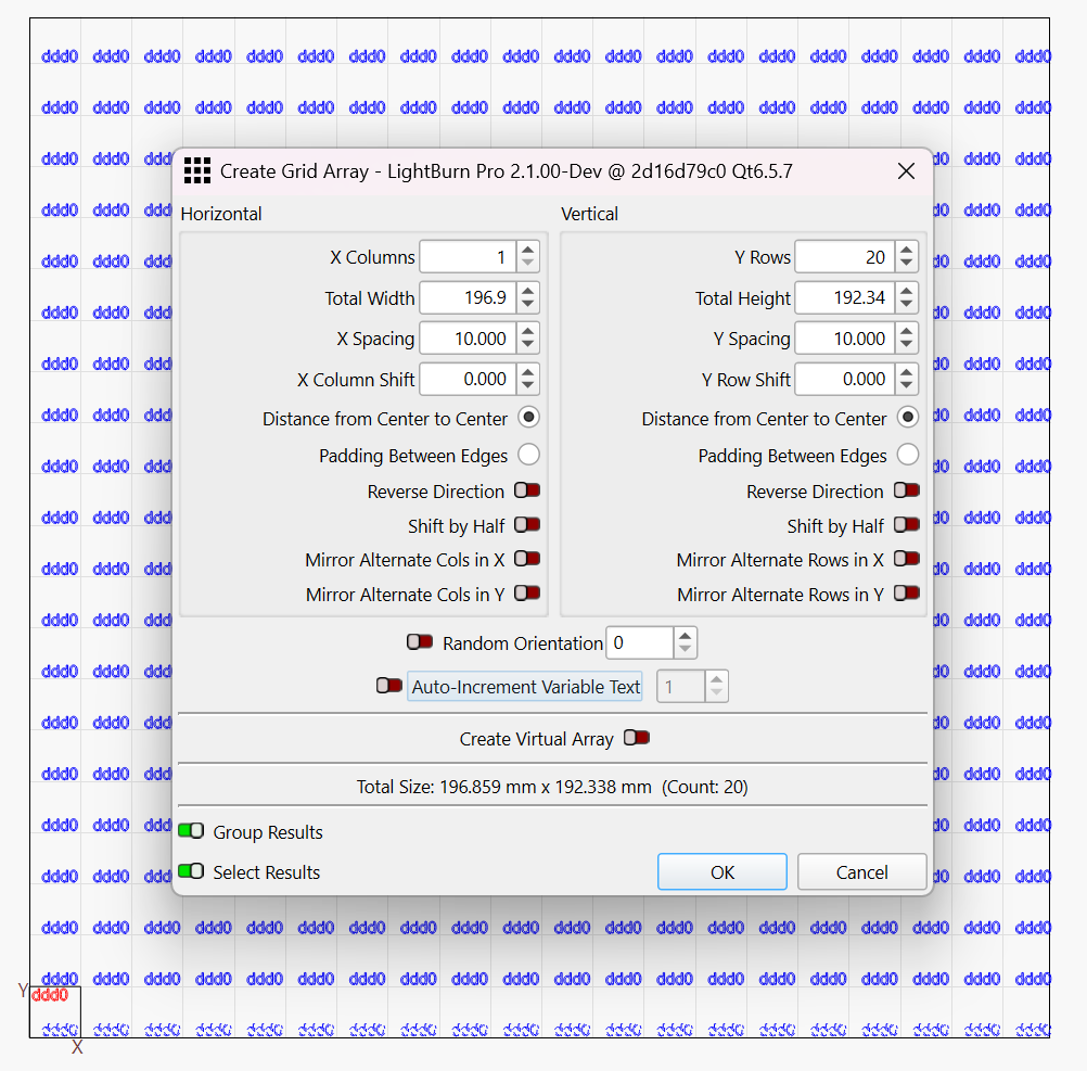

Duplicate the entire row of X labels vertically, with âauto incrementâ disabled, and 10mm center-to-center spacing in Y

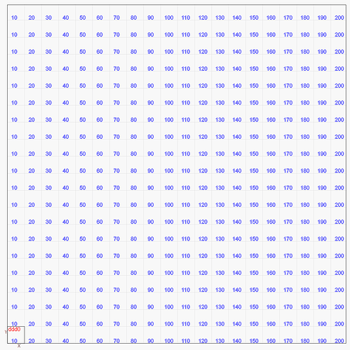

At this point, previewing shows the X labels are done:

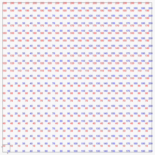

Now do the same for the Y axis, but flip the directions - Array them vertically with auto-increment on, and horizontally with auto-increment off, and you get this:
Is that what you were trying to produce?
Yes, but with a single array. I did do it with a carefully made CSV file.
