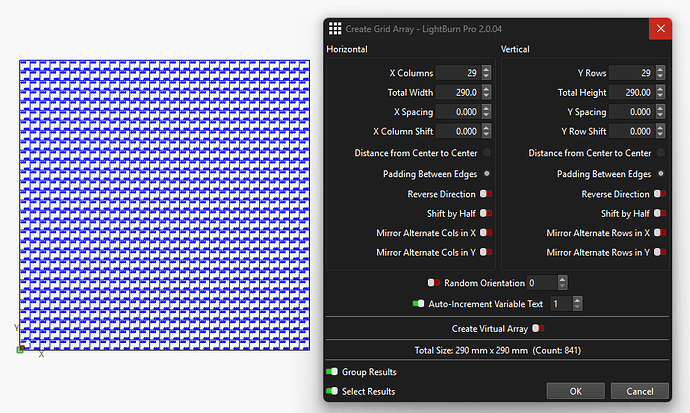

I decided to burn a grid into my spoil board. First, because it looks convenient, second, because it will help me learn some of the software (GRBL - LightBurn Pro 2.0.0.4, windows 11).
I wanted to be fancy and have it put the coordinates in automatically but have run into trouble with the incrementing of the variables. This is how I went about it:
  1. Set up my wee square the way I wanted it.
    For both text strings
  2. Created an array.
  3. Previewed…

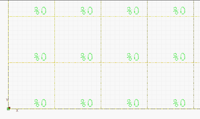

I have assumed (my fault) that being separate instances of text, they’d increment separately but apparently not.
Is this pie in the sky or is there a way to get Lightburn to generate the coordinates the way I want (x in bottom right, y in top left)?

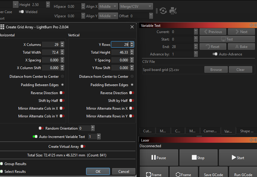

I tried to implement your suggestion but I likely misunderstood. I can’t attach the CSV I’m using (see the postscript) but it just runs from 10-290 down column A (rows 0-28).
Here’s my array and variable setup…
and my array now.

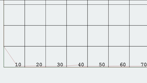

I’m ignoring the Y while I get the X working as I’m just figuring out the Merge/CSV system. Here’s the screenshot from the preview…

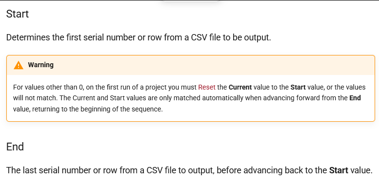

From the documentation, I thought the current index/row/serial was supposed to cycle from the Start index to the End index and then return to Start. I assumed that meant it would cycle so I expected to the see the same 29 values repeated row on row as the array goes upwards but instead it’s blank after the first row. This also happens when I click the Test button. What did I miss?

The auto increment will go from %28 to %29. If there’s only 29 values in the csv, %29 will be blank (0 indexing) You can copy the 0-28th row into the 29-58th in the csv and you should see the 2nd row populate in light burn. 28 more times and your good to go!
I’m starting to wonder if I hallucinated the documentation but I was sure I found something that said it goes back to the start on its own but now I can’t find the page…

I sorted it out, and you are not going to like the answer. Once I understood clearly what you are trying to accomplish, I went into the research mode. Variable text apparently does not wrap columns. But if you put in a second set of numbers in the CSV, it will populate the next row. Two down and 27 to go.
I uploaded the new CSV file to illustrate what I did. Link to it and you will see the second row in Preview. I also uploaded a couple of PDF files. Remove the .txt extension to view them.
To get the Yaxis numbers, add a %1 variable to the grid and populate the CSV cells with the appropriate Yaxis values. You will then have a set of XY pairs for each cell. If you think about it, you may not be able to duplicate the first 29 rows in the CSV due to a different number pattern in the Y numbers.
