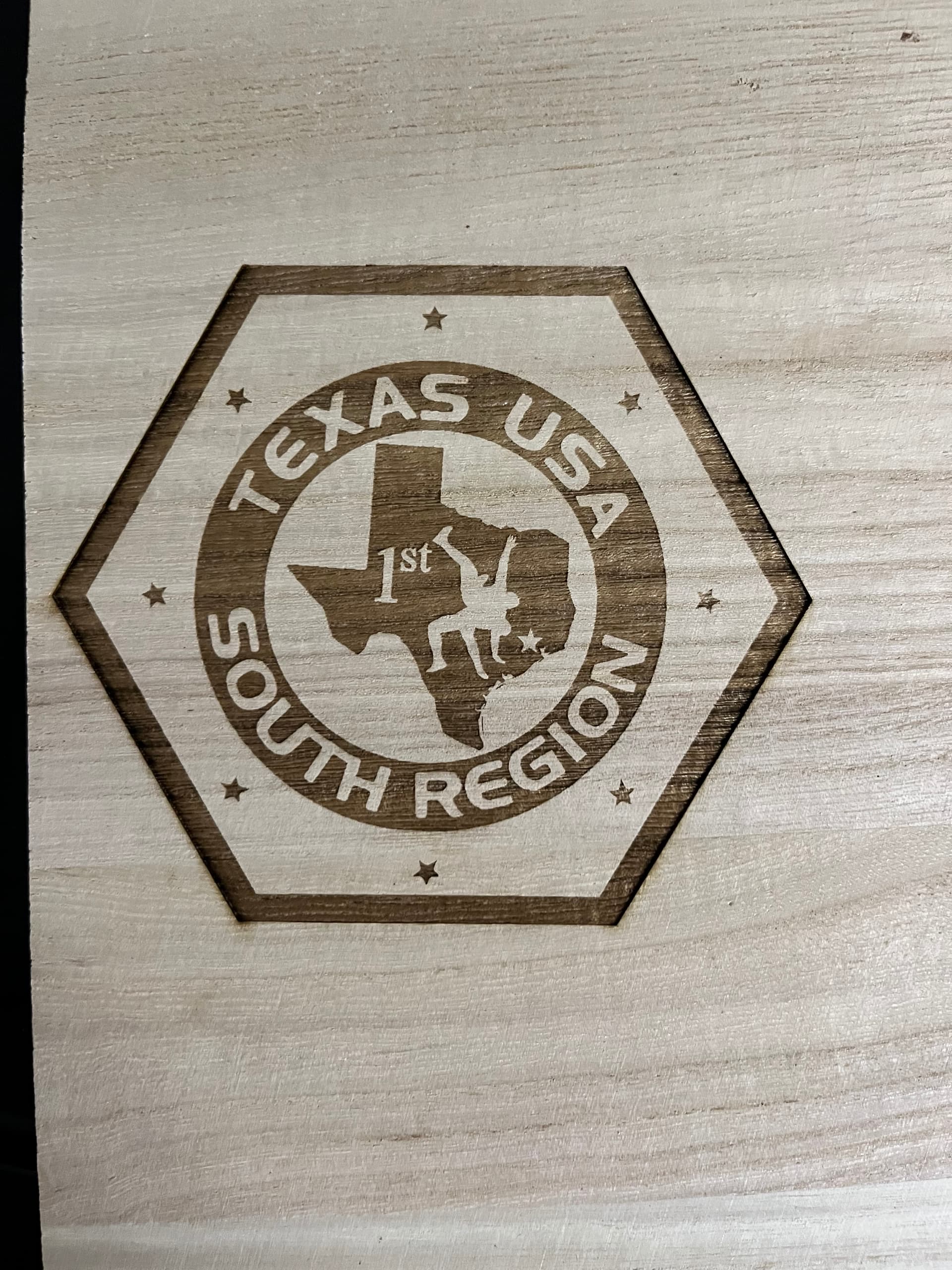

I am about to make a few sports awards and wanted input on what type wood would be good for this order. I can’t find a 10" thick hexagon shaped piece so will probably have to engrave, then cut out my hexagon and router the edged (maybe).

I apologize, I meant using a 10" round and 3/4" thick. Probably a 1" x 10/12" plank of wood. Engrave about 1/4" from the edge or so, chopsaw the angles of the hexagon, then router the edge a bit, polyurethane at the end. Mainly asking about wood type. Probably a premium pine as to not get too expensive. I am using an Ortur LM2Pro 10w.

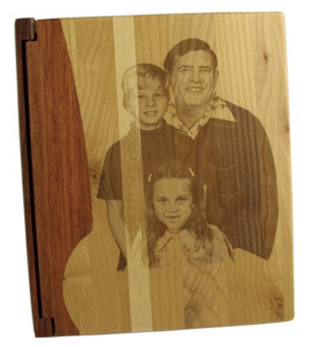

What’s the first thing that catches your eye when looking at a Zebra? The stripes! Wood has a very similar effect on the eyes. This is because our eyes are naturally drawn to to character/grain of the wood. For furniture a heavy grain/streaking is usually desired but for photo/plaque engraving it’s a distraction and will quickly rob the plaque/photograph of detail. When laser engraving you want to choose a wood that has a smooth consistent grain with minimal streaking. So what is a smooth consistent grain? A wood with nominal alternating light and dark streaks( bamboo is also notorious for this)
The wood we use for laser engraving
For our application of laser engrvaing we have found that Alder wood works best. It offers a high contrast engraving with consistant results. In many cases it’s better to be seen and not heard and in the case of Alder wood it fits this bill. For the most part it has a subtle grain which can be seen but is not distracting from the content being engraved.
Wood is a very challenging material for photograph engraving however once you are dialed in you can produce very consistent results. Selection of the wood is ONE key factor in producing a quality engraving with detail and contrast. The other key factors are image processing and the print settings for the laser engraver. These are just as important as wood selection and usually requires a significant amount of testing.

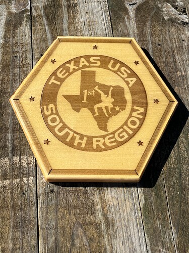

I went with the basswood. Had some time constraints and whatnot.

Looks great nice job! I am also a beekeeper so i am partial to the hexagons. :slightly_smiling_face::+1:

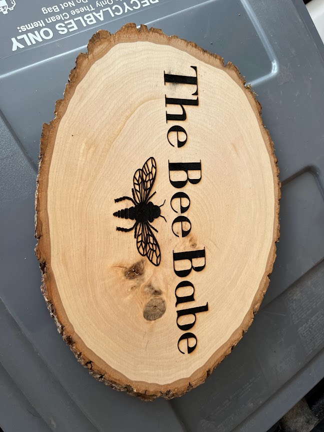

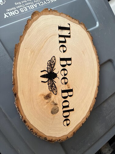

I made this one for my who is a bee keeper. She does a great job at it.
