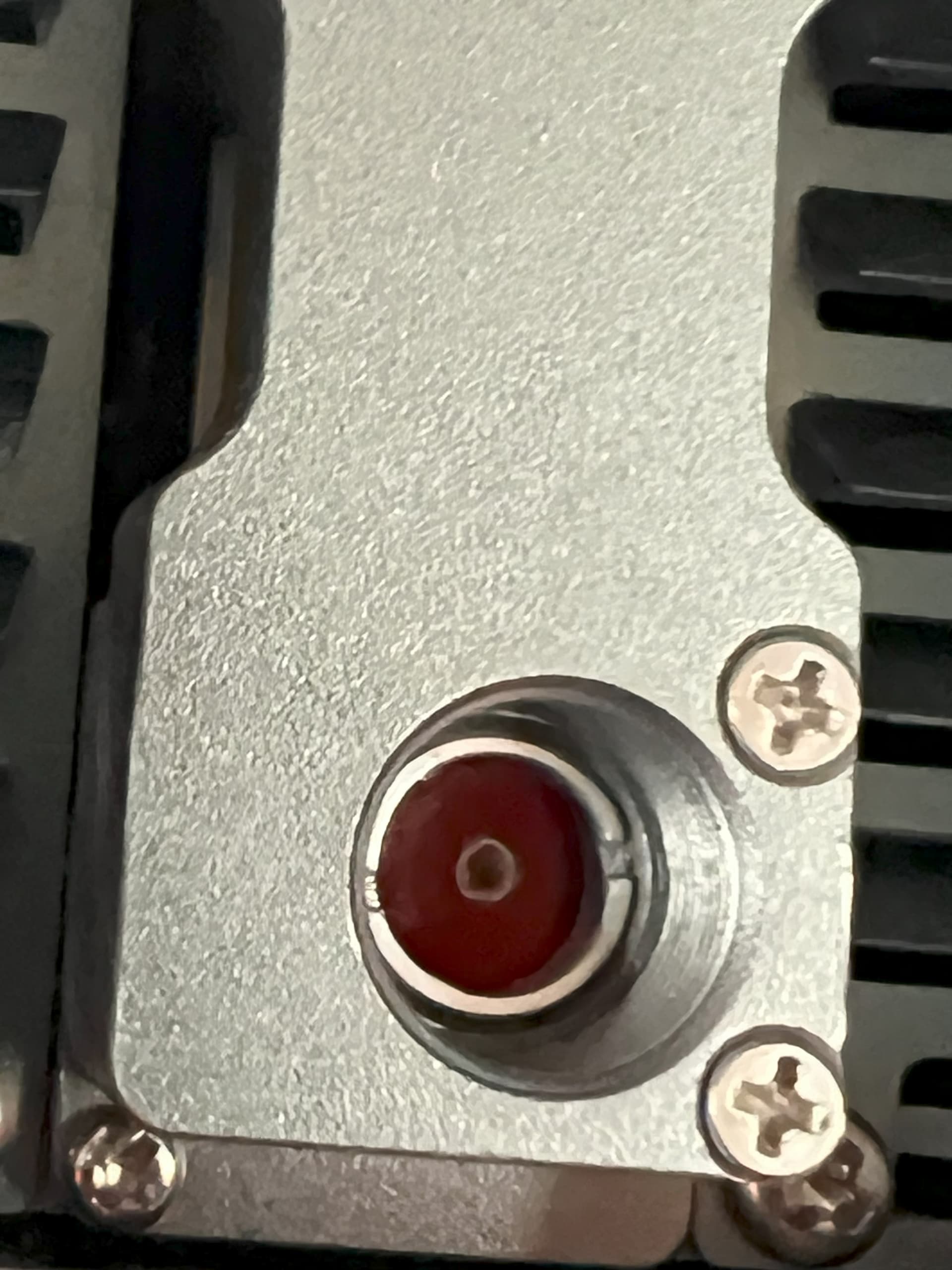

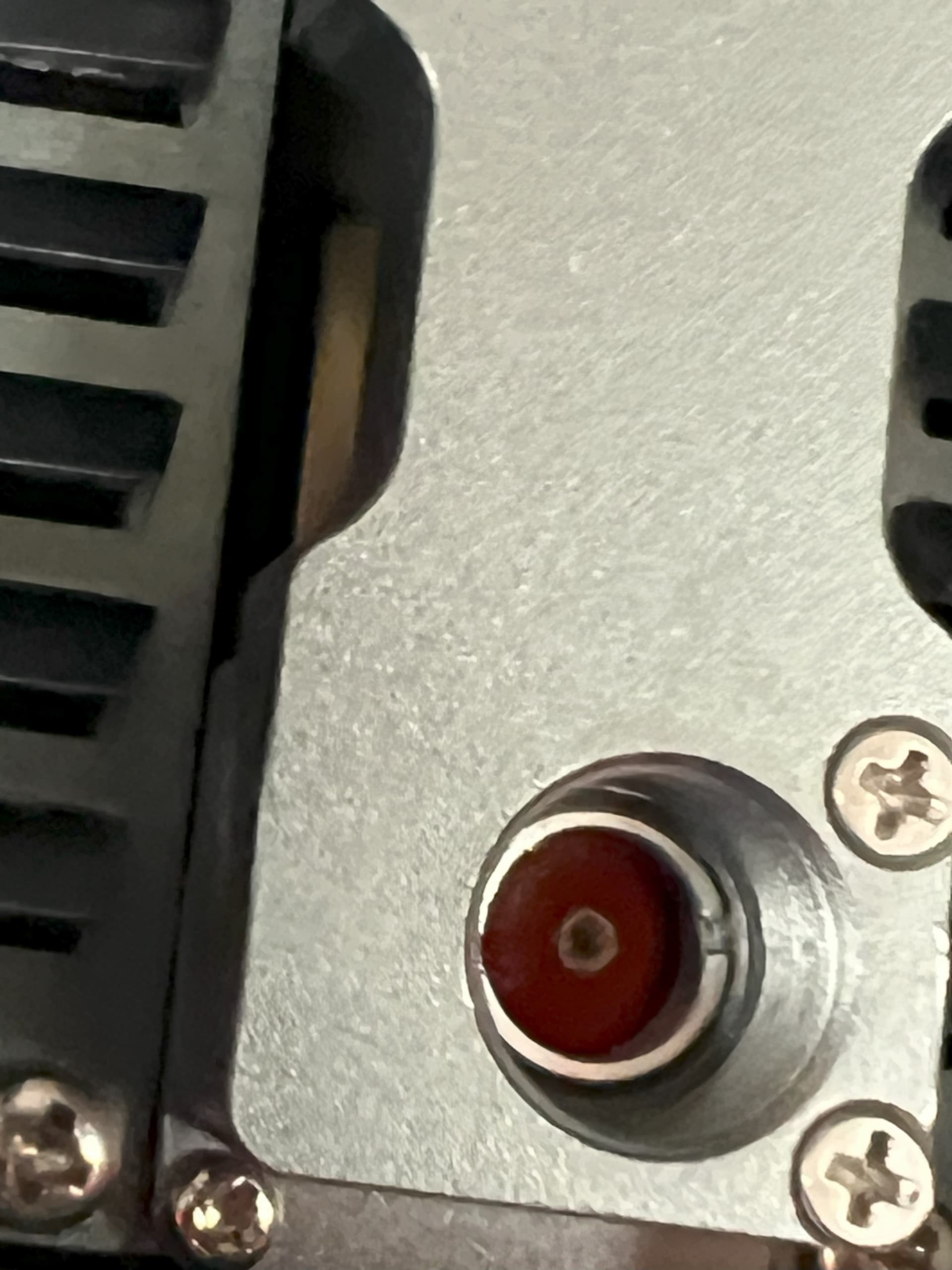

This spot showed up on the lens of my new Ortur 20 watt laser on my Ortur LM3

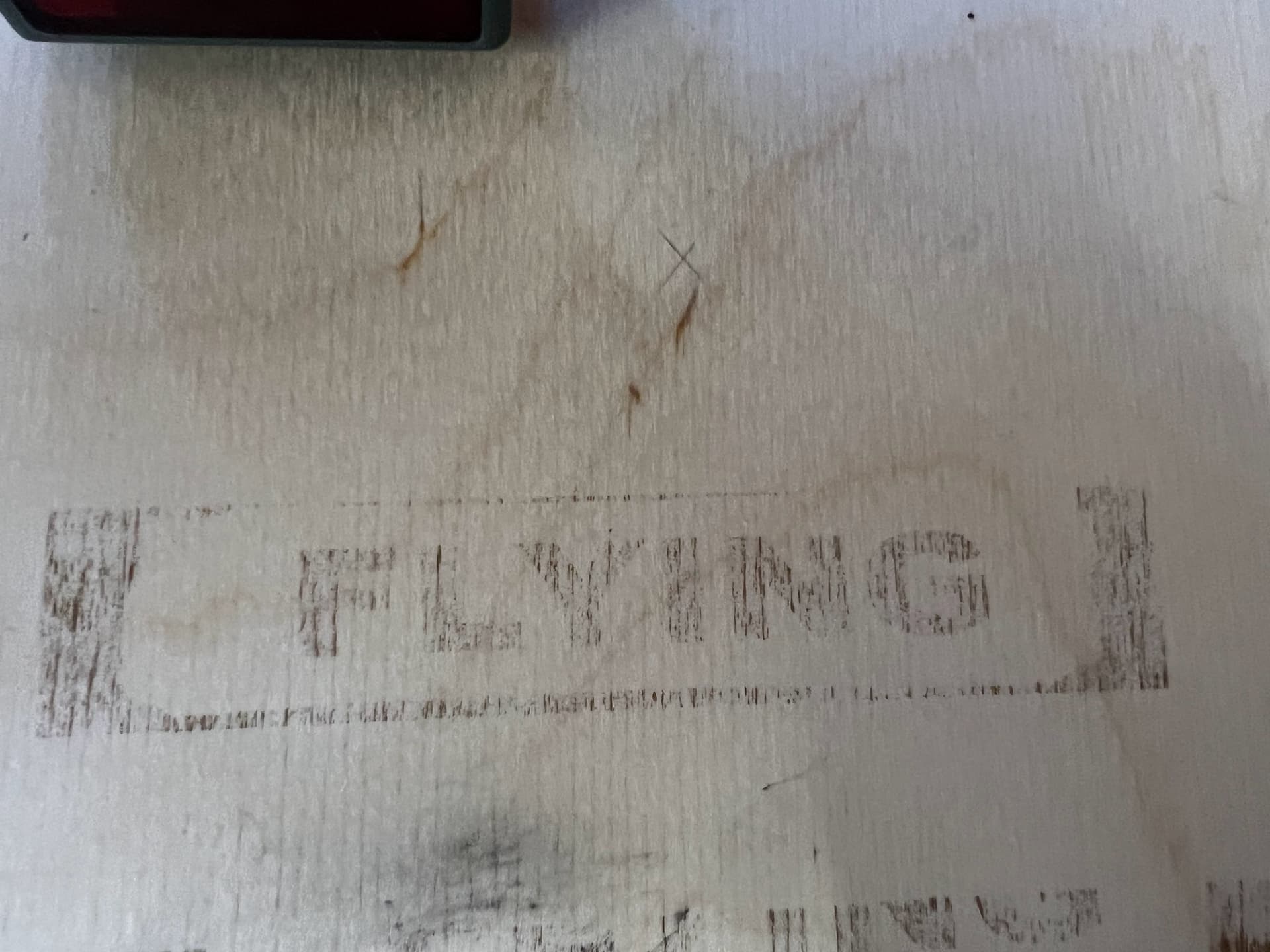

. A tech from Ortur said that this was normal. I am having a hard time believing that, especially, since it appeared my Ortur 10 watt laser will do a better and much faster burn then the 20 watt laser. Do these spots look normal to you?? The one picture shows a burn at 140 in/min at 90% power.
It’s visible light laser, it should be clear… it looks like it’s burnt to me…
Been doing metal or anything reflective? My co2 had this happen, when I insisted on marking some stainless steel…
Cost me a new lens.
The only thing I have done with this laser is wood and NWT. I will be contacting Ortur again. I’d be happy with getting a new lens. The laser is still under warranty. It’s only about two months old. Thanks for your reply!
