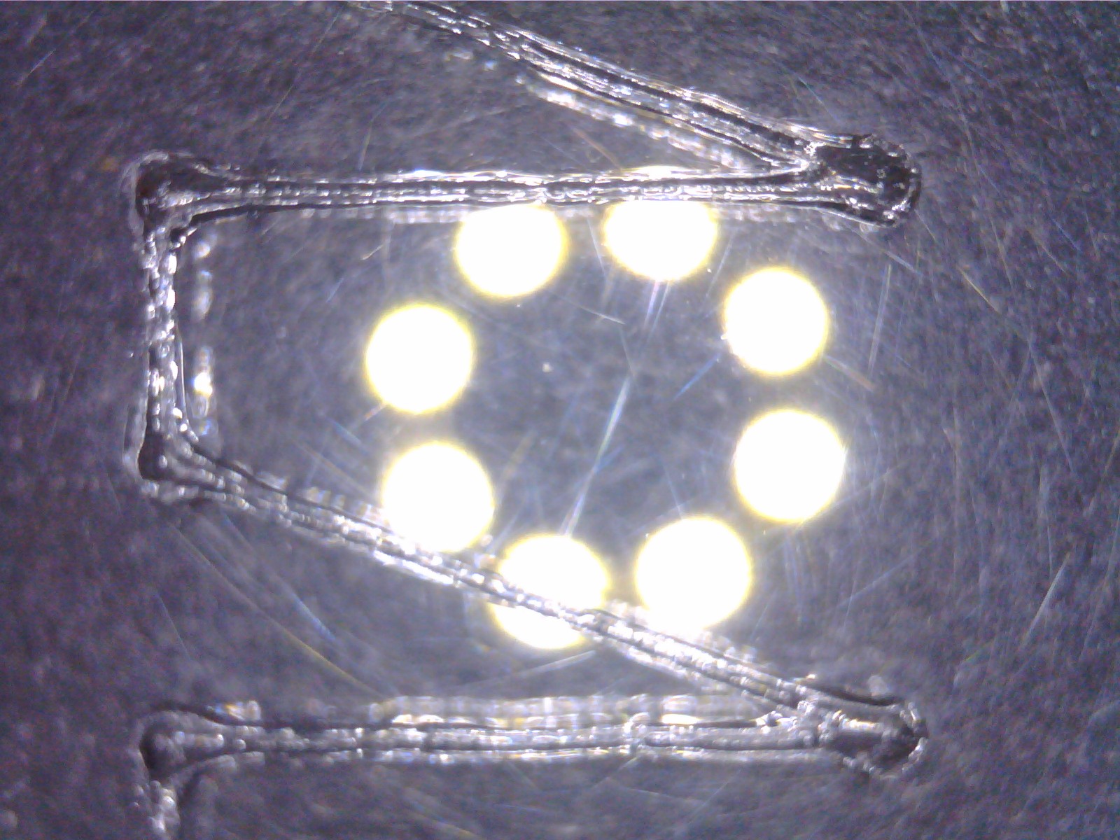

Spots appearing at line intersections
What settings may cause dots to appear at the intersections of lines?
X-Y Test.lbrn2 (7.4 KB)
It looks as if the laser is pausing at each corner. Note: The vertical line on left is 3mm in length and the horizontal lines are 8mm in length.
DSP AWC708 Controller
LightBurn 1.7.07
min power being set too high can do this. As it slows and reverses, it’s not throttling back the power enough
It must (almost) stop before changing direction, which means the controller must reduce the power as it slows to produce the same effect on the material. As @Dannym points out, the Min power setting for that layer is too high, so the controller can’t reduce the power enough at the lowest speeds.
However, ordinary DC-excited CO₂ laser tubes won’t ignite below about 10% of full power = full current, which means you can reduce the layer setting to the point where the laser won’t fire in the corners.
Amusingly, the firing behavior depends on both the Min and Max power settings, the cooling water temperature, and the laser path through the pattern.

With Min = 7% and Max = 10%:
With Min = 7.1% and Max = 10%:
With Min = 8% and Max = 10%:
Bottom line: You may find settings that work today, but they probably won’t work tomorrow.

What matters MOST is the PWM freq. The power supply and tube basically have a minimum pulse width needed to get output.
The power supply and tube needs about 1ms to turn on or turn off fully.
People keep setting the systems for like 10khz which is insane. That destroys the low power range as it won’t output for 20ns pulses.
You can also set the pwm even lower than the tube response, based on your speed and spot size (spot size is usually about 0.2mm for 2" lenses). Total turn-on and turn-off of output with an RF laser still yields a smooth cut if you get in two pulses per spot.
HVDC-excited tube is ramping up and down within 1ms, not an on/off pulse. If you PWM at about 700Hz, you will get a very nice linear response and smooth cut up to about 400mm/s, at which point the ramping up/down stretches past the spot size and the cut width ocsillates. If you go faster, the cut becomes dots or dashes. But almost no case vector cuts anywhere near 400mm/s, only rasters do. Set PWM higher for raster. The tube’s response will end entirely at about 1.5khz-2khz. That is, the tube’s output doesn’t even ripple at 2khz 50% pwm, much less turn on or off.
To do a linear tune, first set the pwm to like 700 or 1000 hz, put paper on the bed, do a cut speed of like 50mm/s, then find the lowest power % that makes the laser actually fire. It’s paper at 50mm/s so basically any tube output at all will mark or cut it.
Enter that PWM AND like 1% below that %min power you got into the Ruida config (not user settings). This creates the linear tune and you generally can, and should, to set min power at 0 for everything in user settings, as the user settings scale within the min and max of the Ruida config. Everything vectors trouble-free without fiddling with settings further except setting speed
You will override PWM to higher if you’re above 400mm/s (usually raster). 2KHz is generally a good number. Like I say, the output doesn’t even ripple for 50% pwm at 2khz. But there is one technical catch- the Ruida does not resync its pwm to the job contents, nor does the “right thing” and compare the pwm counter to the design demands at that moment. At 1000mm/s, the 2khz pwm cycle is 0.5mm spatially. When the head crosses an edge in the design’s graphics, it may be at the start or end of that 0.5mm wide cycle but it’s not going to start to fire until the next pwm cycle, and when it reaches the edge of the graphic, it also will stay on until a new pwm cycle starts.
also machine parameters, esp acceleration, affect the corner cut quality quite a bit.
if your machine is rigid enough to run high acceleration, then the physical length of the segment of a vector where it’s not at full speed and has to use power scaling can be so insignificant that it may not matter what you do with min power
the ruida has several poorly documented controller parameters that handle cornering behavior and allow you to run much higher accels and maintain cut quality
there is a field that is seems to limit the derivative of accel, aka “jerk”, and that will prevent overshoot and “ringing” or “bounce” to test for that you actually just need to make a tiny radiused corner because it performs a stop on a regular corner and that type of motion is generally immune to bounce, but tight curves are what you have to tune for
