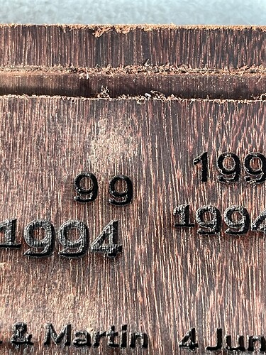

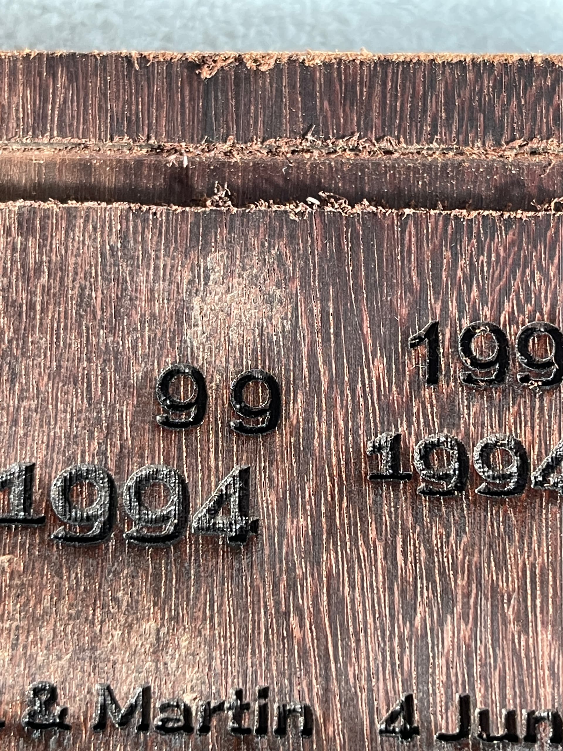

Im using the Neje Max 4 and extended the machine and now the bottom of text are a bit squished.
What am I missing?

No, the entire text is squished. The hole in the “9” should be oval, not round.

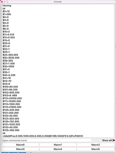

Did you change ANY GRBL parameters, and if so, which ones? Your X and Y travel is not synchronized. burn a square of about 100mm and measure the result.
100 on the x, 98.43 on the y.
That can come from mechanical backlash in the Y axis, due to anything from a loose setscrew in the motor belt pulley to slightly slack belts to badly assembled hardware with stripped screws.
