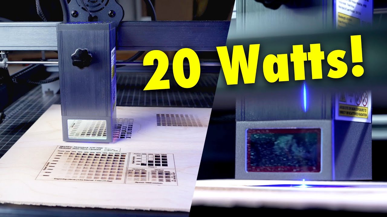

The marketing is all messed up on most of these because they quote the input power. AFAIK the highest power diode laser is 5w output and so you will only get more than that if they combine multiple emitters. The most powerful ones on the market right now are 20W output which combine 4 5w diodes. Xtools has one as well as Atomstack. They are pushing $600 currently. Here is a video comparing the two:
