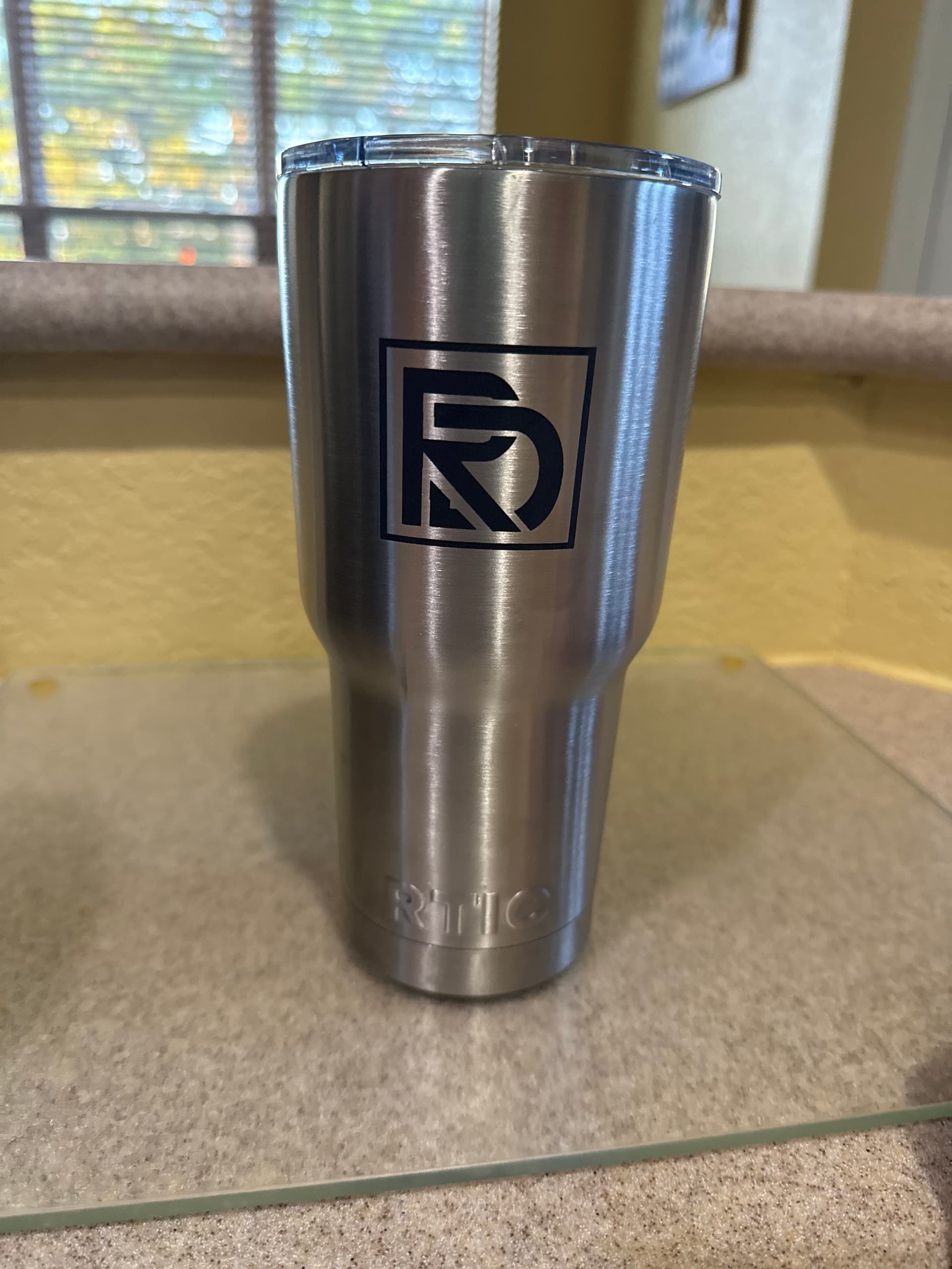

Anyone out here use a lot of Cermark style sprays or paste? I have done probably 500 total stainless tumblers and usually used Cermark Ultra spray. It’s $100 a can but does seem to stretch quite a bit further than the 13 oz Omtech spray. I do get similar results from both sprays.
So the question is this… has anyone used the paste, how much of a pain is it to apply and do you get good results? I don’t want to sacrifice quality but I’d like to drop the cost. I can stretch a can to about 75 tumblers (double sided), meaning the cost is $1.35 each.

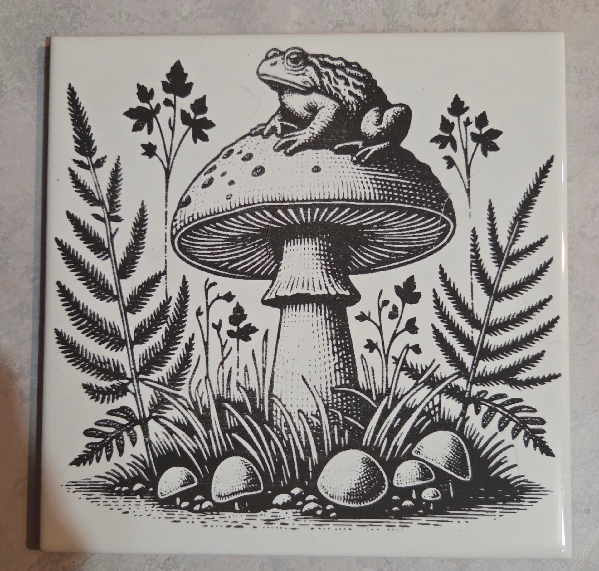

I have a fiber now, so I use LBT100 for porcelain tile more than metals now.

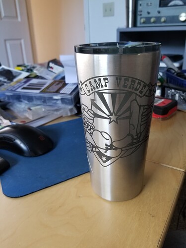

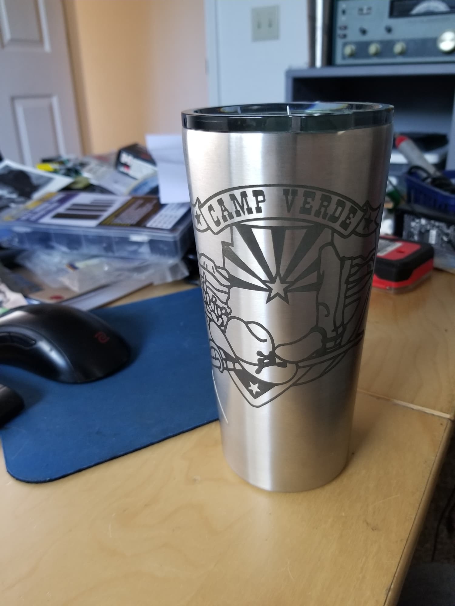

One of the things I wised up with was some colors or markings disappeared when viewed at an angle. Change some of your parameters for a bit more heat seems to mark them dark and doesn’t change on viewing angle.
I haven’t done a lot of mugs with the fiber, so I don’t know how varied the stainless is from batch to batch. I know changes in source seem to effect how well I do marking. Something is different.
Most of the mugs I have used the LBT100 coating, very nice blacks.

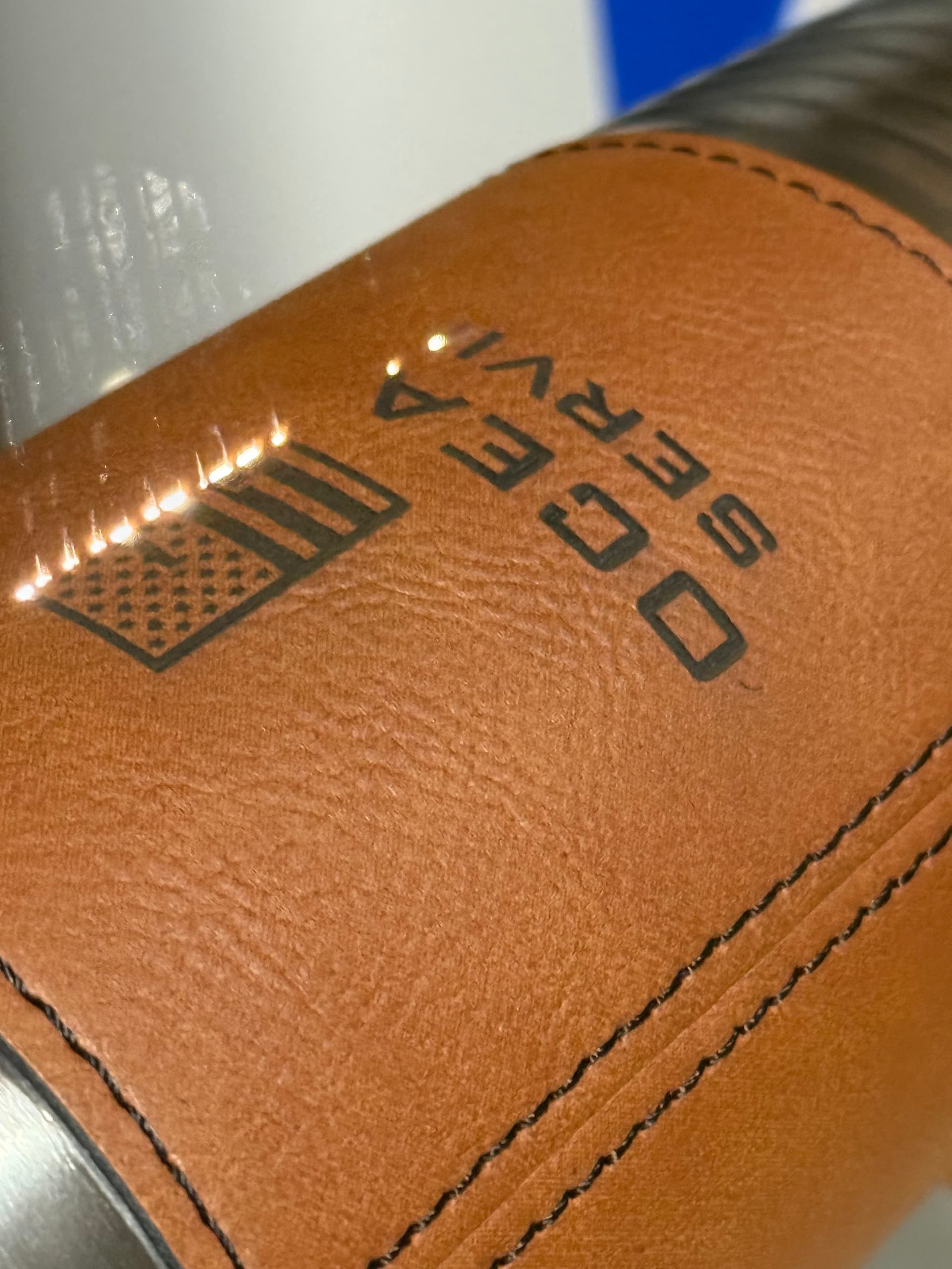

It’s super easy, soak in water, apply and burn
Doing 100 at a time, I like to streamline the process as much as possible. :wink: Maybe it’s easier than it looks!

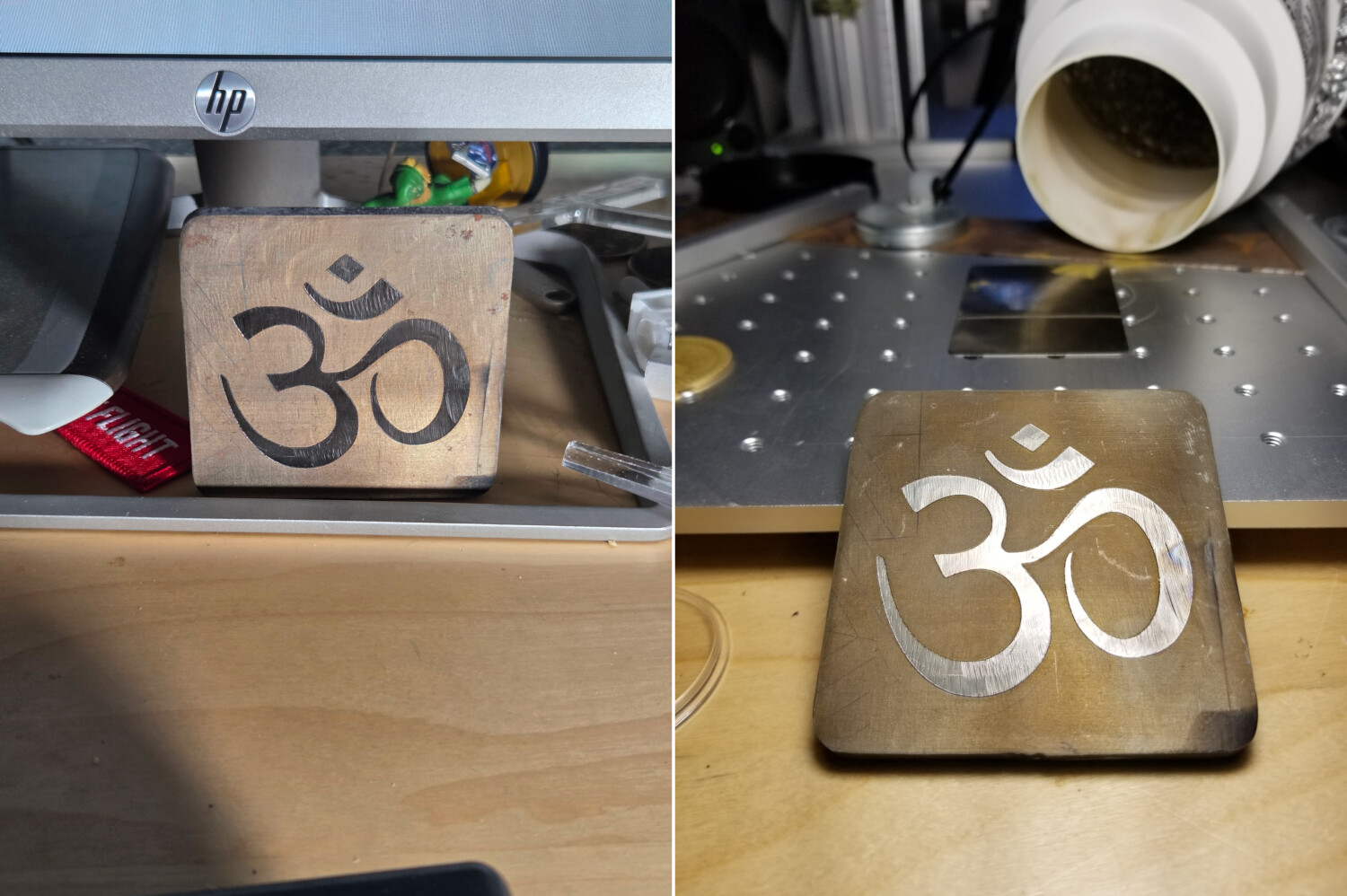

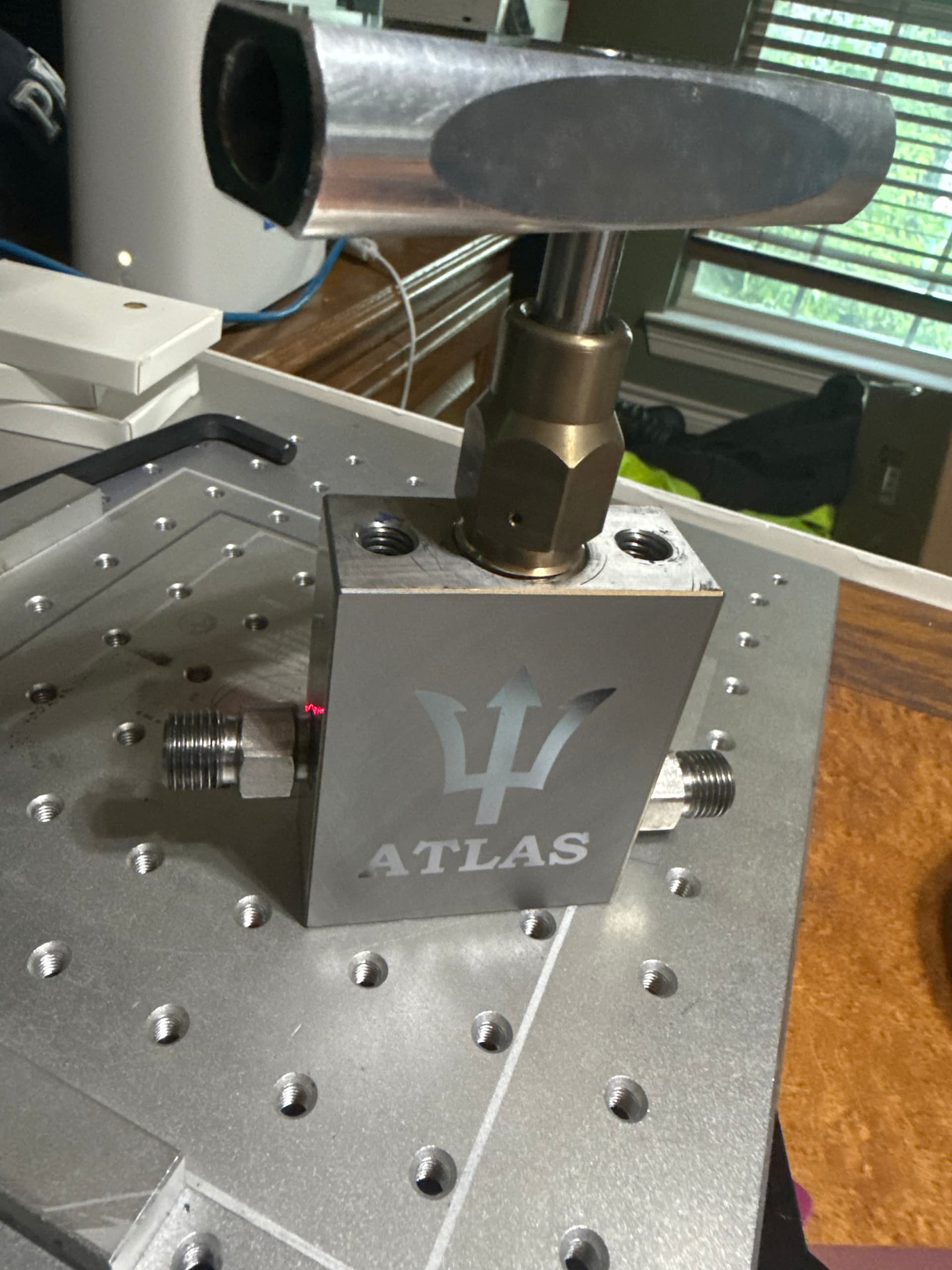

I may make another run with them, trying to anneal them rather than dig into the metal so below is what I get, though that’s Nitronic 60 so not the same 316 stainless.
Can you feel it? I have this Om (sanskrit) on a piece of scrap steel. I can feel it, but it seems pretty tough. It’s not engraved, it sticks up..?

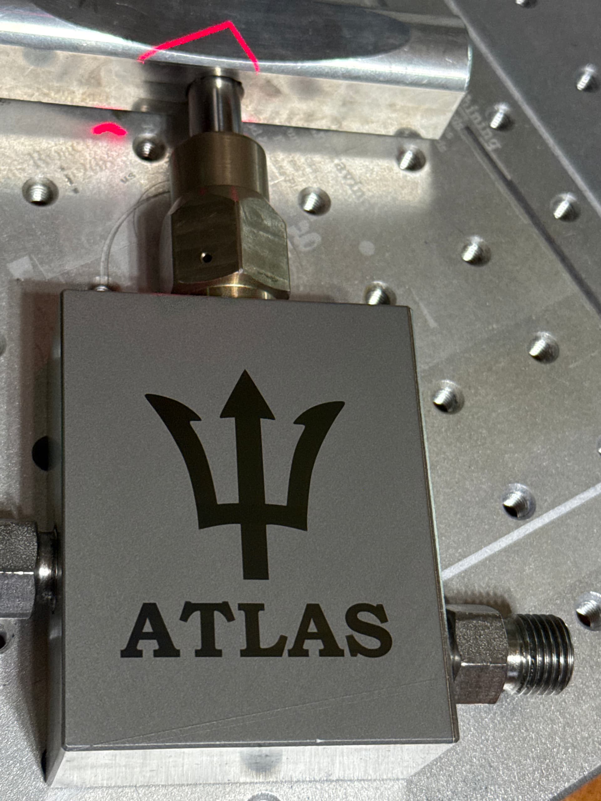

I can only feel it being a bit more smooth. The valve I lasered has to hold up to corrosion and rust, which really doesn’t apply to Tumblers I suppose. Maybe I’ll spray them with citric acid to passivate them a little… think I’m going to try again. The other problem I have is I suck at doing stuff on the rotary with the fiber laser, I need to spend a day to perfect it because I can always see my lines between slices. My leather ones come out ok, but anything on stainless has lines… I’m a newb at fiber laser with rotary. LOL

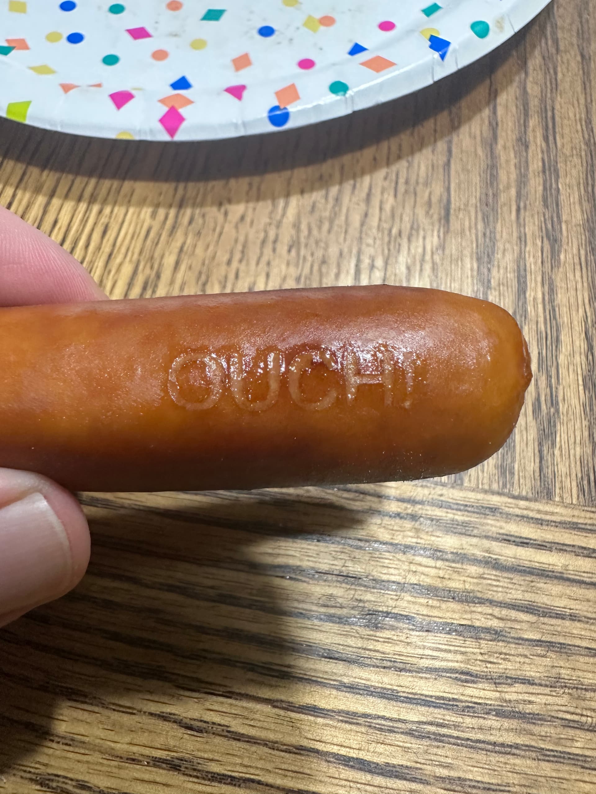

I always wonder what you’re actually lasing. My fiber won’t mark meat, bread or baloney. As a general rule they should not work on skin… :thinking:
It’s leatherette… but I did laser a hot dog with the fiber laser! Didn’t make it black but it did cook it. :smiley:
Wonder what it heated up…? :thinking:
