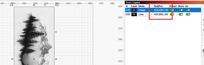

This recently just began happening. I created a project and pressed the frame button. Everything worked accordingly and framed perfect. Once I knew my power and speeds were good, I hit start. Then the laser moves towards the home and stops once it reaches the edge and beeps. I have attempted to use all (absolute, Current, and user) it all still acts funny and tries to go past home. Either way, it continues to frame the job pefect. Anyone have any answers and or direction?

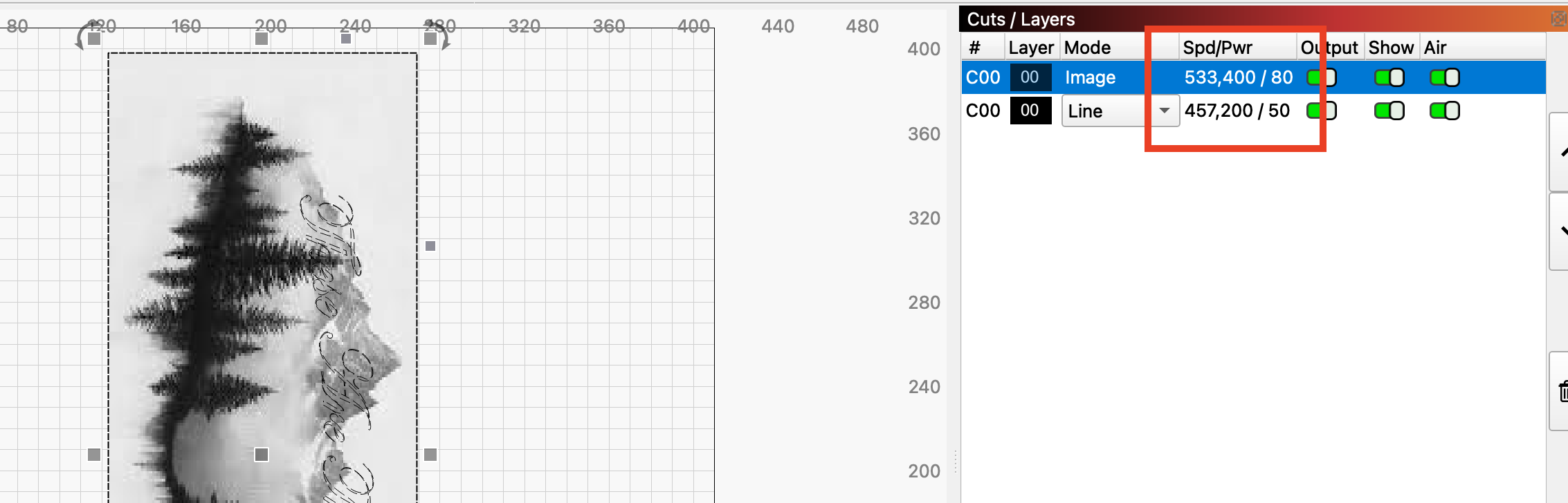

Your overscan is causing the laser to go out of bounds because of your speed setting.

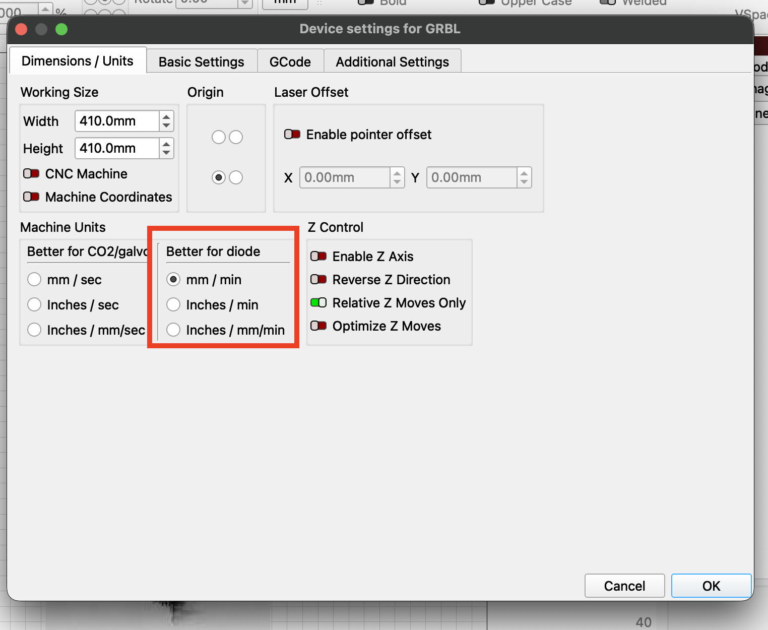

I would guess that you are set to mm/sec when you should be set to mm/min. Check your Device settings window, change to mm/min and then enter the correct speeds.
533,400 mm/min = 8,890 mm/sec., I think you probably want 8,890 mm/min.
Thank you so very much. That got the things going. I dont understand how that happened, however, it was fixed and I am grateful.
