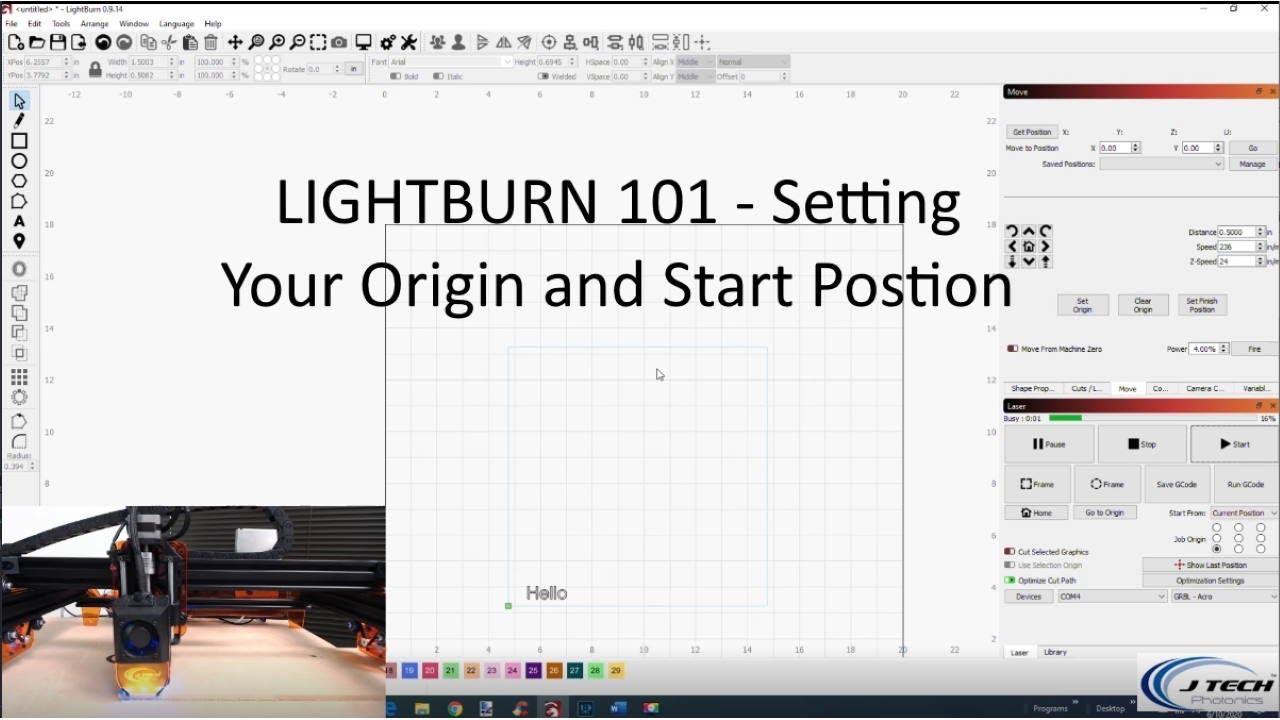

I’ve neve quite understood the settings under Start From: and Job Origin:.
This video explains it very well. One thing Learned from this gentleman is you should restart lightburn after you home the machine so the Get Position has the correct value.
That’s nonsense, to be honest. If you home, the laser should report its actual position right away. If it doesn’t, there is something wrong with the configuration. I never restart anything and everything works as it should.
Just watched that section of the video, and the guy obviously doesn’t know what he is doing. Absolutely incorrect, what he is telling.
This video is using a very old version of Lightburn, 0.9.14. That may have been a bug way back then, IDK. I didn’t start using Lightburn until version 1.3. He is mostly correct in everything else. Here is a video I produced with my take on the same thing plus a little more.

Yes, that might be the case. I would rather not discredit that user. I was just astonished that such incorrect information is in a educative video :slight_smile:

This video may have been out there for quite a while. Even though the Restart after Home may no longer be relevant I think the rest of it is a good explanation of Start From and Job Origin. Give the author a break. I appreciate the fact that he took the time to produce this and post it out there. I certainly learned something from watching it and wouldn’t complain because it wasn’t 100% correct. How many of you folks that are fussing about this have taken the time to do something like this.
Yes, I agree basically. Though dealing with user support every day, it’s really annoying that the same mistakes are done over and over, and at some point you notice that people refer to some famous video that just contains false information.
I know that it’s nearly impossible to edit YT videos after release, that’s a pity. On a written guide, you can just correct it, videos stay uncorrected forever.
That’s why I sometimes react allergic to wrong information in videos.
My most famous example is a setup video from Sculpfun, which tells users to flash the firmware to make the limit switches work. This was only true for the very first generation of lasers, and all following lasers usually break after this firmware is flashed. I get reports nearly every day that users bricked their firmwares. It’s really annoying to explain this fact over and over and people just don’t read, they watch and believe :slight_smile:
