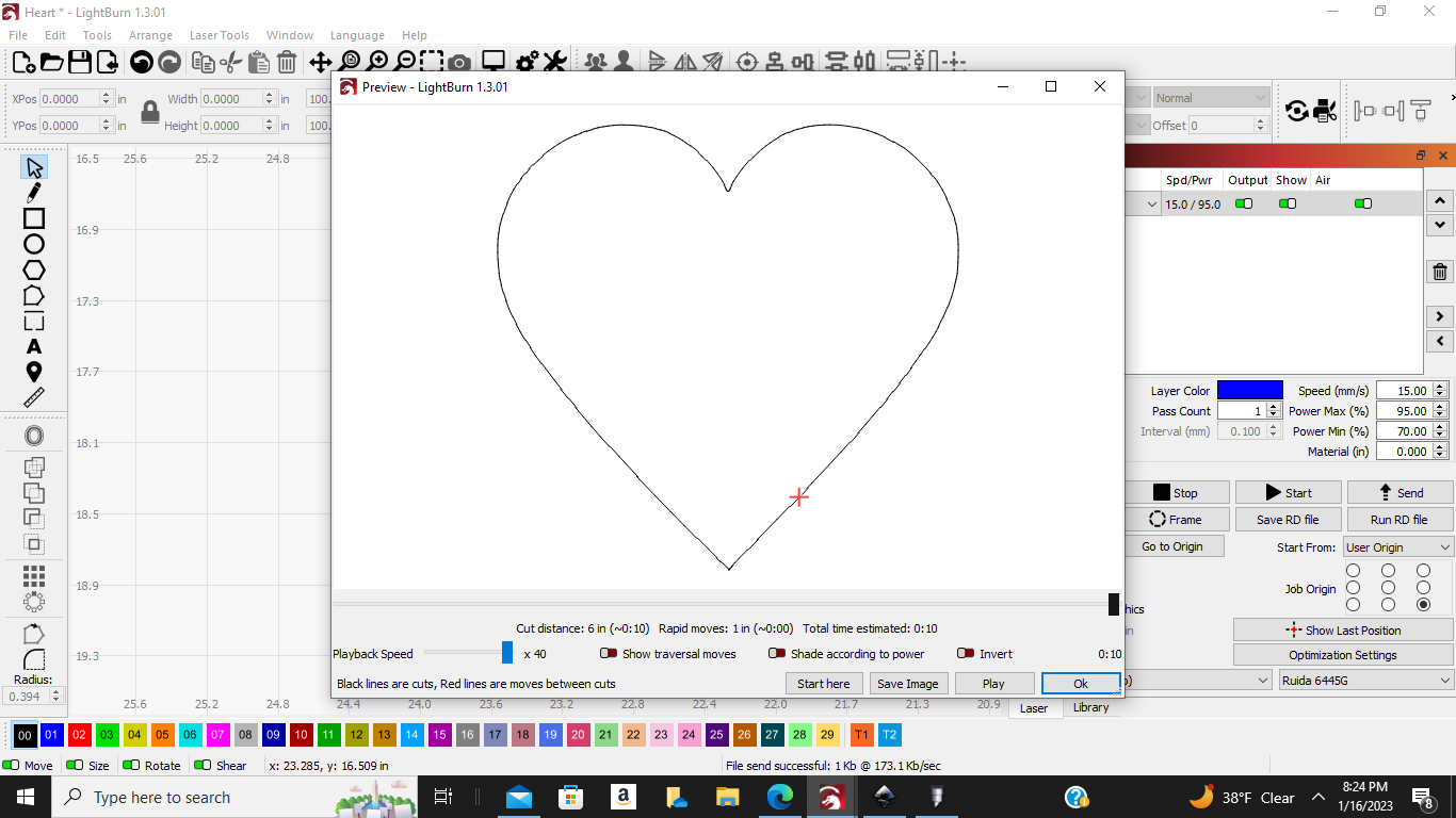

When i cut acrylic, there is a little indentation in the acrylic where the laser starts the cut. Is there a way to get rid of this or to change the starting point of were on the graphic the cut starts?
It worked and solved my issue. Thank you.
You can also use the 'lead-in/lead-out that starts the cut in a scrap area then cuts to the artwork.
Thanks. I like this option too.
