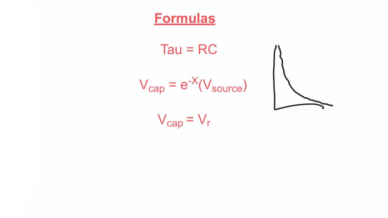

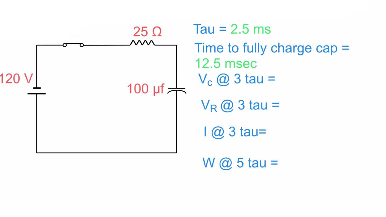

A capacitor is for use in an AC circuit. In a DC circuit, it will act as a resistor / block.
I don’t believe this is correct. You can have capacitors on a DC circuit. It was a polarized electrolytic capacitor. It is rated for 25 VDC.
I didn’t even consider that. lol sorry.
These two videos might help you understand why adding a polarized cap to a DC circuit requires some understanding of the resistance in the load (in this case your relay), where in the circuit the cap is placed, and the voltage in the cap (both upon charge and discharge).
@Stroonzo
I appreciate the videos.
One major difference was that the capacitor was place in parallel to the resistor, not in series.
