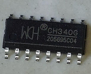

This little guy is responsible for the USB connection of most controllers:
There aren’t many brands for serial chips. The most popular ones are WCH (CH34x pictured above), and FTDI (mostly used on RuiDa controllers)

WCH (CH340x, used in most small diode lasers)

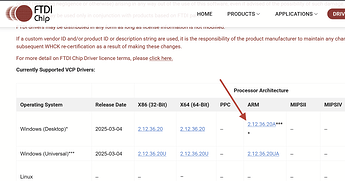

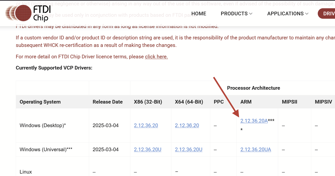

FTDI (FT232 for example)
https://ftdichip.com/drivers/d2xx-drivers/

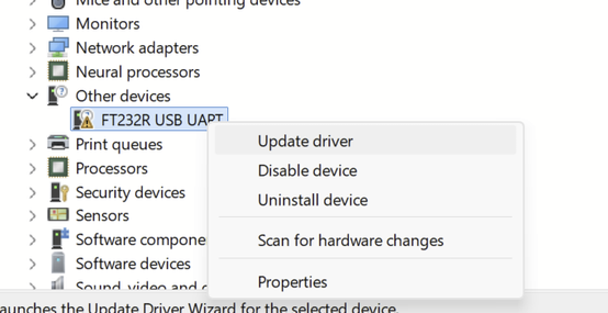

They don’t provide a .exe installer, so it needs to be installed manually from the Device Manager:
