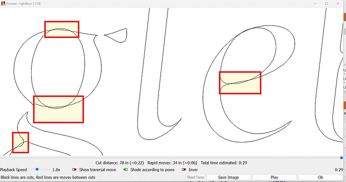

I was asked to create a stencil for an upcoming event, and the company provided their logos in an file. When I imported the file into LightBurn (v1.7.08), I ran into issues using the Preview tool.
Problem Summary:

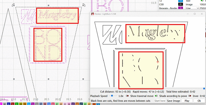

• The original SVG appears to have overlapping or crossed lines—especially visible in letters like “g” and “e” when zoomed in.
• These crossover points show up in the Preview but are not clearly visible in the main workspace, making them difficult to resolve.
• My workaround was to manually trace each letter using the Draw Lines tool on a new layer, then discard the original import.
Stencil-Specific Adjustments:
• My version includes tabs on letters like A, G, E, B, O, D to preserve letter integrity during cutting.
Suspected Cause:
• I believe the issue stems from the original SVG file—possibly due to how paths were created or exported.
• I’m unsure if there’s a cleaner fix besides manual tracing.

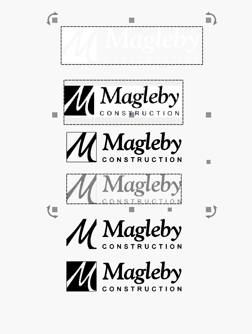

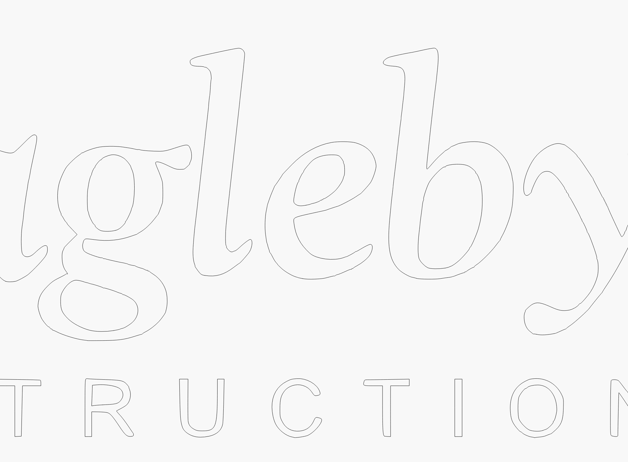

I may have misunderstood your problem, but as with this nice “original” logo you have, it is no problem to (auto)trace it yourself with much better (perfect) results in LightBurn.
Notice, 1,2 and 4 in my image are pictures, the rest are traced shapes.
