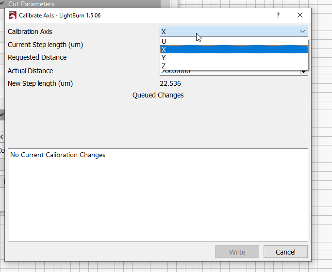

Hi, I need help with the stepping setup in Lightburn. For some time now I seem to be a little off on the dimensions, so I created a test square 100x100mm and it is. However, I don’t know where to set the correct step size. Can anyone point me to the correct calibration?

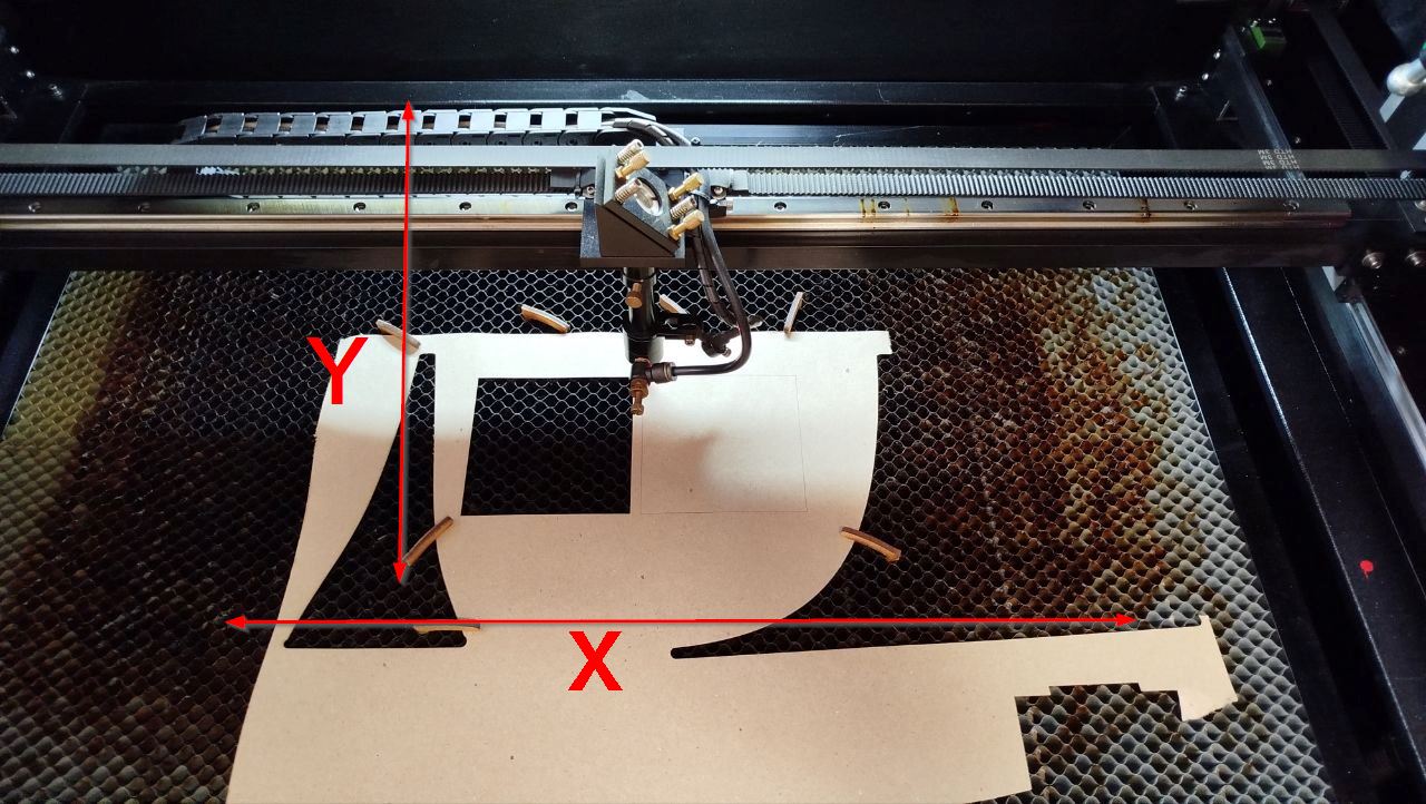

I think I found it. Just to clarify, I’m changing the X and Y axis ? The height in my case is Y, there I have a dimension of 99.1 mm.

If you’re measuring the cut sizes, you must measure and compensate for the actual kerf width.
It’s better to mark, not cut , a square on cardboard and measure the center-to-center distances between the lines.
