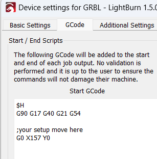

I see, well in that case since it seems that you are currently not able to completely disable the stepper timeout then maybe just set $1=254 and then your plan to include the home command and your setup move in the GCode Start Script is a good idea to try and minimise idle time.
I’m just not sure why you are getting the reset, maybe try rearranging the GCode slightly?
What happens if you change it so the G0 is not immediately after the $H, like this:
Or maybe it would make a difference to use a slower more controlled G1 move?;
$H
G90 G17 G40 G21 G54
G1 X157 Y0 F3000 S0
That is only 1/4 second. I doubt it will solve his problem. Maybe the vendor knows leaving the motors powered up will smoke them. I cannot think of any other valid(?) Reason for the change.

I tried your suggestion, and this is what I see in the console. The laser head moves to X157 Y0, and stops.
So it got further than it did before?
