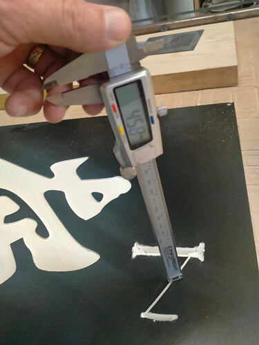

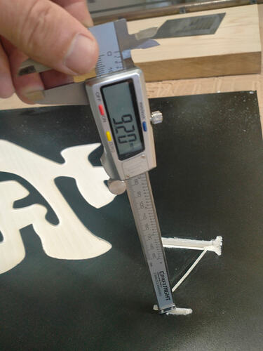

i now only do one operation , than save job close mm restart run next operation - repeat, im actually to scared to run a full job now will up load couple photos latter when i go out to shed
DO JO SYMBOLTO USE.mage (82.7 KB)
this file the symbol cut fine after tool change , i didnt notice it had buried so deep as had dust shoe on wasnt till it moved to wards 2nd letter did i see it as it ripped through the material
i also noticed lately that after tool change sometimes Z slowly descend on way to start point, as x and y are travelling
