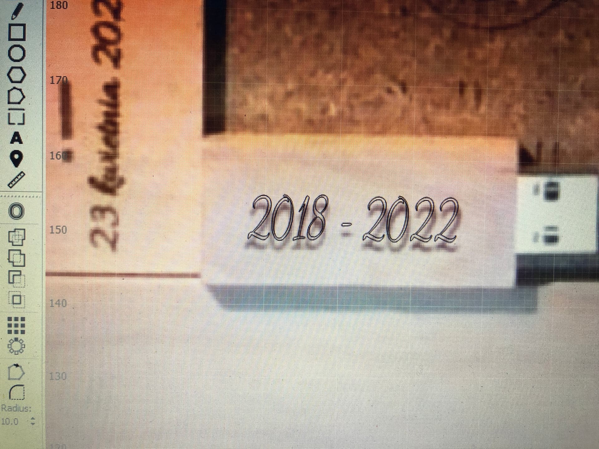

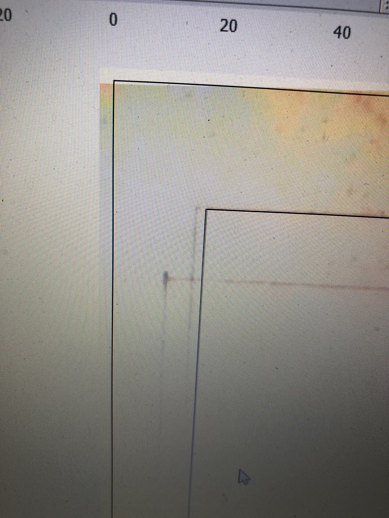

Hello. I still have a problem with calibration. The engraver is not in the design area. I do everything according to the instructions. The camera is rigidly mounted, it does not move. My laser is ORTUR Laser Master 2. After adjusting the camera in the X and Y axes, I will move the project higher and it will not hit again.

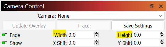

Have you tried using the controls in Camera window to fine-tune the overlay?
I did everything you write about several times. I tweaked the fine tuning in the camera window. After tuning it is fine, but when you move the engraving 10 centimeters higher, it is not correct
That means the tuning is incorrect. Have you corrected for width/height as well as placement?
How have you tuned it? I suggest you engrave a large rectangle that covers nearly the entire bed. That should allow you to get scale as well as placement tuned.

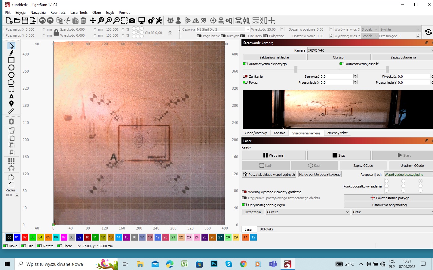

If you’re still having problems can you include a screenshot?
Can you explain the screenshot and what you’ve done?

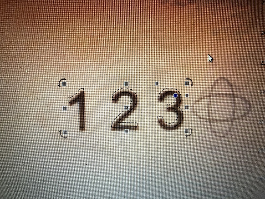

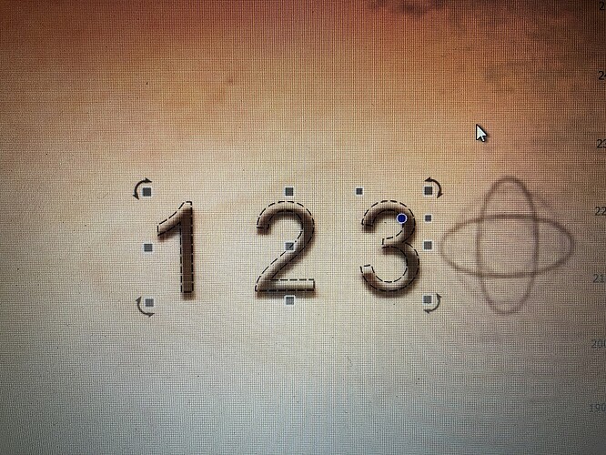

Now I have done once again, calibrating the lens and aligning the camera. The two circles in the center came out almost perfect, I did an X 0.5 shift and then engrave “123” and it’s a miss.

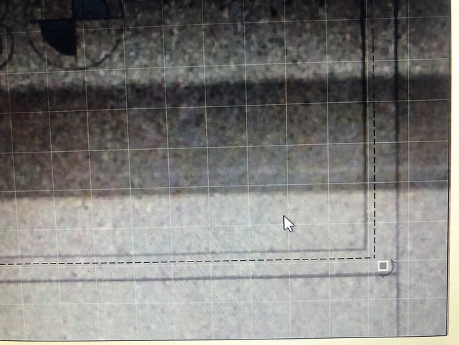

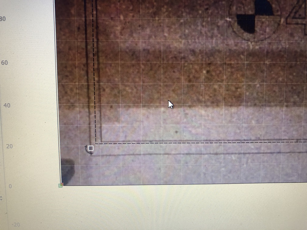

Engrave a large rectangle around the entire bed. Check for alignment and evaluate scale and position. Make adjustments in Camera Control window for width/height and X/Y. Recapture overlay. Repeat adjustment until engraved rectangle and rectangle in design overlap.
I think what may be happening is that you have a scale issue and just changing position may not be sufficiently correcting for the issue.

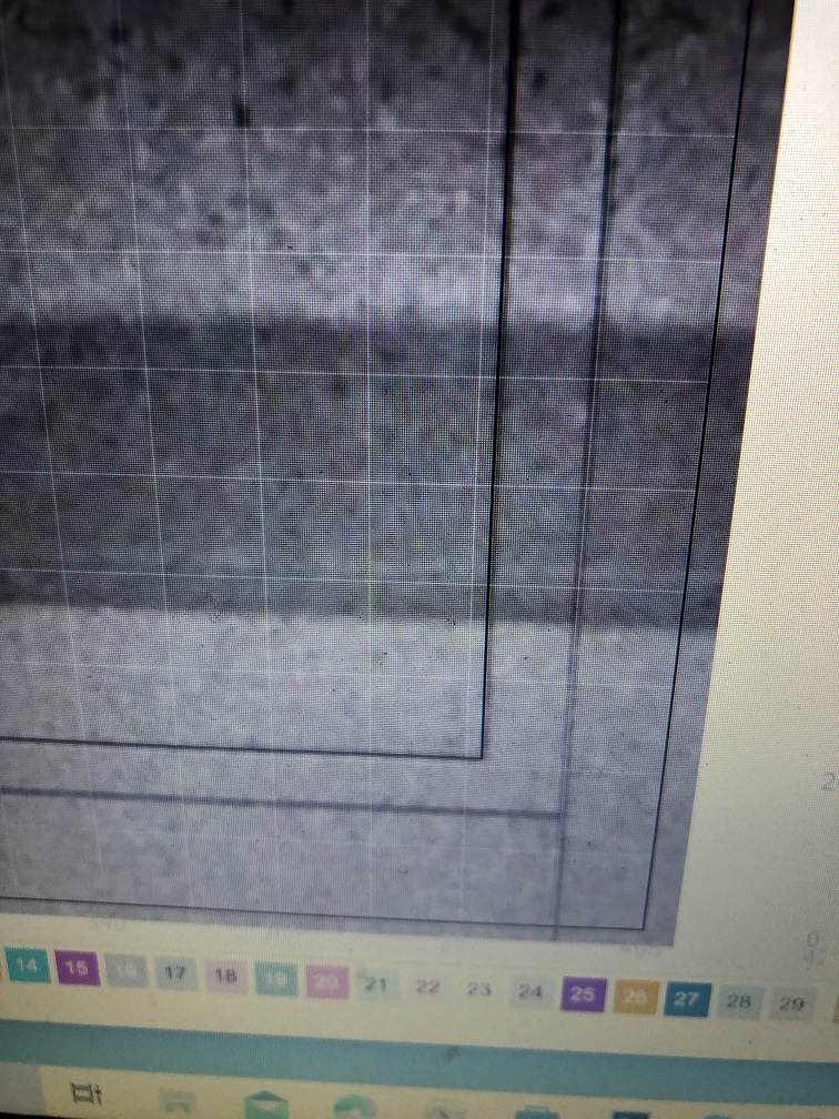

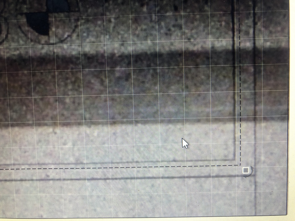

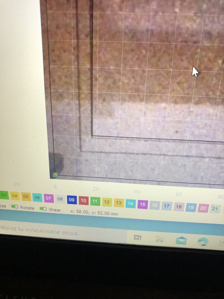

I did as you ordered and the square inside is slightly smaller than the design
Are you able to adjust the width/height as well as X/Y Shift to get the image to match the design?
I adjusted the size but it doesn’t match, as if there was a crooked square.
Image distortion likely means that your calibration didn’t go very well. What kind of scores did you get? How did you prepare the calibration pattern? You should try to glue the entire bottom surface of the pattern to a known flat material like MDF or foam board to help reduce any wrinkles or other distortion.
What kind of lens is on your camera? If distortion is inconsistent across the lens or the angle is extreme it can also have difficulty.
Can you measure how far off you now are? How closely can you align the design?
