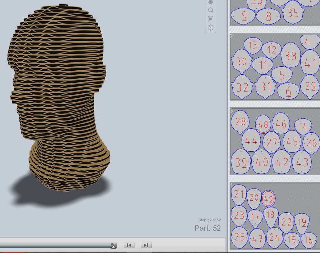

You mean like this? With self-nesting auto-dowel marks and assembly instructions?
this looks nice, what program is this please?
The best-kept secret since the Big Bang :smile: .
It was part of a collection called 123D, but Autodesk discontinued it and now has a slicer for Fusion. I don’t know if it has the same options.
123D Make can now only be obtained on the gray internet, but is and was free. I have version 1.6.0.

The Export tab can spit out SVG / DXF / G-Code and, AFAICT, at least the first two import into LightBurn. I haven’t yet carried anything through to actual cutting & assembly.
