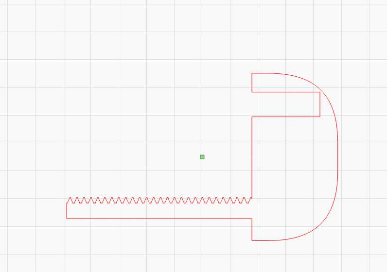

ok, anyway to fill in this hole so it doesnt cut that section out with in lightburn? technically its only supposed to be cut half way down the plywood
the rack gear slides into the slot. I can cut it out with a dremel with no issue, so i just need to fill that area.

If I’m understanding your question you should be able to fill that slot in a few different ways:
  1. Use Node Edit tool, hover over each node that you want to remove and hit ‘D’ key.
  2. Fill the hole with a perfectly sized rectangle, then select both the rectangle and the key and do Tools->Union.
converting to svg yes, but now its trying to fill that gap in lightburn
Okay great. Were you able to successfully execute one of the two listed strategies?
yes, i just figured out how to edit nodes in lightburn and it closed the loop easily. Now i have another issue that is making me want to throw my laser off the roof. Ill post that one next
