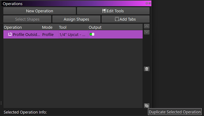

The Stock to Leave value is essentially adding a kerf to the project. It is not leaving additional Z depth, but instead leaving an allowance around the path on the inside or outside, whatever is defined in the Profile Operation window.

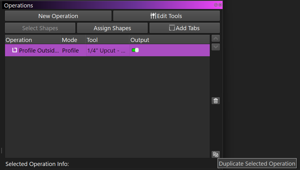

You must create another Profile operation to clean up the remaining stock - select the existing operation in the Operation Panel and press the ‘Duplicate Operation’ button on the bottom right of the panel to quickly make a copy, then swap the tool out and remove the Stock to Leave.

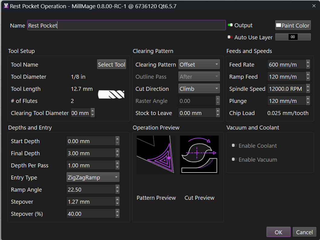

Or, if you’re just looking to clear up the remaining material in a pocket, you can use the Rest Pocket operation. Otherwise, sticking with the Profile op is the way.
