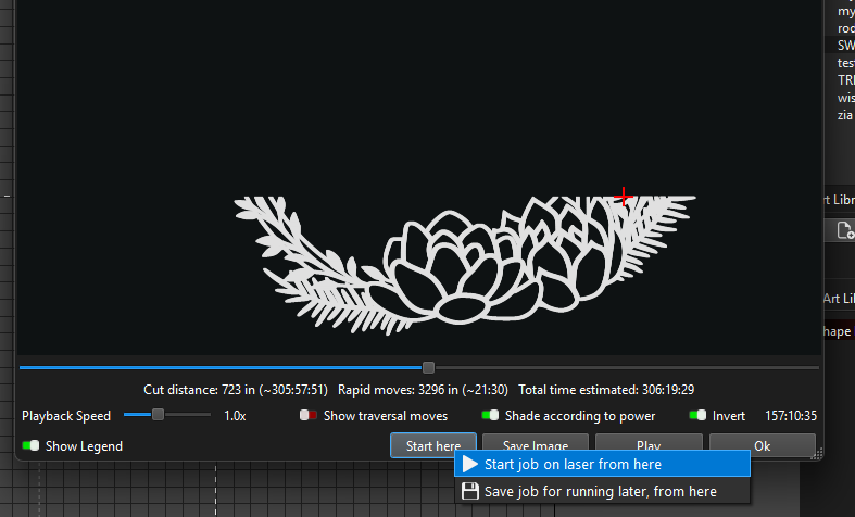

Go to your preview window. Use the slider to move the progress to where you want to start the job again. Click on Start Here, then start job on laser from here
As long as you have not moved the piece or the laser head, it will line up for you. You may need to re-home for best results.

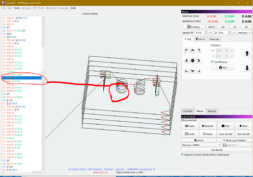

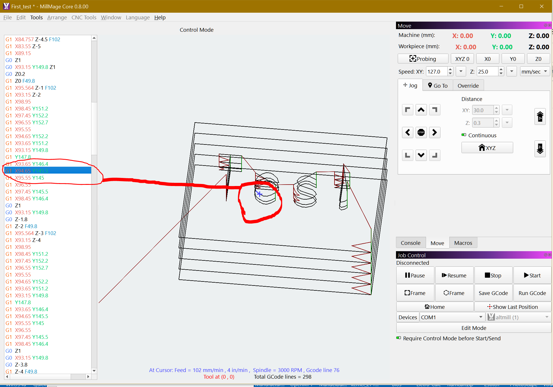

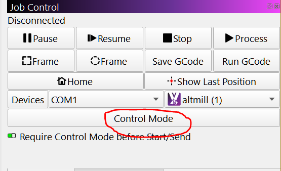

If you switch to Control Mode :
And click left GCode window line or middle paths you can correlate the points
