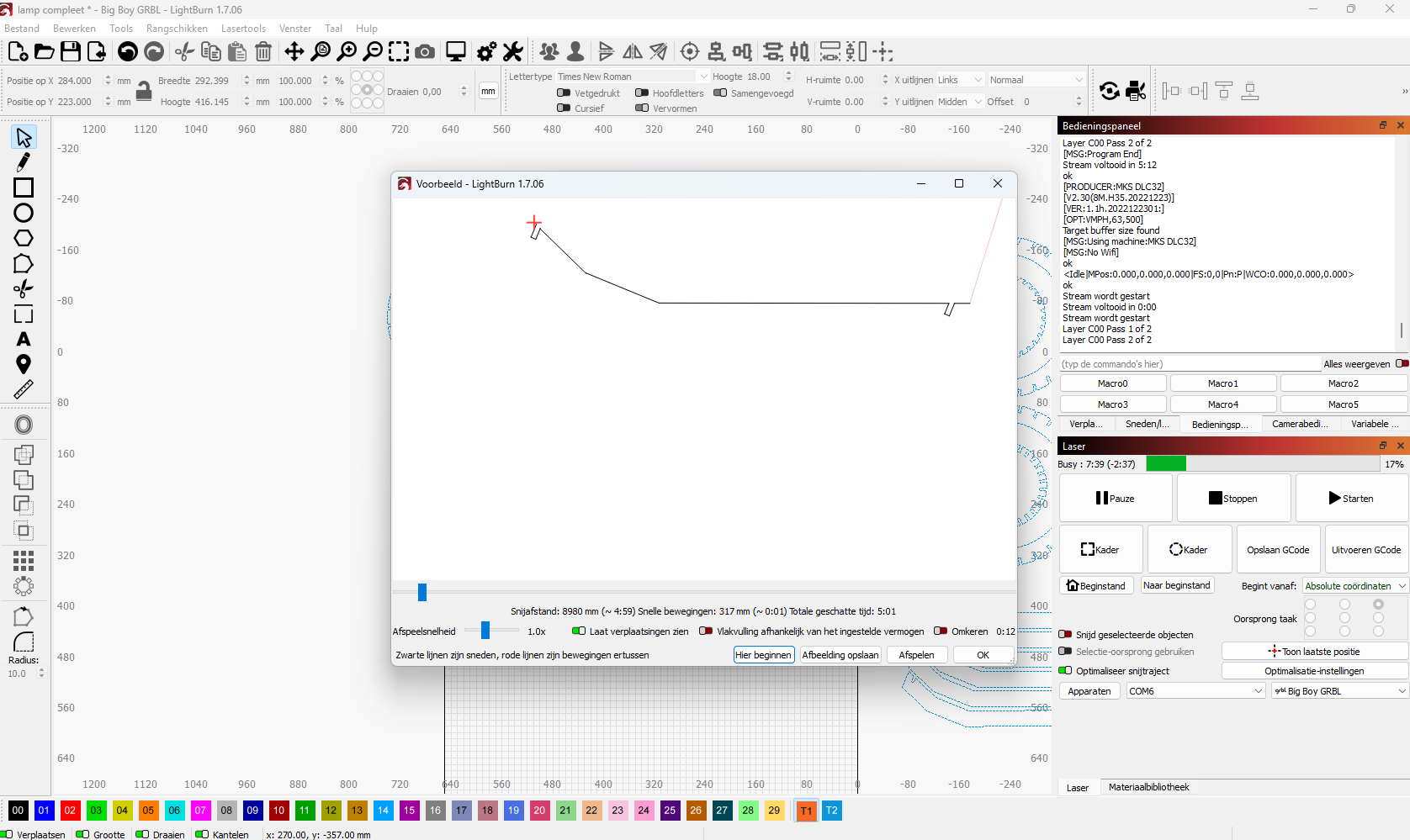

I have been building a machine with a dlc32 board and a 50W co2 tube.
Ran a few projects succesfully but I have a reaccuring issue.
With one job it keeps stopping at the same point in the process. Lightburn stays “Busy”

It could be in the code sent by LightBurn to your laser.
It could be the laser misbehaving when sent properly formed code.
To troubleshoot this, I’d compare the project file, the GCode and the repeated point of failure to start taking the problem apart.
If you’re willing to share them, I’d like to look at the files. You’re welcome to share the files publicly here by dragging them into a reply to this thread. If you need to keep them private, you can send them to me privately here.
In LightBurn, click File, click Save GCode, and save that file somewhere convenient.
In LightBurn, open the Preview window. It’s the ‘flat panel monitor’ icon along the top row. Use the slider bar to locate the point where the project stops and capture the screen.

Open the console in Lightburn and see if the controller is giving you more information. It may give you a gcode line that it failed.
The console is in the cut/layer area and the console tab might have to be selected in the Window menu.

Hello @JohnJohn and @jkwilborn,
It does happen 50% of the times at the end of a job where it stays on busy.
But after the last lucky fix it happened again on the file I opened this topic about so attached are the files you requested. Hope we can find an issue I can fix on the machine or the software!
