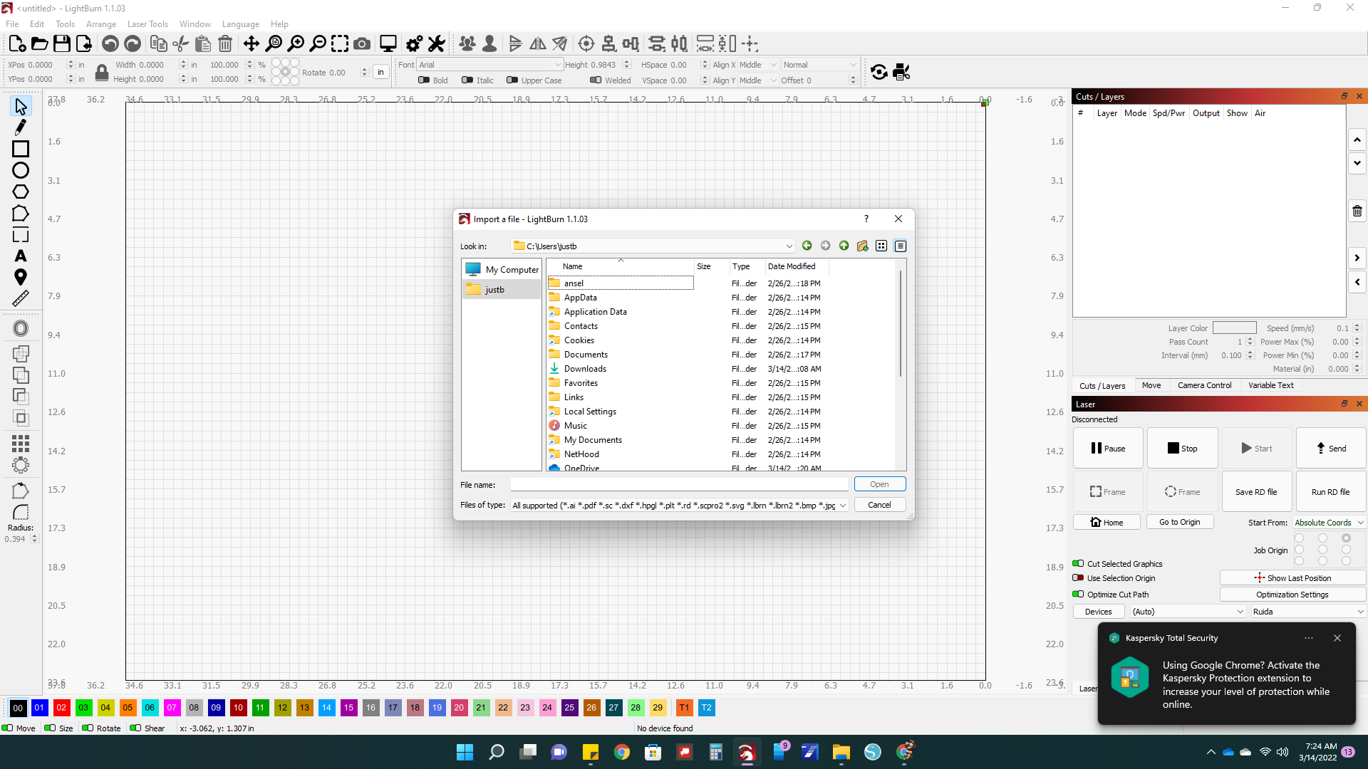

Strange file dialog shown in 1.1.03 - how do I change this?
What happened to lightburn when it updated? Ive tried uninstalling and reinstalling, i’ve tried rolling back and it still does this.
Windows 11
It’s not clear from the screenshot what you’re referring to. Can you describe the issue that you’re experiencing?
yes as PY said we need more info. your not giving us much to go on here.

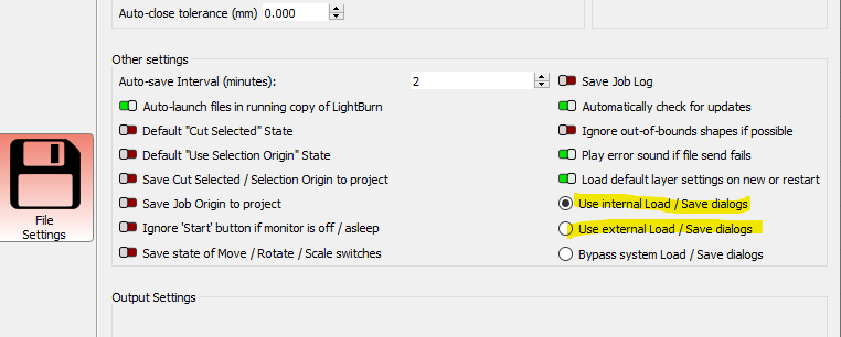

Assuming you’re talking about the simplified file dialog, that’s just a setting in LightBurn. Go to Edit > Settings, click the ‘File Settings’ button, then choose one of these two:
It looks like you have the 3rd option selected.
That worked thank you so much!
