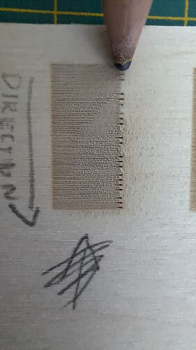

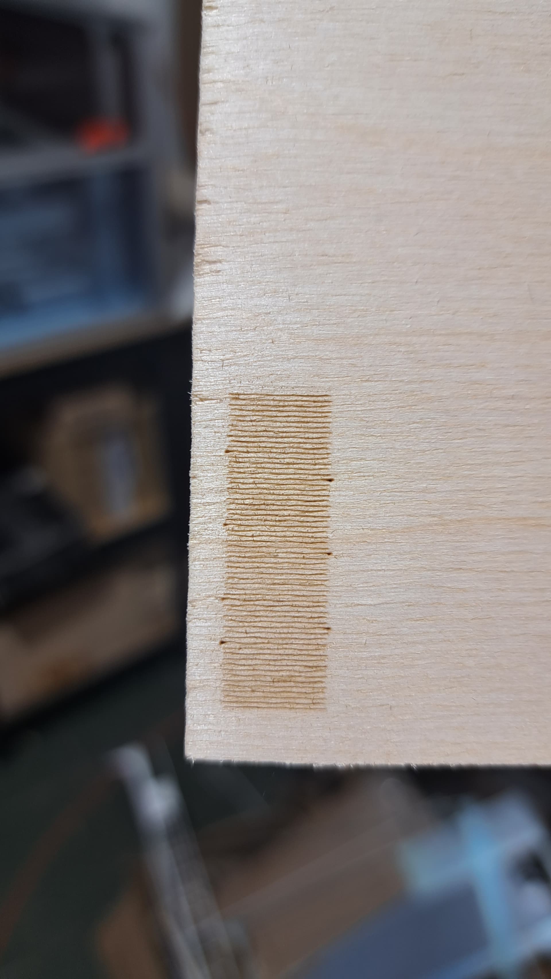

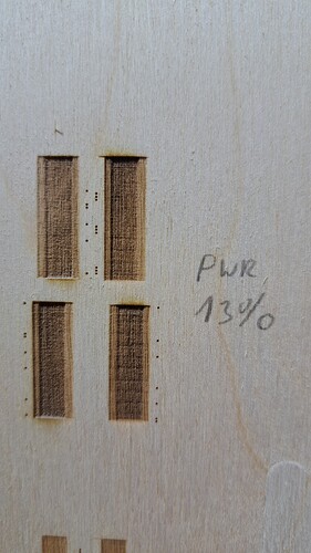

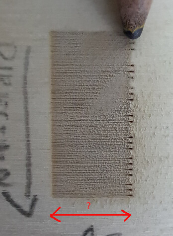

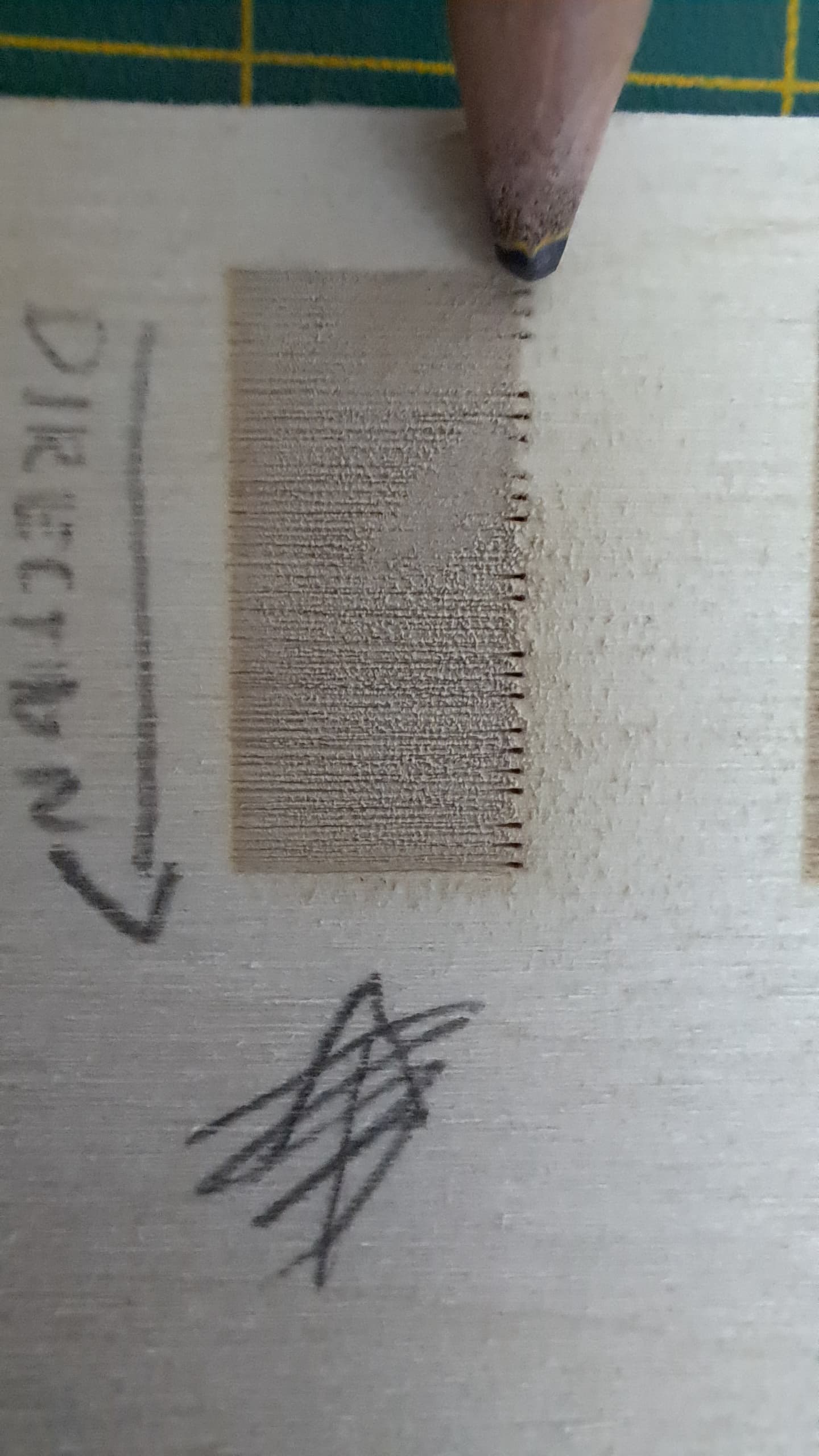

Strange marks on engraving surfaces
BINGO!!!

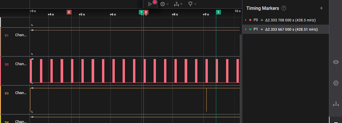

Watch this:
Saleae helped a lot :grin:

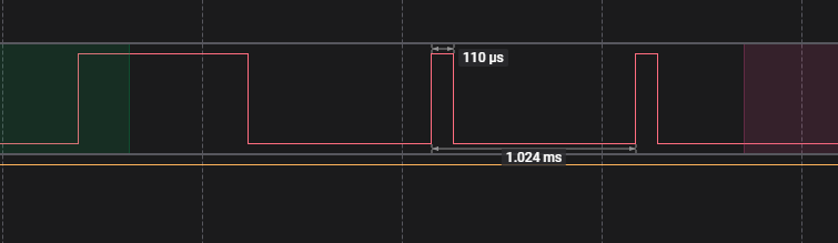

Tests had been done with wave analyzer connected to the cables near the LPS signal input.
As I mentioned before, there is regularity…
interval of 2,33s between 2 faults
Here is representation of this fault on engraving:
Can’t send whole Logic 2 file…
Glad, that it is a firmware fault, not hardware issue.

If it’s less than 4mb, you can append a .txt and post it… I’d kind of like to look at it. If it’s larger than 4mb, then move it to something like a google drive and post the link. Ensure you set the protection levels for all with the link to have read access.
PWM comes from the controller, no matter what OS you’re running on your pc. What makes this odd, is that, having programmed the 328p, you’d have to go through a lot in software manipulations to have this occur. What I’m trying to say, pretty poorly, is the firmware would have to be doing this on purpose… I doubt it’s a hardware issue, but since you’ve used multiple Arduino’s I think we can eliminate that.
I’d think it’s have to be firmware related. Since I don’t know how you managed to trap this, I don’t know really what to think… It’s something I haven’t seen before.
If you try a different controller, maybe, but I doubt it. Using transistors where everyone else isn’t doesn’t seem a logical approach.

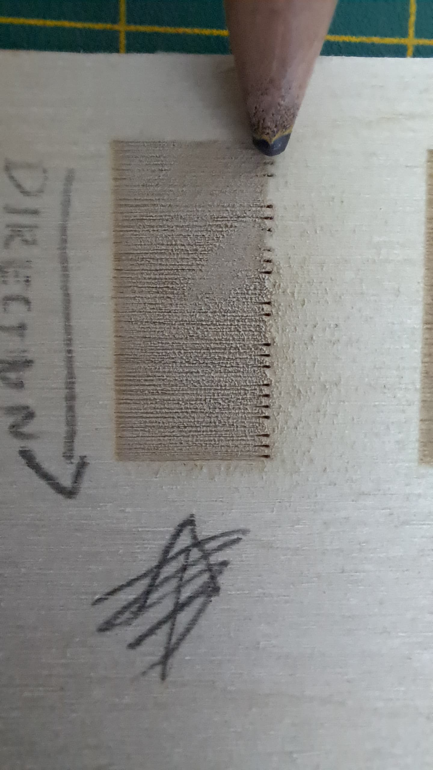

What I meant was what direction is the head moving, not the Y axes. Are you sure you’re reading it correctly?
I was only editing homing cycles in config.h 3 months ago when I started to play with CNC. When I was trying to remove that sticking I have modified some code in spindle_control .h or .c but it hasn’t changed anything. Now I downloaded ā€œclearā€ version of GRBL from github without any changes, maybe the changes I somehow applied to GRBL are still in Arduino’s memory like $$ settings (dimensions of machine, masks, steps per mm, velocities).

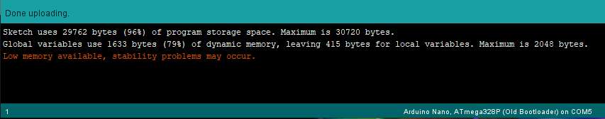

Additional information: I was installing GRBL by adding it as Arduino library and then using Arduino IDE to run this command: #include <grbl.h>
Still don’t get it… If you are thinking about laser head, it is travellig as in GCode here:

I also installed GRBL on Arduino Nano and still the same issue with GRBL from github repo. While uploading, there was information that Arduino may be unstable due to low memory. The ATmega328P is not enough?

Assuming the head is moving along the X axes, it has to be going or at least starting in a certain direction. The gcode isn’t usable as far as looking at the preview and determining head direction.
Are you running with bi-directional fill enabled on the edit pane?
I think we’re going to the wrong road here, too many things don’t make sense. It should work as is without you having to jump through hoops.
I suggest you re-run the original with a larger interval, this will give us a better idea of what’s going on and maybe a better place to look. It would be nice to be able to see each scan line. Use bi-directional engraving and lets look at it again. You’ve gone through a number of controllers and it hasn’t made a difference, so I think we’re looking at something incorrectly.

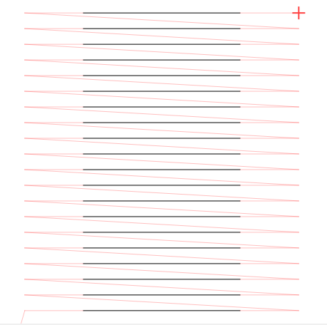

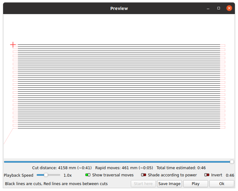

You’ve covered up the start of this with your pencil… I’d like to know if the first line is going left to right or right to left and make the lines further apart, increase interval to something like 1mm.

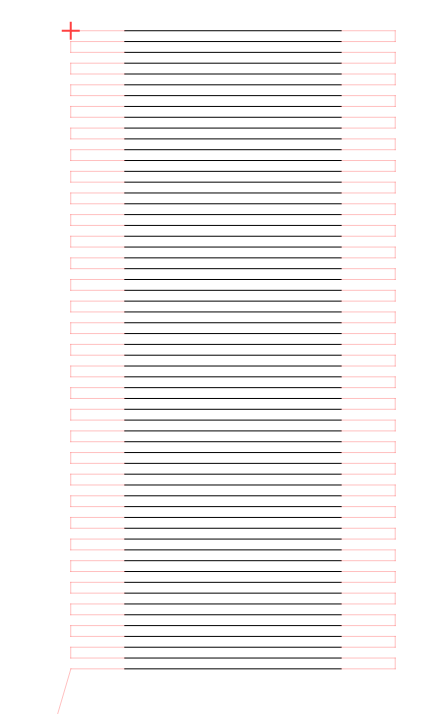

This is the preview showing what the head is going to do on a small box engraving, with bi-directional fill enable.
You can see the head travel and where it changes direction. Can you do the box again with a larger interval and include a photo of it and the preview from Lightburn? Leave out the obstructions, like the pencil.
This will give us a better visual, otherwise I think we’re going nowhere.

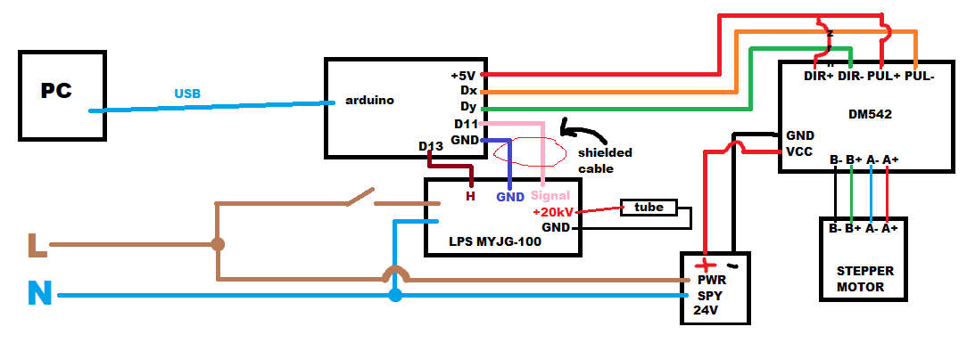

Laser control signal integrity/interference on PWM line would be my first guess. By the character of it and the fact that it appeared on the beginning of the burn where motors have boosted current. My bet it is interference on laser PWM signal.
Symptom also consistent with observation that USB1 has shorter lines than USB2 as it will feed controller slower that in turn will limit speed of the motion, thus shorter streaks.
  • Your own proposal to use shielded cable for laser PWM is a good one. Try it.
  • Make sure motor cables are not in the same bundle with laser. Make sure cabling is neat, properly twisted.
  • Use good and clean power supply, especially for the laser.
  • You may try to just reduce motor current, that will also reduce boost current, maybe just enough to eliminate that interference.

Yes, engraved lines are on the X axis, and the laser head on this photo is moving from right to left:
You can asuume, that this photo is upside down in comparison to Lightburn preview. My bad that the photo is not legible but I wanted to indicate the faults with this pencil…
Here is simplified preview with changed 0.1mm to 1mm density of this box:

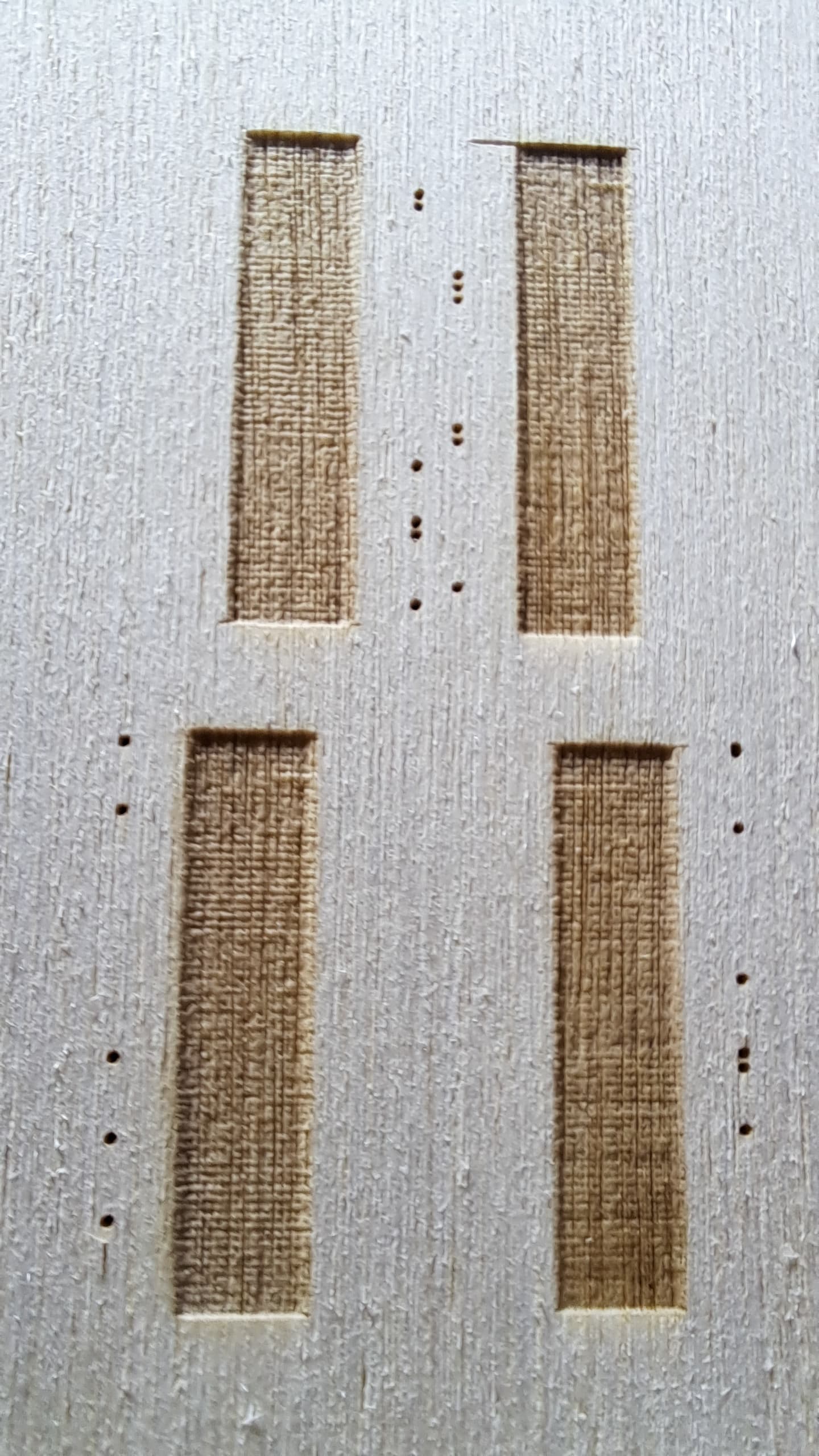

Test this file as is.
test_square.lbrn2 (394.3 KB)
Change black layer to 13% power and repeat.
Post both outputs.

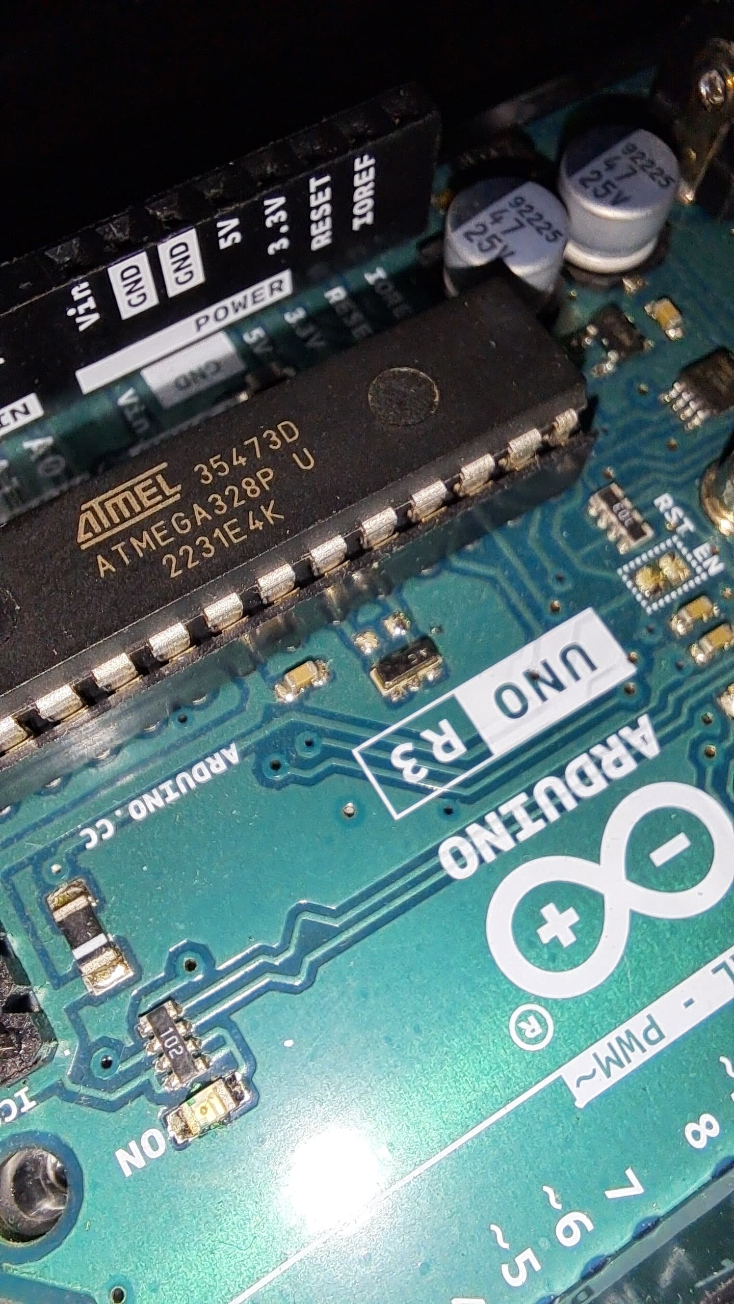

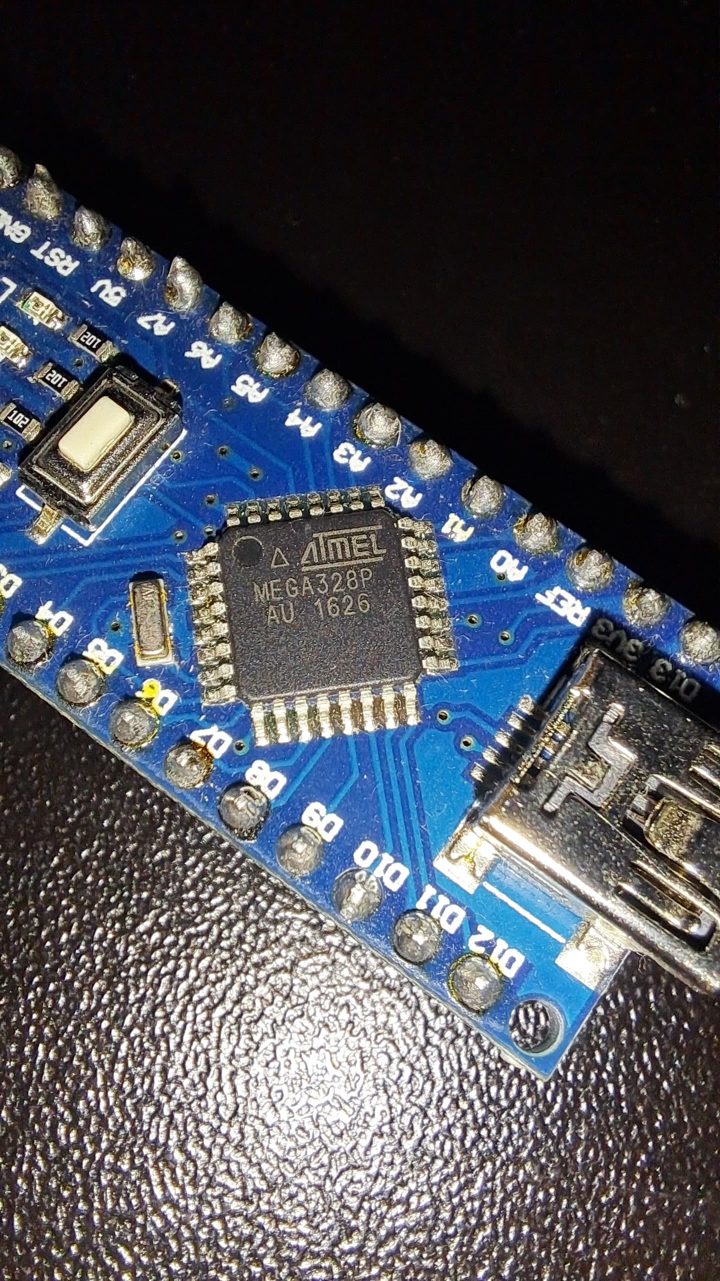

  1. What hardware are you using? What board?

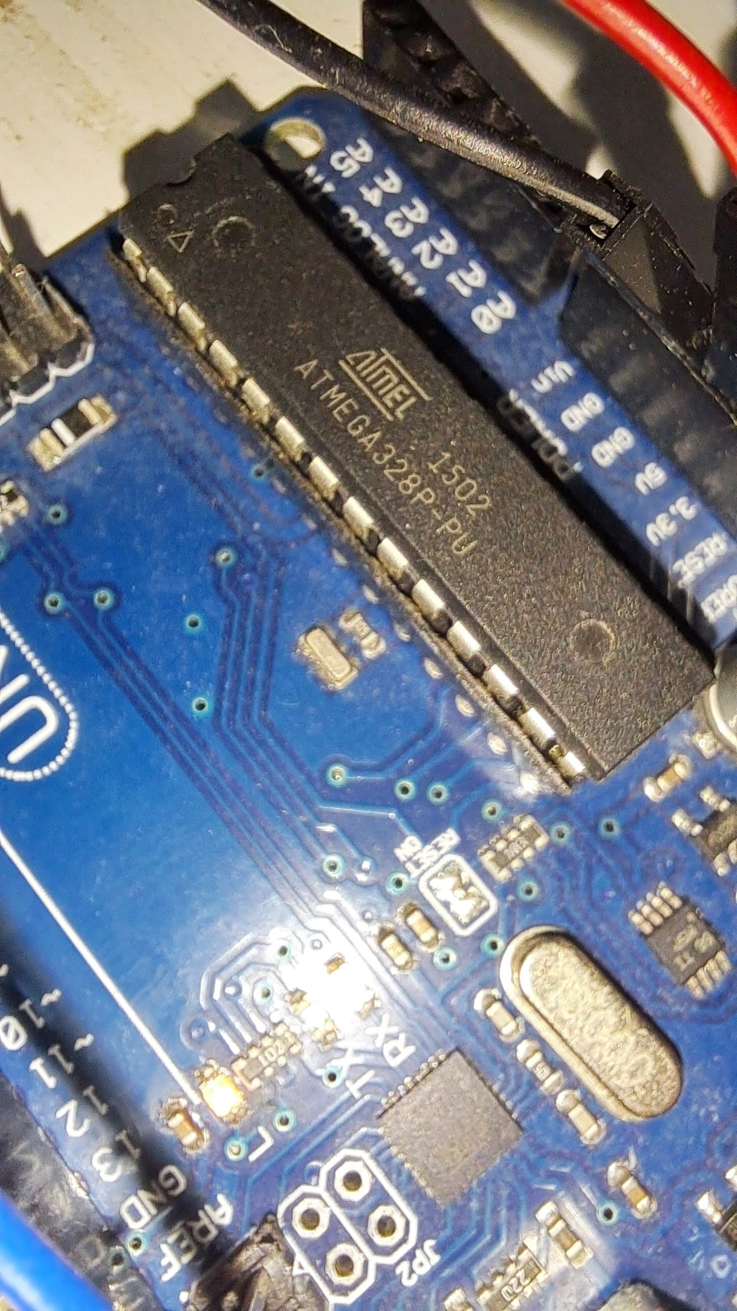

  2. I guess if you are able to use original GRBL code then it is based on ATmega328? Is processor original or Chinese copy? (hard to tell) Have you tried different lot parts?
  3. Can you provide images of your board and wiring to the laser?
Yes
No, I download source code and do a library from it, then use grblUpload from examples.
No, it’s not producing different results, downloaded newest version, installed GRBL, the same issue.
  1. Arduino Uno original, Uno clone, and Nano clone.
  1. On chip on my Arduinos says ATmega328P. Rather impossible that original Uno and clone Uno are from the same production line, but who knows, I wouldn’t be surprised if they are.
Wiring schema (doesn’t make sense posting it imo, the problem lies in the Arduino or firmware or other things correlated to firmware or arduino itself, however, with this connectios everything is ok except faults while engraving. I bet the same fault wave is generated while cutting material, but it is not visible)
Photos of Arduino boards:

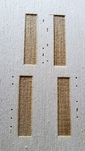

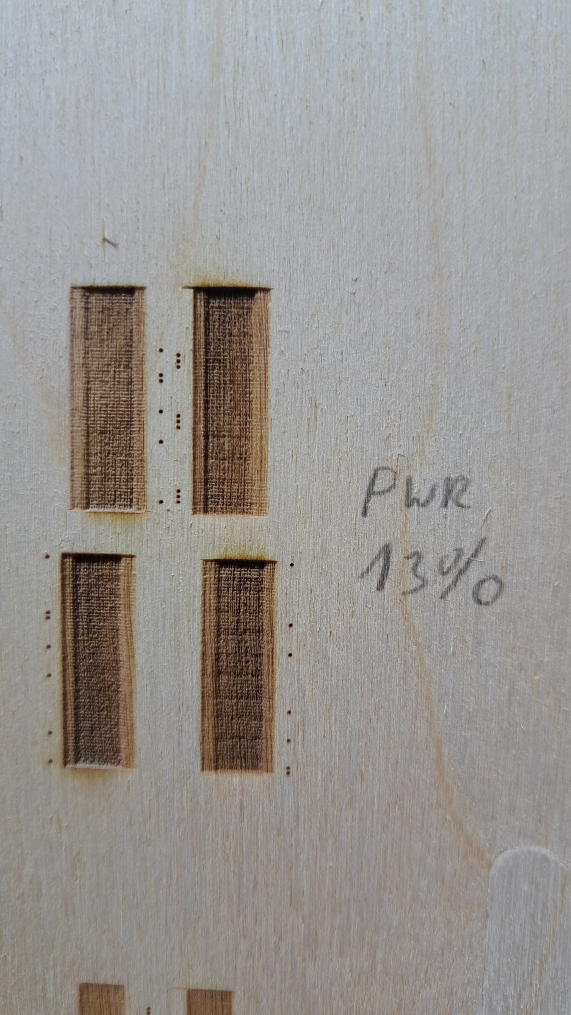

How did you create that GCode? That’s genius! I am impressed how you managed to create that faults in separation to engraving.

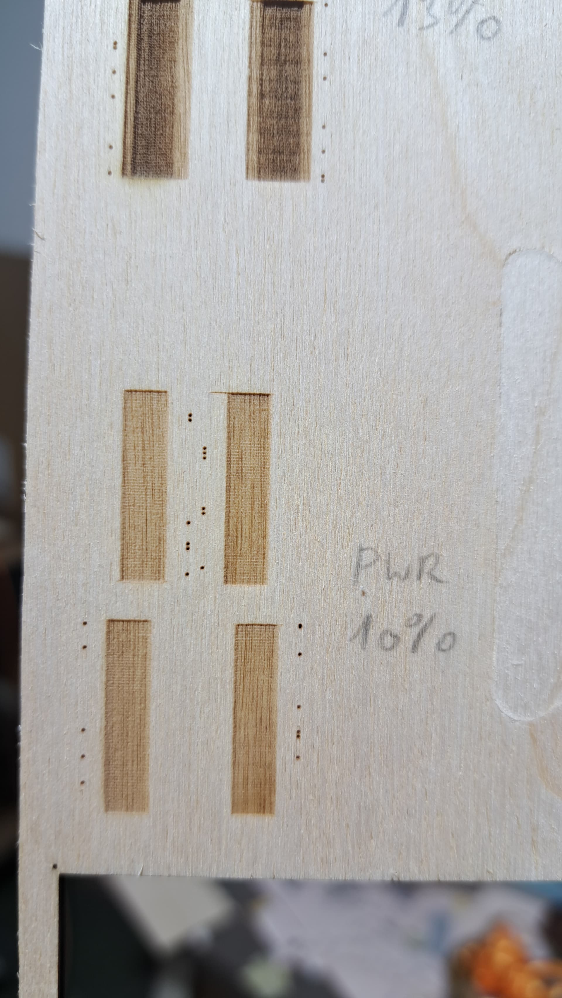

10% power:
Saleae Logic 2 file with PWM signal recorded for 10%:
13% power:
Saleae Logic 2 file with PWM signal recorded for 13%:

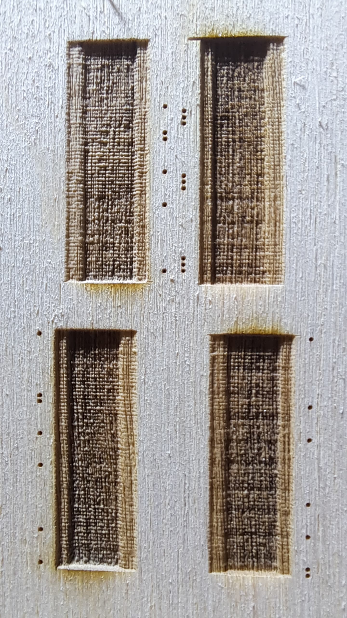

Interval 1mm, 150mm/s 10% PWR, bi-directional fill enabled, box 10mm x 30mm.
Saleae Logic 2 PWM live file:
Did you try flashing 1.1h with LaserGRBL program?
Something strange, your laser didn“t ?? engrave the lines I left on the black layer
or they are hidden ??
The blue layer was at 0% power and seems engraved.

I engraved it without changing anything as you suggested. One change was to set 10% to 13% as you guided.

This configuration requires more performance than an 8-bit microcontroller teleported from the 1990s can provide. At the start of each line, the controller turns on the laser, then stalls with an empty command buffer, with an additional delay to parse the next command to arrive.
The stalls depend on how full the buffer was immediately before the line starts, so they’ll tend to become more-or-less regular as the pattern proceeds. Longer engraving lines will produce more regular results, although they’ll never tick along like clockwork.
The unidirectional results in that post show the overburned sections align with the start of the adjacent correctly burned lines, so the overall timing is correct.
The waveforms in that post confirm the problem: the first pulse at the start of the line is grossly too long.
Using a 32-bit microcontroller from the current millennium should improve the results:
