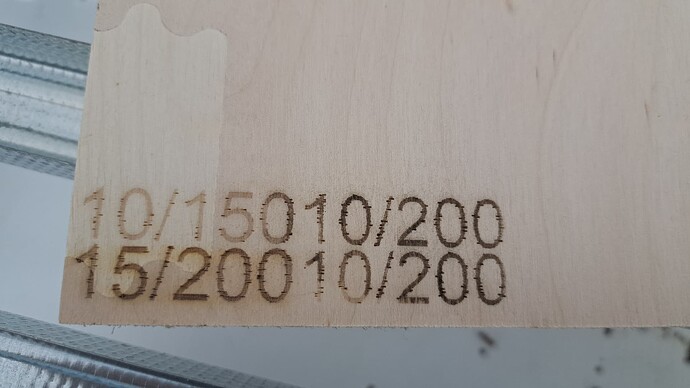

Hello guys!
I have a strange marks on engraved surface. As you can see there are overburnt blops/points that are out of the desired engraved surface, which destroys the whole look of the engraving.
Do you know how to fix it and how is this glitch called?
Im using an original Arduino Uno with GRBL 1.1e uploaded, it is custom made CO2 80W plotter.

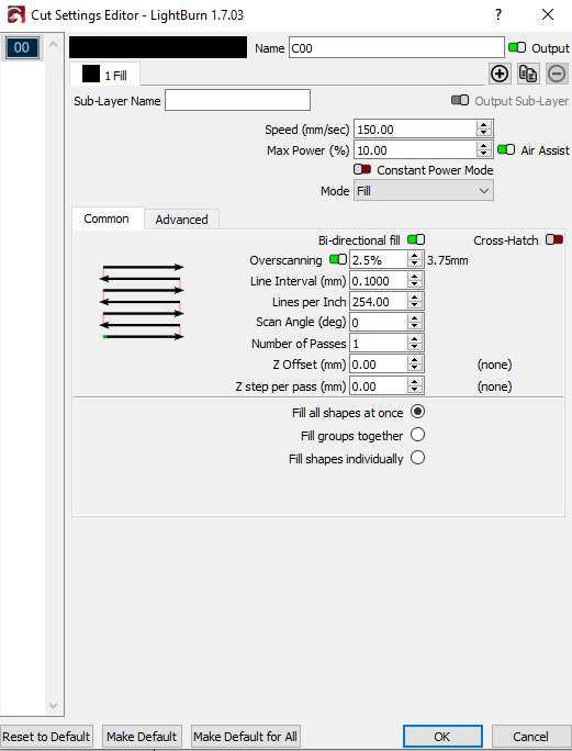

Can you provide settings where the issue is visible?
That can help who are able to guide you.

Thats my settings, but it occurs all the time. Is it possible, that Arduino is too slow to react and it creates problem?
I don’t meant those settings but they are useful too.
I mean Lightburn layer settings to those who can help can check speed, passes and other variables.

These are settings i used to engrave that numbers:
         10  /  150
           means
  % of power / speed mm/s
This is set for 10% power and 150 mm/s speed:

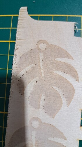

I,ve checked how it will engrave with only one-sided mode
and it looks like the laser is pre-firing or giving full power when it is enabled.
This is how it looks:
Maybe it is a problem with electronics and PWM signal isn’t stable?
ps. I’ve also tried engraving it perpendicular to the plywood knots, on the photo is parallel engraving.

I found an interesting relationship…
USB 2.0 port, ver 1.1h.
In the buffered mode, defects are separated by approximately 0.5 mm and most often appear in pairs, although there are also series of 0.5 mm intervals.
So we have 2 dots with a distance of 0.5 mm, then, for example, a distance of 1 mm or 0.8 mm or another distance and then again there is a pair, or very rarely a single dot.

It appears as if it’s sticking at full power for a short time. It’s rather unlikely that the controller is doing this, but it’s definitely a hardware failure of some kind.
I don’t know how you would set up a scope to even check this… what I mean is what would you trigger on?
I’d guess the laser module, rather than the control board… IMHO…
It would help if you could figure out if it’s the leading or training edge…
