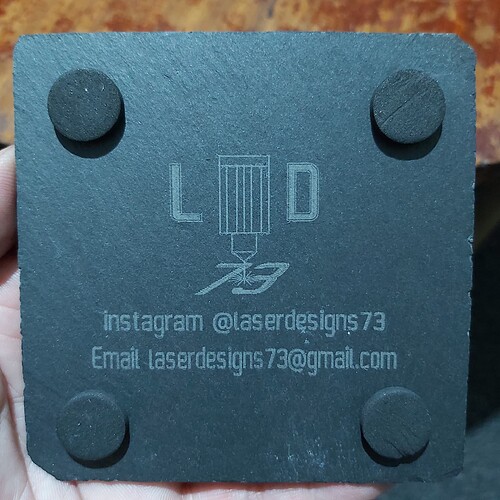

I’m having a strange issue with a logo I have designed. The logo file is working, and I have burned it before, but If I copy and paste it into another documents, I then do a preview, and I get an error about open shapes.
Clicked show me an it highlights the open lines.
Tried the all options under “Edit” to close path, or auto-join that I have seen where and also suggested on Google, but they do not seems to work
What I don’t understand is that if I do a preview of the file itself does not show any open lines…
This is really annoying, as I have a file with coaster position and I need to be able to but the logo on the back
I have Lightburn 1.3.01 on Linux Mint 21 Ortur 20w diode

The problem is that each node on a path can connect only two lines. The vertical lines on your design are separate lines, with a node at each end, and cannot connect to the horizontal sides of the rectangles and lines at their ends.
You can mark those lines as vectors, but you cannot engrave them as filled shapes.
If you redesign the logo using thin rectangles, rather than lines, it should work better for engraving.
So these can’t be joined to make it like the one on the right. I had someone ask this question and the only way I could do it was to make two separate pieces and group them.
Correct: a T intersection at a node isn’t possible.
You can abut two closed shapes, so it looks like they share a common side, but that “line” is actually two overlaid sides from two separate shapes. The optimization setting Remove Overlapping Lines should take care of cutting only once along that path.

SOLVED (kind of)
Thanks for the replies. I realised what the problem is, kind of…
As I mentioned, I am still a beginner, so this was a stupid mistake.
The original file the blue layer is actually set as line, so it burns OK. If I switch to fill I do get the same error.
When I copy/paste in the other project with the coaster template, I had another design outside the table that I burned previously, so it picked up the blue fill layer from the other design… :man_facepalming:
I did a bit of tweaking on the design before I even realised it.
Actually do like the line finish more than the fill, so I will leave it as it is for now
