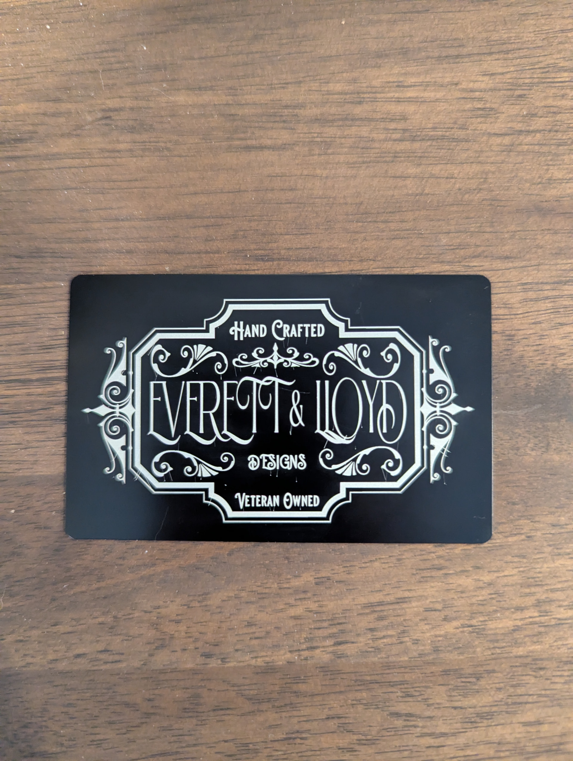

Good morning - I’m hoping for some help with an issue that has me at my wits end.
I’m getting fine lines that generally run vertically from the bottom edge of many of the elements in the project:
I’m working with a ComMarker B6 30w Fiber laser, Windows 11 desktop PC and LightBurn Pro 2.0.05.
For troubleshooting purposes, I have tried:
A. Two different USB B to USB C cables (one with ferrite choke).
B. Using a Dell XPS 13 laptop in place of my desktop PC.
C. Adjusting Jump Speed from 4000 to 500.
D. Adjusting Open MO Delay from 8.000 to 0.
E. Looking for open shapes that need to be closed (for the job file in the attached photo, it was imported as a .jpeg and traced in LightBurn; there were no open shapes detected when using “select open shapes set to fill”).
F. I tried opening the console window but nothing appears and I have no ability to enter any commands.
I have a few year’s experience with CO2 gantry type lasers but am very new to fiber lasers; these are all ideas that I’ve gleaned from this forum and Google searches and at this point I’ve run out of ideas.
Any help is greatly appreciated.
