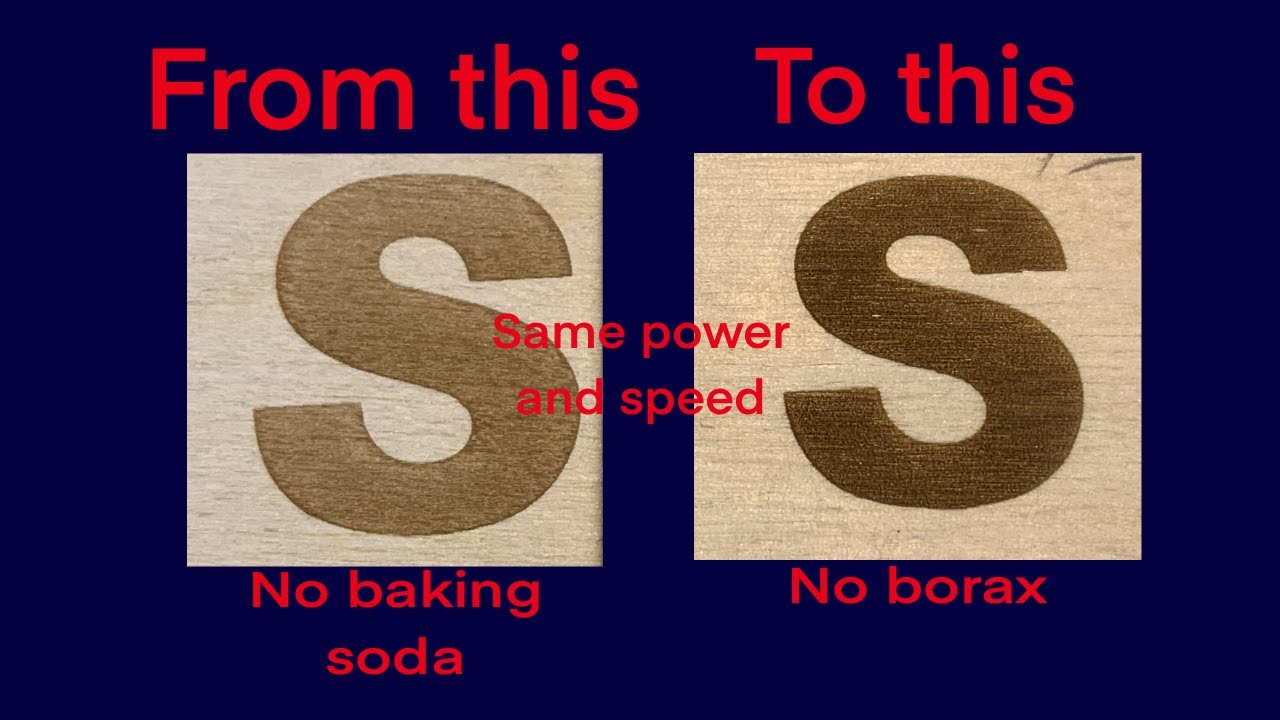

A solution of water and Borax sprayed on and dried will make the wood much easier to engrave at a lower power/ higher speed.

For lack of better descriptor, the focused area looks like it was drawn with a mechanical pencil and the de-focused area looks like it was written with a sharpie pen. Same settings, different out comes.
The same area with the factory prescribed focus.
There are times when one grabs a pen to write a small greeting card and a sharpie for a larger greeting card. Think of it as a “bold” option for all your fonts ![]()
